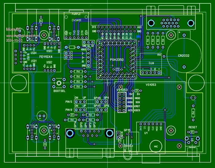

Why let a PGA2350, a VS1053, a compact VGA connector and an upside-down micro SD module sit in a drawer doing nothing? Here's what is probably the last version of the PicoGAME VGA.
RP2350 to give it some oompph.
VS1053 for some MIDI.
Port A fully implemented for everything that the previous PicoGAME boards did (I had to use different GPIO numbers for the analogue pins).
16/17 GPIO pins on the back, including 7 ADC pins. The AUX pin can be GP30 or 5V.
Port A pins 1/2 and 3/4 both have COM1 available so you can have I2C on 1/2 and COM1 on 3/4 simultaneously.
Port A pins 3/4 also have I2C2 (System I2C) available.
4-port USB hub replaces the PS2 socket.
USB-C for console & 5V in.
Heartbeat LED on the board.
Programmable LED on the front panel because they are pretty and fun to play with.
No surface mount soldering.
Uses a mini RTC but there is space for a CR2032 battery so you can re-use one that's gone dead.
Uses the cheap case like a mini CMM2.
Sorry, Port B had to go!
You program it by temporarily disconnecting 2 links and plugging in an ordinary USB-C or micro-USB breakout board. That will also power the PSG2350 while programming, but will not back feed into anything else.
This is unfinished work at the moment. I'll complete it if people are interested. It looks like it'll work, but the components need sorting out.
I've used every pin on the PGA2350 so if you want anything else something will have to go. :)

Er...
I've fixed the fact that you can't plug that VS1053 module in that way. :)

Hi Mick,
What would it cost to build this. I assume you have some sort of BOM that you can quickly draw up, with cost of the modules (hub/connectors,VS1053,SD module).
By the way there is no dcoupling at the 3.3V pin of the SD card slot. Is that capacitor on the module itself ?
I don't even have a PGA2350 so I will have to factor that in myself.
Edited 2024-10-03 18:57 by Volhout
Posts: 7415
Posted: 09:38am 03 Oct 2024
I've not sorted out a BOM yet so I've not much idea of cost. All the bits are available on AE (that's where I got them originally). The VS1953 is the most expensive at around £5 +VAT. The hub is about £2 and the micro SD card module about 50p. The USB connectors usually come in bags of 5 or 10 for £2 or so. The VGA socket is about £1.20 for 5.
The D connector is the most awkward. Different makes vary enough to make them non-interchangeable so I have a RS part number for that. You can compare its drawing with whatever you can find.
The PGA2350 is easily the most expensive bit.
The enclosure (if you want one) is a cheap Hammond RM2015S. Easier to get and cheaper than the CMM2 version. Same one as Peter has used for his reference design.
The decoupling caps are on the micro SD module, along with some pullups on the data lines. I've used these a few times now and never even bothered with the series resistor. They have been fine. I could add space for extra decoupling, I suppose.

Hi Mick,
I have ordered Peters design (through Plasma) as an HDMI platform with USB.
But this design could be a good alternative for VGA with USB. And it has the PSRAM. I know Peter wants to avoid PSRAM, but for VGA (where 252/325MHz is fine) the PGA could be a good solution. And the slow PSRAM only exhibits when you use too much main RAM. This is fully under the programmers control.
Things I would "change" (not saying I won't build it as is, but things I find desirable).
- a better programming header (I think I will have to re-program the firmware 100 time or more, given last years track record). Maybe a (vertical) USB connector, or something that is keyed, so it can't go wrong.
- a fullsize SD card slot with push-push. I play with the PicoGameVGA (where I have the same module you use assembled) and simply have trouble (eyes...?) putting the card in, and somtimes you do 10 times in an evening. I know it is a cheap module, but I like the full size more for convenience. And that can very well be on a module if one can be found on Ali.
Thats all...

Posted: 10:57am 03 Oct 2024
I've considered a vertical USB header but I think they are all SMD. I'll have a look at the possibilities.
I have a little micro USB breakout and the pins are all in a row at one end. It would be difficult to plug it in wrong way round as it is the same height as the Pico and projects out over the USB isolating links and the hub module.
To get a full size SD card slot in I have to lose a USB from the front. Everything gets pushed along. :(  Either that or you have to cut the LH front PCB support pillar out of the case and fit another somewhere else near that corner. The full size SD card LH pad is up against the LH front support for the VS1053 and the back RH corner of the card socket is up against the VS1053 header! I can't fit anything else underneath.
I've squeezed in a LM1117T and a ESP8266-01S. It is on COM1 using GP45 and GP46 if they aren't being used for analogue or by additional Port inputs.

I think I've managed it - but lost the front panel LED. :( There's now a USB at both ends of the front panel - nice for two controllers. :)

I've compromised with a 3-pin connector so that a 5mm WS2812 can be fitted into the front panel using a clip, above the Reset button. I think that's it now.
There is a USB-C socket on a breakout board on AE. It has the pin sequence V, D-, D+,G so it will drop straight in. I've added a solder blob so that the ID pin can be suitably grounded. 75p +vat for a pair. You could simply solder it in place. Soldering a vertical micro USB socket looks tricky as the pins are very close together. Note that you will probably still need to isolate the data pins to the hub. However, this arrangement lets you simply unplug the USB-C from the back and plug it into the vertical connector to install MMBasic. The hub supply is removed, together with supplies to most of the rest of the board.

Now officially named the PicoGAME SPGA.
Several changes have taken place:
the AUX pin on the GPIO port now has an internal link and can be connected to GP30, +5 or 3V3.
3V3 to the GPIO port is now from a linear regulator, not the Pico which uses its switcher. The reg also powers the ESP8266-01S and the front panel LED connector.
Three different options for the SD card. Two different full size sockets or the "inverted" micro SD module that doesn't require SMD soldering.
The RTC battery can now be either CR1220 or CP2032.
A SMD LM4040-3V can optionally be fitted. There is a link to disconnect it.
I've almost finished designing front & rear PCB panels for the box.
The circuit diagram is almost finished and I'm on with the manual.
Now I have a conundrum.
Which to fit? ESP8266-01S or HC-05? I rather fancy the idea of the latter because no-one has done it yet AFAIK but it might be of less use than a router connection. Unfortunately there isn't enough PCB area to fit both.
