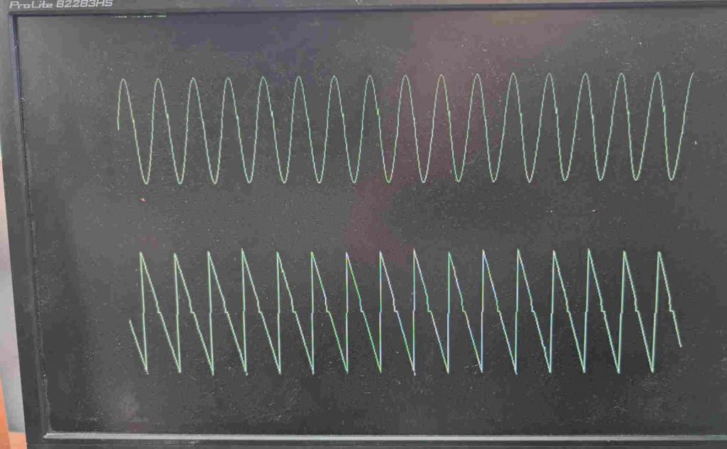

Coming in RC10 I've unlocked the ADC speed and it can now sample up to CPU speed/96
So in the example below on a RP2040 I'm running the CPU at 378MHz and sampling two channels each at 1.96775 MHz to give a total sample rate of over 3.9MHz
https://youtu.be/7w7MKo9nofo
CLS
FRAMEBUFFER create
FRAMEBUFFER write f
Dim float a(1279),b(1279),aa(639),bb(639),c(639),d(639),e(639)
ADC open 1968750,2,done
For i=0 To 639:e(i)=i:Next
ADC start a(),b()
Loop Until f%=1
f%=0
p%=Math(crossing a(),1.5,-1)
Memory copy float Peek(varaddr a(p%)),Peek(varaddr aa(0)),640
Memory copy float Peek(varaddr b(p%)),Peek(varaddr bb(0)),640
Math scale aa(),50,aa()
Math scale bb(),50,bb()
Math add aa(),50,aa()
Math add bb(),250,bb()
Line graph e(),c(),0
Line graph e(),d(),0
Line graph e(),aa(),RGB(green)
Line graph e(),bb(),RGB(cyan)
FRAMEBUFFER copy f,n
Math scale aa(),1,c()
Math scale bb(),1,d()
Sub done
f%=1
End Sub
