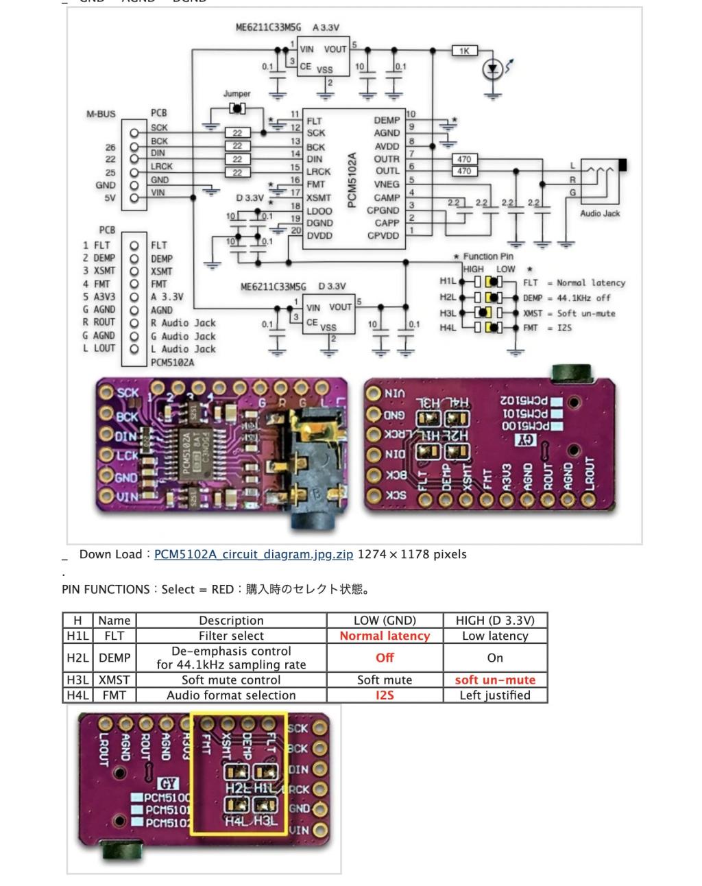

  matherp said
  Quote  Is it possible to implement in V6.00.02 sound on I2S DAC?
PCM5102 TDA1387
I have looked at this but to work properly it relies on the processor running at specific speeds to allow the 44100*64*8 master clock rate for the PIO. These speeds are incompatible with VGA and HDMI.
Given that VS1053 is fully supported I don't intend to pursue this further
And at what sampling frequency is the data updated for sound on PWM or for SPI DAC?
For the I2S bus, it is not at all necessary to adhere to the exact flow frequency; it is possible to transmit data packets at a higher clock frequency with the required sampling period.
