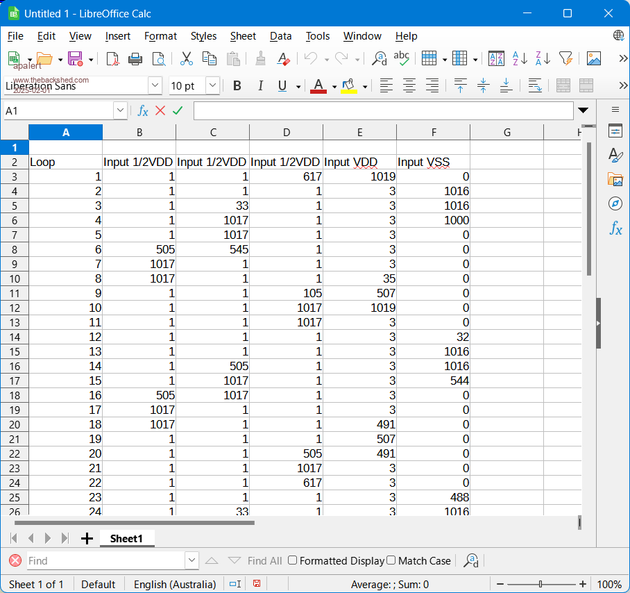

Many thanks for all suggestions, new version of code below. Hours have been spent tweaking. New ADC chip tried, wiring triple checked. Unfortunately output is still garbage :( Below the code is a table of data returned. I put the code in a For x= 1 to 40 loop and ran it multiple times with 1/2VDD, VDD and VSS test voltage inputs. There is a curious pattern to the garbage! SETPIN 27, DOUT ' pin 27 ADC chip enable active low PIN(27) = 1 ' ADC chip disabled SETPIN 11, 20, 19, SPI2 ' assign SPI I/O pins, RX, TX, CLK pause 20 SPI2 OPEN 100000, 0, 10 ' speed 1MHz, SPI mode 0, 10 bits data PIN(27) = 0 ' ADC chip enabled data1 = spi2(104) ' get data from ADC pin(27)=1 ' ADC chip disabled SPI2 CLOSE ' close the channel ![]() 2025-02-01.png.pdf Edited 2025-02-01 17:11 by apalert |

P.S.: I think in `SPI2 OPEN 100000, 0, 10` the 10 bits is the problem. The bit width refers to whether you read/write bytes (I read/write bytes) or 16 bit words to communicate with the SPI device - it is not related to the bit depth of your ADC. |

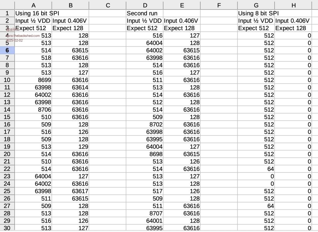

apalert Newbie ![]() Joined: 06/07/2023 Location: AustraliaPosts: 36 |
Now tested :) First time I have seen a result using 16 bit SPI. Playing with pauses all through the code varied correct data from 9/20 readings to 15/20. When I say correct, they are a tad off, expected 512 actually ranges from 508 to 515. 8 bit initially gave about 2/20 matching expected result. Playing with pauses lifted that to 18/20. And the good results were perfect 512! Second channel not working with the 8 bit though. The way there is a run of good results then bad has me baffled. It's not related to run time. Yes, I did have to cycle CS pin between reading the channels. Many thanks ![]() |

I forgot to mask off the higher bits in the 16bit code data0 = data0 AND &h3FF etcdoing that will get rid of the obviously wrong readings. In the 8 bit version I should have masked of bits for each SPI read before adding them together. For some reason the second call to SPI2() is returning zero This is why the v/2 readings are too constant at 512 and also why the 0.4V reading is 0 instead of ~128 @Pluto the MCP3004 is very similar but has a couple more configuration bits so needs 17 cycles or 3 bytes. Edited 2025-02-03 13:18 by TassyJim |

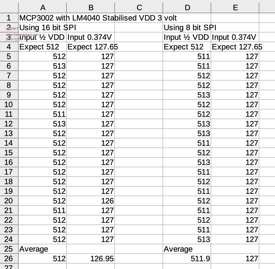

Jim, did as you suggested and you have nailed it! Results are amazing. Initially results were +/- 3. However I stabilised VDD on the VDC at 3 volts with an LM4040 and forced Pico into PWM mode while reading, now we get +/- 1 as per spec sheet. Was able to remove all pauses and bring clock back up to 1000000. Time to take 20 readings around 7.5m/s when not printing result of each loop. Hard to say which is better, 8 bit SPI or 16. Accuracy seems the same. 16 bit is a tiny bit faster. Thanks so much for your input. ![]() |
