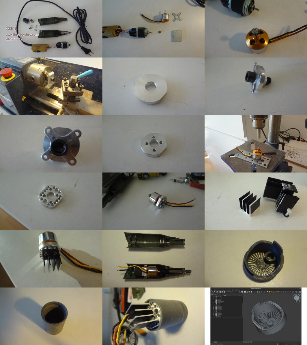

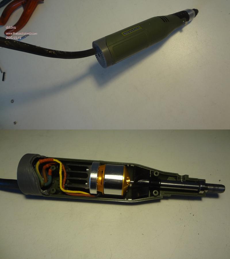

My Proxxon and me have something in common, we both are broke..
I took a Chinese 2700 Kv outrunner used for drones and a BDLC controller I bought a year ago. I always wanted to check out these kind of motors, now it is time to ;)
I took a piece of aluminum and an old heat sink.
And I designed roughly a lid.
Here is the story how to pimp a Proxxon to 32.000RpM :))
I will test it..might get to hot but the original 20.000RpM it will surely do:
