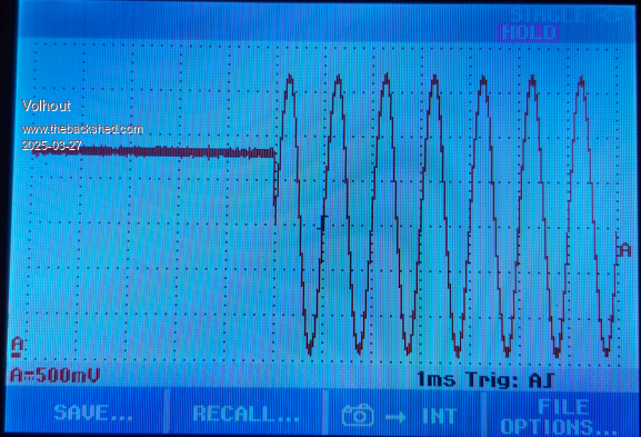

@Peter, Homa,
On my 2040 VGA (PWM audio) design, when I power it on, there is 2.3Vdc at the output.
Since the PWM audio should be centrered around 50% (of 3.3V) equals 1.65V, the 2.3V  causes a jump at the start of each sound played. I see the same at the end of each tone.
I have a scope picture that shows it. This is from PLAY TONE 1000,1000,50
Also at the end of the tone, this offset of 2.3V is restored...after 1.2 milisecond.
I think the initial value of the Timer Compare Register should be half the value of the Timer Wrap Register. Also with every sample frequency change this default value should be set.
P.S. this is RC7_2
Edited 2025-03-27 05:18 by Volhout

Posts: 10251
Posted: 07:53pm 26 Mar 2025
If you look at the actual PWM output you will see on power on it is exactly 50:50.
You will also see that if you PLAY TONE 400,400 and then ctrl-C it returns to 50:50.
Please also confirm "play tone 400,400" and then "play stop" leaves the output at 50:50
On my system play tone 400,400,n leaves the PWM signal lower than 50% (about 41%). I'll try and find why this is the case but it certainly doesn't give an output that could yield 2.3V

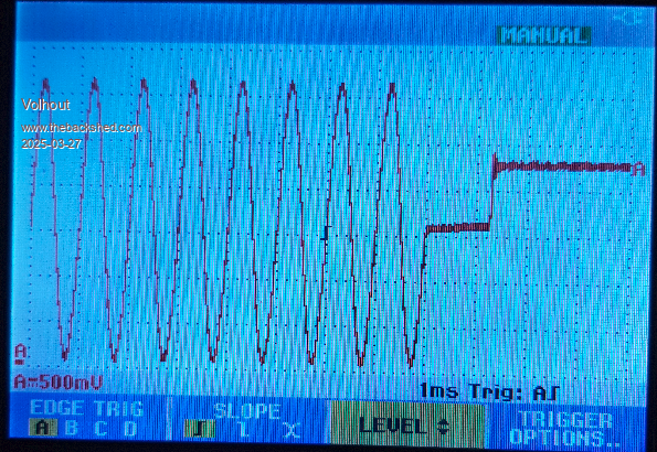

Posts: 5066
Posted: 07:10am 27 Mar 2025
Hi Peter,
When I PLAY TONE 400,400 and stop it with PLAY STOP, I get nice 50:50. Confirmed.
Observations:
When I PLAY WAV "xx" and the tune ends, I am at 50:50. Confirmed. Play stop always returns to 50:50.
When I PLAY TONE x,x,y and the tone ends after y ms, it ends at 2.3V (69% PWM). tested several frequencies, all end at the same level. Several different times. Always the same 2.3V. So there is no relation between frequency and time for the level 2.3V.
When I PLAY WAV, then PLAY PAUSE, I get 2.3V. The same 2.3V. Even if I started with a power cycled unit that has 50:50 at start of the play wav.
This is VGA design 2 RP2040.
Another observation: after power on (without anything playing) the initial value is 50mV lower than the 1.65V (1.60V), as if the default PWM is set to 48.5%. This is a minute difference, and may even have a different cause. (i.e. changing drive strength of the IO pins) So ignore this for now, but it may give a lead into the other issue.
So in summary: when PLAY TONE ends by the set time, and with PLAY PAUSE this happens. PLAY STOP does not.
P.S. I have never seen your 41%. It is always 69%. Maybe it is taken from some not-initialized memory location ?

Posts: 5066
Posted: 08:02am 27 Mar 2025
@Peter,
I also confirm this is not caused by a change in sample frequency. In all cases (even during PLAY PAUSE the sample rate is 44.1kHz. No change to 48kHz or 32/16kHz.
Really solid 69.7% duty cycle at 44.1kHz .
idea:
The PWM at 44.1kHz is around 11 bits actual. Could it be that you write the mid position of the 12bit DAC MCP4822 to the PWM ? That would boil down to this roughly 70%.

  Quote  Another observation: after power on (without anything playing) the initial value is 50mV lower than the 1.65V (1.60V), as if the default PWM is set to 48.5%. This is a minute difference, and may even have a different cause. (i.e. changing drive strength of the IO pins) So ignore this for now, but it may give a lead into the other issue.
This bit is deliberate. The audio code centers on 2000/4096 and allows swings between 0 and 4000
  Quote  When I PLAY TONE x,x,y and the tone ends after y ms, it ends at 2.3V (69% PWM). tested several frequencies, all end at the same level. Several different times. Always the same 2.3V. So there is no relation between frequency and time for the level 2.3V.
Something obviously wrong. I've been testing on an RP2350B PicoMite so the 41% vs 69% may in some way be version dependent - will explore more.
Posts: 10251
Posted: 01:49pm 27 Mar 2025
This VGA version should fix the voltage offset. In addition, I've changed the behavior of play pause/resume so that pause leave the voltage at the instantaneous level at the time of the command and resume starts from that level. Should also support pause on MOD playback.
