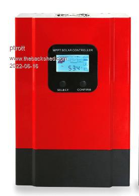

eSmart3 (40A), also sold as Vevor & Ipanda.
Looking for someone who knows how to set the user defined parameters on this charger for charging LiFePO4 batteries please.
The terminology used in the settings is I think for lead acid, so there are things I don't know what to set to to make them inoperable when charging LiFePo4.
The following are the parameters as listed in the menu, and the figures I think might be right:
The parameters that I can set are as follows:
Constant Voltage:   (14.2)
Float Voltage:          (12.6)
Boost Voltage:         (14.6)
Boost Charge Time: (6 min)
Bat. O/voltage:         (14.7)
Bat. O/voltage recovery: (14.2?)
Bat. U/voltage:         (12.5)
Bat. U/voltage recovery: (12.5?)
Max. discharge current: 100A
Maximum charge current: 40A
The battery is 12V, 135AH, 100A max in & out.
