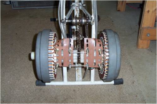

I was looking around for a small diy wind generator to run some leds around my house for the kids at night, when I stumbled in here
Now I want to build a fnp vawt and run some garden lighting and maybe a light pump as well(12v)
I have gathered some stators and blown the dust off the old arc welder
My first attempt was a dual stator exercise bike, unmoded stators wired in low zig zag config for single phase mains
The stators have been filed but it has a huge start torque brake until I get the revs up(11 to 1 hub to pedal ratio). It will light several globes and I have plugged in a old neon sign transformer to generate a arc for the kids amusment
I have to go back to it as I may have mucked up a winding polarity somewhere, huge resistance on start( loaded or not)

Sounds like you may have wired that dual stator wrong, the F&P's are a 3 phase machine and there isn't any way to connect all 3 phases together to make 1 phase. But you can take 1 phase from any two outputs, but this means your only using 1/3 of the available output. ZigZaging the connections wont work.

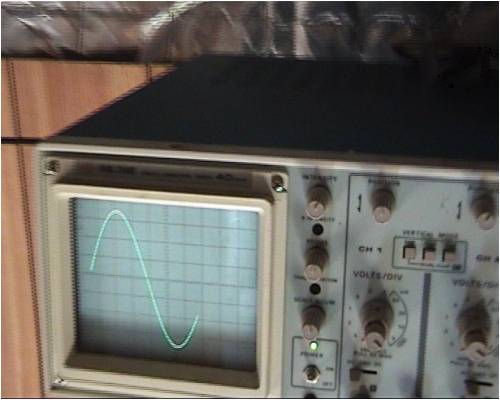

My cro sprang to life the other day so here is what I'm getting with the pedal power and 2 unmod F&Ps wired zigzag, on the same shaft facing each other
350v p-p into a 75w globe

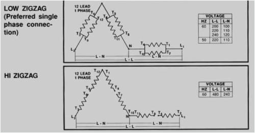

I'm a bit of a self taught hack and haven't heard of the dual zig-zag arrangement and can't fathom what it might be. Is it possible to sketch the circuit and post it so I can stop scratching my head? Ta.
A shot of the bike would be nice too?

Here is the bike, apart from the u bolts all from the tip. I chucked it together quickly to see if it would work.
Not a great shot,and it's changed slightly, but you can get the idea
It has the hubs wound out to make it a bit easier for my youngest, but they both wind in fully
No good for my vawt as the turbine size would get out of hand
I saw this posted by someone, somewhere.
I believe it's off a 3 phase motor I have used the low zigzag config
