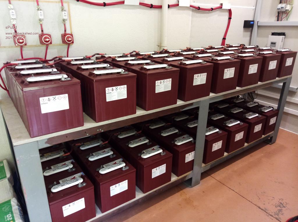

sPuDd
Joined: 10/07/2007
Posts: 251
Posted: 10:44pm 23 Apr 2021
Glenn,
  I use the Trojan 105 series 6V 225ah wet lead acids (1800ah total). I did all the calculations for cost per ah and life cycle and they always came out on top by a long way. And lithium was moon shot priced for new, and a major fire hazard if using old cells, plus the BMS would cost more than a lead acid pack alone.
At the moment you can find the 105's locally for about $250ea. 8 of them would fit your budget. I water my set using a pump & dispenser about once every three months. Currently the bank only gets about 10% depth of discharge per night. My calculations show I have a 10-15 year life span at least. As others have said, they benefit from a good high current stir up, which a gel or agm bank would not handle from what will be 30kw of solar once I'm all done.
It should work ...in theory
Posted: 04:05am 24 Apr 2021
Thats an impressive battery bank Spudd.
