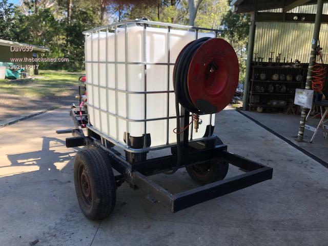

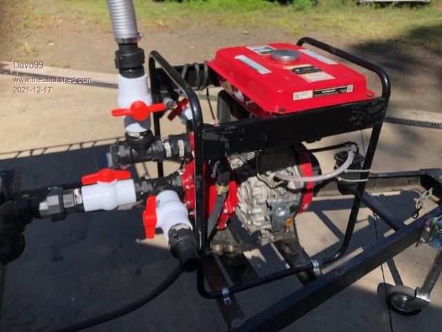

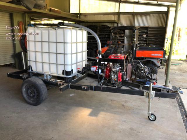

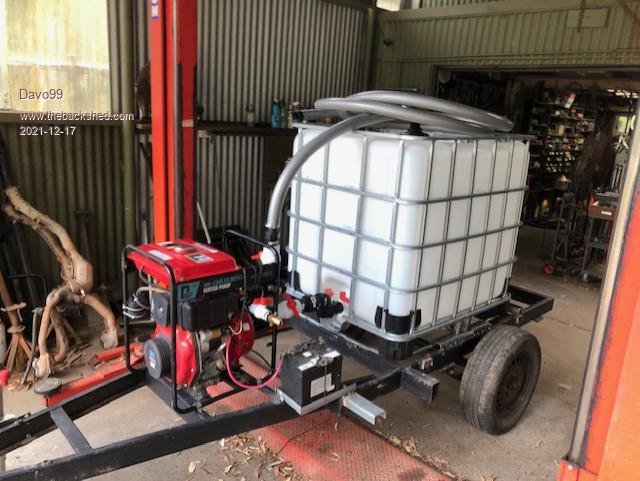

While I was up there I knocked Dad up a fire trailer that I have been telling him to get one for years. Now at the wettest 12 Months in the area's living memory, he decided there was a rush to get one. All the commercial ones were pretty lame really. Petrol pump, one hose, most you couldn't even till the tank or pump from a river or dam.
I had the diesel and bought a petrol pump setup with the proper 2" twin impeller 130M head pump unit. Grafted that onto the diesel with an electric start I robbed from another engine. I have a petrol Pump and Had a diesel before selling it to a mate and the diesels crap all over the petrols. They are noisy as hell but Dad is deaf as a post and who cares about noise when you have a fire?
Found the frame which was an old camper/ caravan frame in town so got the towie to bring that back and I had taken the IBC and a bunch of fittings ( but of course not enough or the exact right ones and put it all together.
It can do anything, pump to the hose from the IBC or another water source, transfer from one tank to another or fill the IBC from another water source and FAST. saw a lot of commercial units with 3/4 fill hoses. Yeah, you want to be taking that extra 10 Min to fill during a fire don't you??
It's got a 36m, 3/4 hose and a 1" 20M hose with the proper pistil grip nozzle that's the real deal with all the bells and whistles. Wasn't there when I came back but arrived the day after of course so have to fit that up. everything on the pump is ready to go, case of screwing on the fitting.
Dad is bitching he doesn't like it. The reel for the hose on the back has flaked the paint and got rusty. I took the thing up to him about 5 years ago and it laid in the corner of the back shed till I fished it out. Always got to look pretty for Dad.
I doubt and certainly hope it never sees a real bushfire but it's as capable as I could make it. The main purpose will be for fire control when we are burning off or even more likely, when the neighbour burns off and goes inside and the fire gets away and is up the trees and burning in dads place as happened 9 times now and well beyond a joke. Neighbours fire fighting equipment is a rake and a garden sprayer.
Got a fair few trees I want to drop there and dads excuse has been getting rid of them. Lot of rubbish left once you take out the fire wood. Have had to get the RFS in before to supervise but now we can keep the piles manageable and have something to keep them under control.
Given how well the flail mower foes though sticks and branches, I think a lot will be able to be run over with that then just put the stick rake on the tractor and heap up anything that's left and burn that.
That little Diesel with that 1" Hose is going to lay down some good water. Shown the pics to a few people and they all say the water won't last. I said won't be much fire left time it's empty though. Be able to put out the neighbours fires from half way across the block before they get away again.
