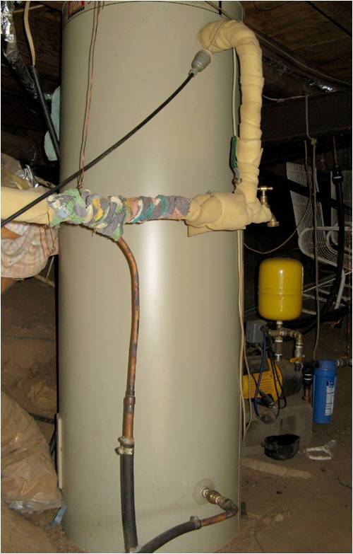

I've been meaning to put up some info on my hot water wood fired heating system for a while and this looks like a good juncture to do so:
Our hot water service tank is a large one: approx 300L and is located under the house, below the level of the floor that the slow combustion wood fire is situated on.

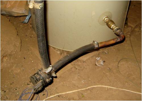

So a pump was the only option to move the water up to the fire and back down to the tank, in other words a thermosyphon would not work.
I've coiled up a single 6m length of annealed 1/2 inch copper pipe into a helix about 600mm high that fits inside the flue.
I've cut a small notch at the base of flue pipe where the pipes enter and exit
These pipes go through the floor and are connected directly to the hot water service by a small pump that takes water from the bottom of the tank and deposits it back into the top of the tank.
The pump is a 12v ultra reliable automotive grade unit:Davis Craig pump
It has a magnetic drive impeller (no shart seals to fail) and is rated for 120 deg water at a max preasure of 36PSI, in practice this rating is quite genereous as the pressure is less than 30PSI and the temperature from the bottom of the tank rarely gets above about 50deg.
The pump is operated by a simple thermostatic switch on the "in" pipe right next to the flue.
thermostatic switch
The thermostat switch is the normally open type and closes at a fixed temperature of 50 degrees, so in normal use the pump runs for about 10 seconds every minute.
As more cold water enters the pipe going into the flue the switch opens, after this cold water heats and triggers the switch the water exiting the flue has heated up nicely to about 75 degrees.
In this way the most of the water in the coil is at least partially warm so this stop the coil from sooting up the flue too much.
In anycase i havn't had any real issue with the flue sooting up although I have stuck a peice of wire up the flue once to dislodge the soot when the fire seemed to be getting abit smoky. (OF course anyone with a flued fire should be doing this anyway)
The pump has a 7.2Ah 12v backup battery to ensure that it doesn't ever lose power, and there is always water under 10PSI gravity pressure from the 22000L tank that feeds the house.
What would happen if the pump failed?? (like someone switched it off and forgot to turn it back on)
This has actually happened a couple of times over the last year, i've lit the fire and realized half an hour later that the pump wasn't running.
Well not much really...
The water in the coil turns to steam but there is less than 0.5L of water in the coil so this just displaces the water back into the hotwater service.
Because there is no non-return valve on the hot water service that is connected to the DAVEY pressure pump this extra pressure goes into the pressure bladder on top of the pump and is comfortably absorbed.
When i did switch on the circulating pump there were a few bubbling sound coming from the the hot water service as the steam was forced out of the coil, but this stopped after about 30 seconds or so.
I've set the off peak time-switch to heat only in the very early morning (4-6AM) so this ensures that we always have hot water for showers in the morning.
But allows the fire to heat the water all day and evening when the fire is burning.
Without fire going the hot water service uses anywhere between 6 and 12kWh a night to heat the tank up, but with the fire going this is reduced to about 3 or even 1kWh depending on how long the fire has been burning for
Works like dream, but only in winter (like my hydro rig) when we use the fire!!
I would like to get a evacuated tube solar hot water service and run the flue heating loop in parallel with the solar collector heating loop...

The only small issues i have had was the the rubber pipe that connects the pump to the copper pipe, which was really stupidity on my part
Firstly i grabed an old car heater hose that i *THOUGHT* would be OK
And i had this connected such that is was curved through 90 degrees to the bottom of the tank.
As the DAVEY pressure pump switches on and off this hose would move slightly as it expanded and contracted, i noted this with some interest and though nothing of it...
That is until i came home from work one day and it sprung a pin hole leak which was threatening to turn into a flood!!
Now the 90 degree turn is made of copper pipe and silver soldered, so the rubber pipe section is short and straight and is most importantly NEW.
Man i felt like such a dick for using that old $#!t-house hose.
Some times you've just gotta learn the hard way?!
That happened almost a year ago now, it's been hassel free since then.
