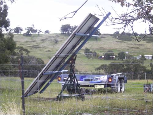

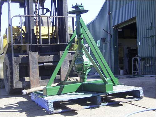

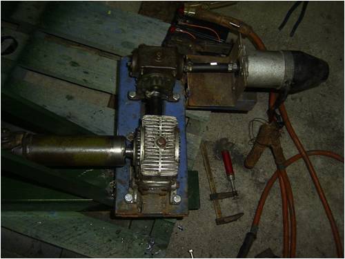

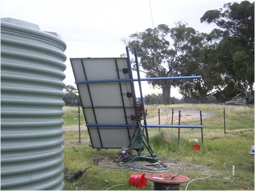

Hi Mac46, I to am a farmer born and breed. I was raised on sheep and cattle untill the vineyards came into the area. I have managed a 250ac (90HT) vineyard for 17 years now and still live and work the family farm. I think over time there has been alot of idea's come from farmers.
There is alot of info I have posted on the Picaxe Forum.
http://ozelecforum.com/
Here are a few photos of the set up..

Homegrow47
Joined: 17/08/2010
Posts: 31
Posted: 10:14am 31 May 2011
Excellent job.
Thats a great achievement.
Thanks for posting those pictures.
I have heard mention of using a car diff for a solar tracker, before.
But never seen pictures, and I always wondered exactly how it is done.
Thanks.
AMACK
Joined: 31/05/2009
Posts: 184
Posted: 11:17am 31 May 2011
Hi All, The car diff was not my first choice as I was doing to re-invent the wheel so to speak untill Pete told me about another system that he helped out a bit with that belonged to a mate of his that worked well.
There are a few things that could go wrong like the limit switches fail and it will not stop and will end bad. A pic forum member (Mobi) had a tracker run away and cost him $800 for a new panel. He pointed this out to me as it was something that I did not even think of. He is right as if it goes hay wire you need something as a back up system..
AMACK
