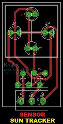

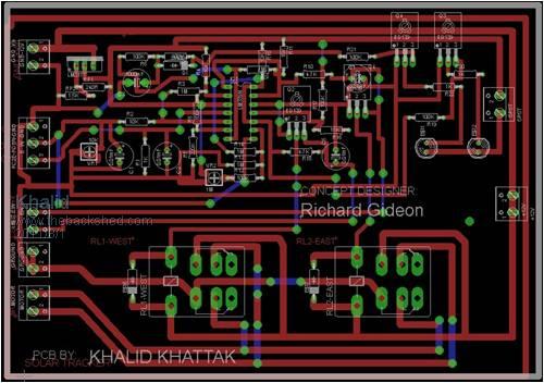

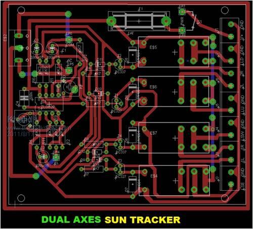

Hi,
I have recently purchased the 450 watt Monocrystaline solar panels. I was searching solar tracking circuits for many days and found different variety. At last after thorough study i found that Mr. Richard Gideon circuit for sun tracker is the best on the website(It is only my opinion).
Richard Gideon Solar Tracker
Anybody can read above article and can judge how this circuit works. The sad story is that i didn't find any PCB for this circuit so today i spent about 8 hours to build this one. Tomorrow i shall etch and mount the components.
its a Single sided PCB and the blue lines are the jumper wires :)Edited by Khalid 2011-08-02

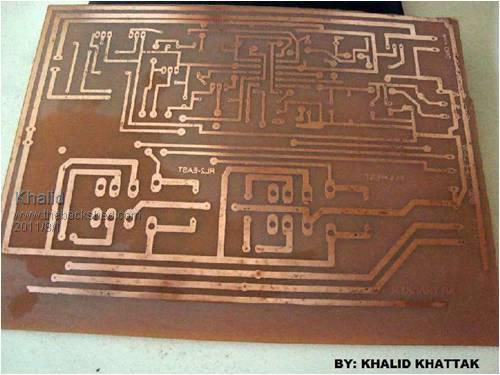

Posted: 05:15pm 31 Jul 2011

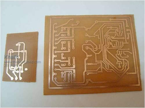

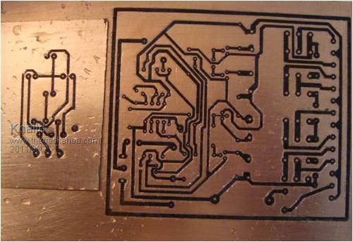

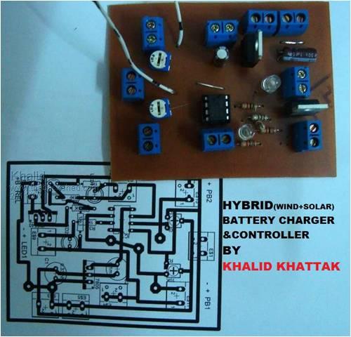

Here is the etched version. You can also see the Hybrid system
Battery charger and controller circuit.

Thanks for appreciations.. I have checked the circuit with two LDR's installed . Following are my observations, please consult Picture No.1 in my first post:
1- As per given conditions in sketch for Pot1 and POT2 the LED's can be set.
2- After setting, i found that The motor only rotate when the Right most LED(LED1) is in ON condition. When the LED 2 is On motor do not rotate. i.e. The motor rotate in only one direction. When i press Limit switch West side the motor stop.
3- The LED's react to the lighting environments.
4- Only one relay(the LEFT MOST)work the right relay do not work at all.

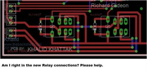

5- I checked closely the circuit and found that the right relay is connected wrong so i change the connections for RELAY-EAST as shown in attached picture.
6- After reversing the connection i connected to the power supply but still motor do not rotated in opposite direction:( When i adjusted Trimpot 10K a smoke came out of it.
I am not electronic guru but if some one point to me in the right directions. How the connection to be made to the DPDT relay. Please down load the picture 1 and in a Paint program help me drawing rough sketch.

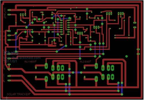

I am sharing eagle PCB file here, I didn't made schematic. I directly draw the PCB by manual tracing.
Kindly help me.

Hi Khalid.
I saw your solar tracker on the backshed.com.au
I no longer post there, but can answer some of your questions.
1.Yes the rewire on your relay should work. The original did not change the direction , but mimicked the first relay.
2. If you got the two leds to flash, as the setup conditions provide, you have it working.... mostly.
3. Looking at the circuit, the tracker does not actively track the sun, but instead uses a (probably better) system, where by, no matter what you do to the shading of the leds, it will only go further west until it hits the stop.... it will not go east while there is light available. Look carefully at how the op amps/comparators work.
The west motor relies on a balanced input on pins 4 and 5. If the east sensor sees more light it just drives the pin 4 high (-in), which drives pin 2 low.... stops west motor. As the sun moves west, the west sensor gets more light, this drives pin +5 in higher, this drives pin 2 higher, and the west motor moves until the sensors are equal or biased to the east of the light point.... and waits until the west sensor is stronger and repeats.
There is no provision for "hunting" ie trying to correct for being too far west.... it just waits until thesun moves further west, and the west sensor gets more light than the east, and so moves..... it does not track backwards as I see it.
When it can no longer track any further west, the limit stops the motor (shorts Q1 base)....... and it must wait until it gets dark..... ie no light..... why?
4. The voltage divider set by VR2 will hold the pin 9+ (in) at a preset voltage from VR2. This is compared to the voltage from the sensor west. As long as there is enough light to keep pin8 -(in) above pin 9 then the east motor stays off. Only when the light fades and pin 9 ends up having more volts than pin 8, will the east motor start to run. When pin 9 has more volts, pin 14 goes high, the led comes on, and a separate transistor drives the east relay simultaneously from the same drive signal off pin 14 (out)........ so if you got the east led to come on at some stage, then the relay should have as well....... also, some of the output is sent to another comparator (1d) to hold the west motor relay off while this is happening.. ie pin 10 (-in) goes high, so pulls pin 13 (out) down... which pulls pin 1 (out) down which shuts off Q1 while the east relay is running.
quote
2- After setting, i found that The motor only rotate when the Right most LED(LED1) is in ON condition. When the LED 2 is On motor do not rotate. i.e. The motor rotate in only one direction. When i press Limit switch West side the motor stop."
If you got the two leds to function, then the relays should have as well. The one wired wrong would go the same way as the west drive. If the relay did not respond at all, then check the transistor or the relay itself for open circuit on the solenoid. Use your meter to track where the voltage stops. Does it get to the input side of the 4k7 resistor driving the tranny (r18) (it should as the led 1 lights according to your reply) does it get to the base of the tranny? (Q2)..... is the limit switch shorting the input to the tranny.... it's there somewhere, as the led shows that the comparator is driving the leds tranny (Q3).
The west limit switch won't stop the east relay, as it only shorts the base of the west driver tranny. The east limit switch shorts the east driver tranny separately.
Does the east relay click?.
The reversing circuit (relays) are not well done, as if both are turned on, it will short the battery. It would be better wired differently, but it will certainly work as it is.
The smoke coming out of VR2 tells me you have the pot turned 120 degrees around. Is it is in the right orientation? It cannot short the 9v to ground, as the wiper only goes to a high impedance input. For it to smoke, you must have the wiper capable of putting ground to the +9v.... check your orientation of the wiper position against the circuit.. It should not have damaged anything else but the pot.
Feel free to reproduce this in whole or part in your response on the site, it may help some others who did not get it to work as they thought it would. I think most would think it should dither back and forth to track the exact position, but I don't see that in the circuit. It is ONE WAY while there is light (west only), which I think is probably better than trying to track the shadows of the clouds. It will only progress westwards, not run back and forth trying to find the sun on a cloudy day..... just gradually follow the sun westwards, or wait until a big enough difference between the east and west sensors give it enough potential difference to progress. East is only when the light no longer hits the west sensor at all (dark... not just shade.... VR2)

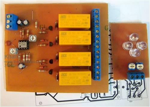

And here is my other dual axes sun tracker circuit by Hans.
