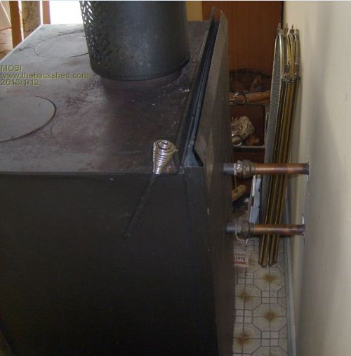

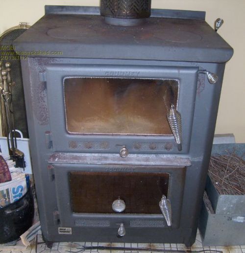

I thought I'd put up a couple of pictures of the wet back heater we have. As you can see, it has a generous cook top and an oven which is great for baked dinners and making cakes. A bit tricky for bread though.
The wet back system is open loop to the header tank in the ceiling through 1" copper pipe up the wall cavity.
No, it doesn't have a slope, Ilean.

I have had a look around at a few wetback units since we last chatted about this. It looks to me that they are deliberately designed to transfer a very small amount of the heat available from a heater, not like a boiler at all.
I find it hard to believe that there is not an off the shelf relief valve that would easily hold this system at a set low pressure, 10 PSI?.
I do notice that companies like solaradiant recommend fitting a heat dump to prevent "stagnation" with their large systems.
If it could be run at low pressure with an expansion tank and relief valve it would solve a lot of problems.

  Yahoo2 said  I find it hard to believe that there is not an off the shelf relief valve that would easily hold this system at a set low pressure, 10 PSI?.
When I built the farm house about 23 years ago, I had an old low pressure copper barrelled hot water system which had exactly what you are talking about. 23 yearsw isn't that long, so surely the LP valves it had are still around. They didn't look much different to the modern day ones. Perhaps one of the new ones can be adjusted??
