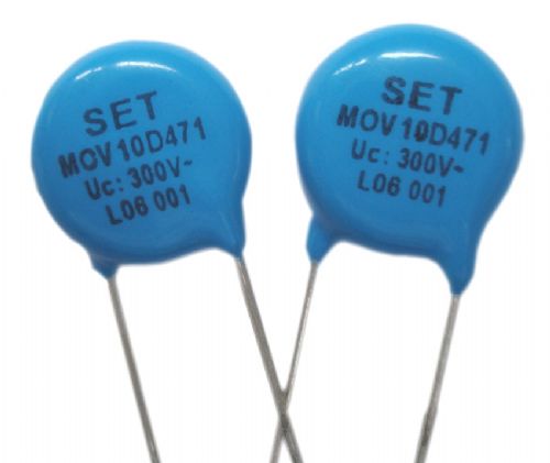

its basically a surge protection device to protect your gear from a voltage spike. Could be from induction in the wires from lightning, relay coils, electric motors starter motors etc, etc, etc.
I am a fan of the Metal Oxide Varistor (MOV) I call em lollypops.
The lightning arrestor will have a clump of these soldered to a circuit board, they are colour coded to the voltage that they start to clamp from. The bigger they are, the more grunt they handle.

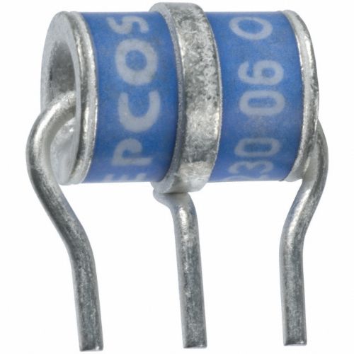

Glenn was referring to a gas discharge tube, over a certain voltage a gas is given off (ionised) that decreases the resistance running to an earth leg and sheds the excess energy until the voltage returns to normal. I think Glenn's were a two wire version, but you get the idea.
