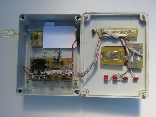

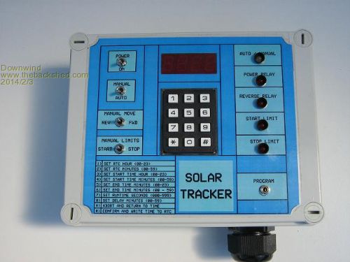

Here is a couple of photos of one i built for Amack, although i dont have the time to build you one.
Pete.

Have you ever used a picaxe chip, as that might help to understand your electronic skills.
Dont be shy, because a program can be written and emailed or posted on the forum, that you can just download to the chip.
BUT, its a matter of are you able to program a chip, or even understand how a picaxe can be used for this application, tell us more.
The basic requirement of parts is, a picaxe chip, i would suggest something like a 20m2, a RTC (real tine clock) like a DS1307, (lots on fleabay) a display, a LCD would be easier than a led 7 seg display like i used.
Keypad is optional, although it can make setup easier, but if you dont mind changing the program and reloading the chip, no keypad needed.
Pete.

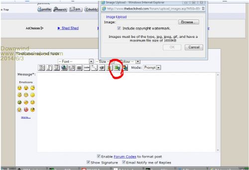

Posted: 02:32am 03 Jun 2014
Use the forum image upload button at the top of the reply window.
It will appear in your post reply as a text string and not a photo.
Example...............
(IMG]uploads/Downwind/2014-06-03_122504_forum_photos.JPG[/IM G)
use the "Preview Post" button at bottom of screen to view the photo prior to "post reply" to see what it looks like.
It will take some time for the photo file to upload to the forum so expect some delay while it uploads.

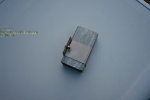

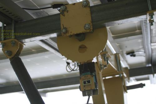

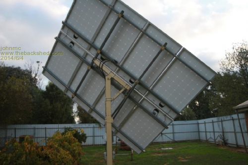

Posted: 02:16am 04 Jun 2014

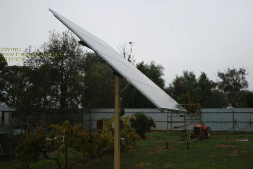

Good Day to all,
The following photos are of my 2kw tracking array with no sun light.
This photo shows the limit switch and part index wheel which allows a total
movement of 90 degrees in 15 degree steps. The RHS sections
have been bolted together which allow easy fitting of the solar panels
and no weld induced stress on the RHS sections.
All mounting plates and index wheel was plasma cut.
The main backbone of the array runs on sealed bearings to help reduce the load on
the linear actuator.
These stainless steel clips attached and stop galvanic action between the steel RHS section and the solar panel.
General view of panels when at maximum west facing position.

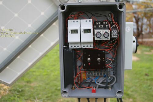

The control box of the tracking array which allow the array to move in 15 degree steps from east to west facing and also allow horizontal parking at night.
As the linear actuator was to fast for the one minute times I have had to run 0 t0 60 second timers in series with the minute times as it requires only about 10 seconds to
close the limit switch
Cheers john
