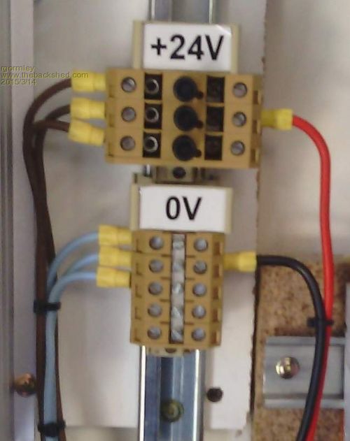

Quick question: sort of...
I have access to 4mm (56/0.30) twin olex versolex 0.6-1kv 90 deg flexible cable. twin brown+blue
The specs show it as having as a current capacity of 25 amps. Vdrop of 12Mv per A/m
The question: would it be acceptable to run two runs of this cable. to achieve current capacity of 50AMPS
(i only need in theory a max of around 40-45 amps.)
cable run length of 7~8 meters.
24v system.
I was thinking to have my 6 panels split into two cable runs and then combine on a 24V buss bar next to the Regulator.
So the basic questions:
A: Is it ok to have two runs of 4mm twin.
B: Should i run the cable paralleled at both ends or split the PV panels/cables into two runs and recombine on a local buss next to the regulator.

Yeah thats perfectly acceptable.
Only parallel them up at one end, or you can have problems with current loops. I would parallel them up at the local bus. This will let you isolate one group of panels if needed, at the bus.

just had a think about how i`m going to wire this.
total of 6 panels (3 strings of 2 panels in series)
hhhmmm only have 2 cables.... will have to get a third cable to bring the 3 strings down evenly, or i will have to double the current in one cable if i use the 2 cables
panels 1,2 going to cable one (two wires)
panels 3,4 + 5,6 going to cable two (two wires)
or i run a third cable
panels 3,4 going to cable two (two wires)
panels 5,6 going to cable three (two wires)
then combine downstairs to a 24 bus next to the regulator
*does this make sense?
rgormley
Joined: 22/02/2006
Posts: 245
Posted: 01:00am 13 Mar 2015
got home from work early, so did the PV cabling.
ended up running 3 separate runs of 4mm twin and combined next to the regulator.

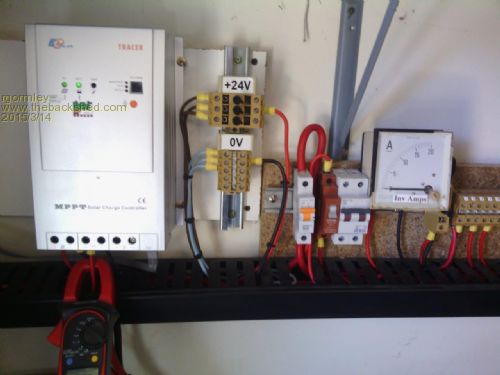

hhmmm.... panels in full sun, very small amount of high cloud 11:45am
from panels: 4.2 amps per string at 43 volts x 3 (12.6 amps at 43 volts=541.8 Watts)
into batts from MPPT: 22amp at 26 volts (22amps at 26 volts=572 watts)
watts in v`s watts out match, but was hoping for more as i have 6 x 180 watt PV
will get up and clean them.....

UPDATE: 12:45pm
cleaned the obviously impenetrable sun barrier from the panels (used diluted CT-18 truck wash)
now i`m seeing peaks of 33 Amps into the batts! .... much better
averaging 25 amps

Posted: 12:11am 14 Mar 2015
You might consider installing a 20A ampmeter in each cable run before the common bus, which would give you an idea how each panel pair is performing.
I have 5 separate 4mm sq cable runs, one from each of 5 pairs of panels. The panels are spread over the house & shed roof and those meters tell me at a glance if one lot is not up to scratch.

I can very easily add these (or via the "SAK-C10" terms disconnect any string and put a meter across the plugs via banana jacks.
when i was on the roof connecting the cables to the PV`s
i pulled each "MC" connector apart. they looked ok, but it did make me wonder if a soldered connection would provide a better connection.
there is not much current flowing on each series connection but hey, if i can reduce any bad connection/voltage drop point... all the better...
but i decided to leave them. as the "MC" connectors are world proven.... in many solar installs...
oh this afternoon whne the sun was full and bright and better angles
i hit some peaks of 38 amps (edge effect on some high cloud?)... and at the time was averaging 32 amps...
the tracer i thought was running a little hot so i put a computer fan on it.
the Tracer had the panels at 40~43 volts... is this ok???
