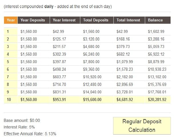

Posted: 08:51pm 29 Jan 2017
I like looking at things in dollars per week.
it is a very good comparison between spending and investment savings. Mainly because all those tiny amounts we spend each week add up quick.
Francesca's financially frugal family that drops their on grid costs of $46 per week down to $16 per week and invests the $30 a week for ten years at a compounding 5% in a managed fund.
over ten years we are looking at this.
twenty grand! really? I mean $30 a week is the sort of money we could spend on takeaway coffee.

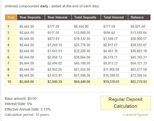

The average cheap family sedan probably costs $100-200 per week to own and operate.
So if we compare that to "norm's family" if we can get them down from $150 per week to $25 per week for electricity.
So, if we have a weekly cost or saving we could make, multiplying that amount by 670 will give the 10 years of compounding deposits @ 5% interest.
PS 40 years ago my parents paid $4.09 per week for using 20Kwh/day grid electricity.
