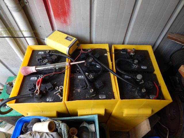

Hi All,
A mate of mine has an 8kV off-grid system, being in for around 2 years.
2 inverters, the red thing for the batteries (Charger?),
24 batteries & I think 44 panels.
I usually take a look at it on weekends we visit; checkout what the inverters say & look at the control display for the charger.
Often hear the batteries bubbling like crazy & see charge voltages au at the 63V mark.
Other value I notice, besides battery capacity is "SOH", referring to the batteries.
Usually sitting around 86%. Does that mean they've degraded almost 15% in barely 2 years?
Really doesn't sound normal to me, but for many reasons it's not something I buy into.
Thoughts?
Phil
Edit:-
The batteries look a bit like these (from memory).
Edited by Phil23 2017-03-19
