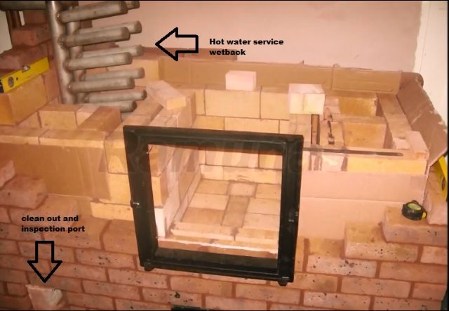

Seeing as Mulver wants to toss ideas around and Madness is thinking about wood heating I thought I would show an Idea I have trialed in preparation for fitting in my own house.
The concept comes from Russian masonry heaters, the problem they have in Russia is that if you go on holidays and there is no one home to light the fire, the hot water pipes in the wetback freeze and burst. To get around this problem they have a small resistive heater that slides into an inspection hole in the same chamber as the heat exchanger for the hot water service and they leave it running while they are away.
I was thinking to myself that might be handy for those days when we cant decide if it is cold enough to light the heater, we could run this element from a solar diverter and it would heat the mass, the house and hot water service all at the same time then switch to the HWS internal element in the afternoon if the water is not up to temp.
I pinched this photo from a YouTube video by Ramunas Lekstutis. Sorry I dont have a link, I have had the video for a long time. There is an oven above the firebox door shown that is also in the same bell chamber as the heat exchanger and the clean-out port that the heating element fits into, so it would be possible to cook at the same time.
These heaters use a bell system to trap the hot air in areas inside the heater and not let it escape up the chimney while at the same time bleeding away cold air to prevent any mixed dilution of the heat.
I have seen a Kusnetsov stove in action, in Australia one firing a day would be plenty of heat, they are just off the chain for efficiency and output.
Anyway I just wanted to share what I thought was a novel twist rather than the standard badly engineered and poorly placed wetback that I normally see. One that sucks the heat directly out of the fire and makes it smoke and burn poorly.

Interesting concept, I am going to be building with rammed earth and a significant benefit is the thermal mass which this stove you have shown uses to a lesser degree also.
I was not aware that a wet back was such a bad thing, I will be using a Everhot Combustion Stove initially that already has a wetback.
It depends exactly where the wetback is.
Wood fires are a two stage process the primary stage is decomposing the wood this needs to be high temperature so heat is best reflected back into the burn chamber with firebrick, the secondary burn is injecting heated air and completely burning the gas, this can happen at a lower temperature so it is the place to fit a heat exchanger.
