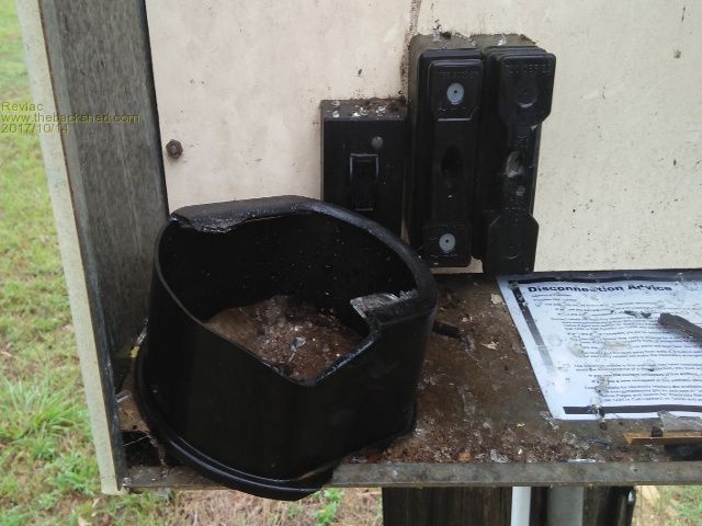

OK had a bit of a storm come through Today (DISASTER STRIKES FROM ABOVE ) just happen to have some lightning in it.

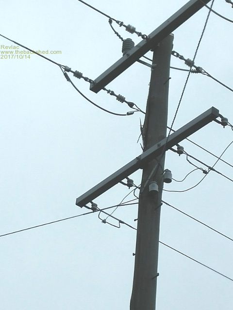

The lightning struck the power pole and blew the fuse holder off the power line, also blew 1 phase out of the transformer down the road.
(some time ago for safety reasons We had Energex pull the fuses from the power line across the road).
Poll is a bit splintered

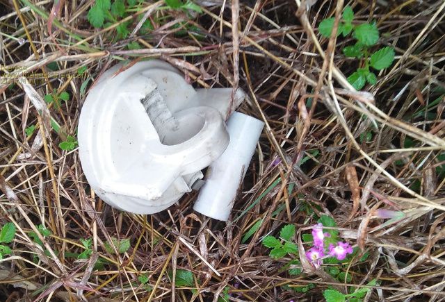

Busted fuse holder

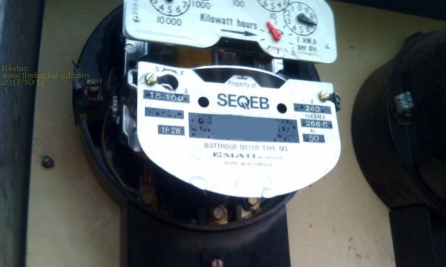

So much power it Blew the sh*t out of the power meter
More pieces

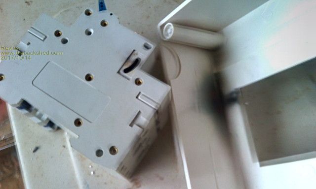

63A circuit breaker with flash over
Tripped all RCB and some of the MCB's

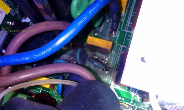

Then ultimately Blew the CRAP out of the OGI PIP Inverter,
NOTICE. All fuse's on the power pole the meter box were removed
, The main switch in the meter box was off as was the main switch at the house and the grid and genny change over switch.
The MOV's took some of the strike
Now running the house off the backup inverter

It was one hell of a bang, the buttons on the front of the inverter flew out I thought all the fets would be cratered, but no however I'm sure some are shorted, some other parts are shorted and its beyond repair.
As it turns out all the power from the strike came through the neutral wire after jumping from the active at the meter, it went to ground in many places and I could see the Earth Rods took some of the power but the ground was just to dry.

There is a lessen in this for us with off grid inverters, perhaps some MOV's fitted to the L N in a small enclosure (with a decent earth wire to ground) between inverter output breaker and the main box with RCB and MCB's. Just thinking about it, cant see anything stopping a big hit.
