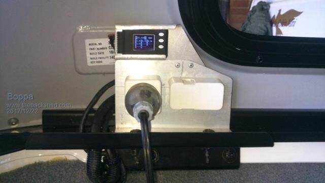

I cant remember the brand (the ute is in NSW) but Trev supplied a monitor system to go with the batts, took up to 8 cells, has relay output fully programmable for undervolts, overvolts, single cell difference, all sorts of fun things
(mounted above the 12v socket for fridge)
