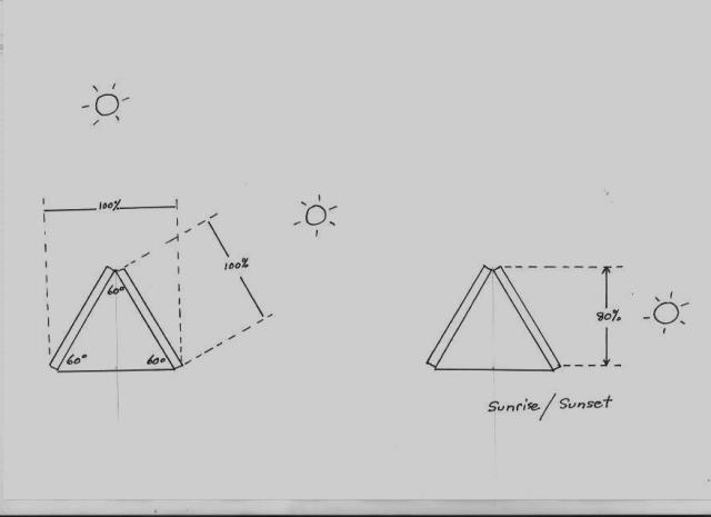

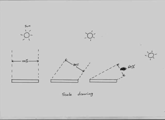

Posted: 02:11am 27 Jan 2018
I think you will find that orientation is not as critical as you might be thinking.
It depends only on how much panel area the sun can actually "see" (in direct full sunlight).
As the sun angle varies, there is a change in perspective. Directly in front the sun sees the full physical area. Completely side on the sun sees nothing, just the non functioning edge of the panel.
The sun angle needs to shift quite a lot before output falls significantly.
Any shading is pretty lethal of course, and at sunrise and sunset you are not likely to see the real horizon unless you are looking out over the ocean.
In full cloud, sunlight defuses into a dull even grey, where its not really possible to see where the sun actually is. fairly typical in mid winter, in which case you can face the panels in just about any direction, including due south. Facing straight up probably being very slightly better in that situation.
I think it was George that asked why I had my east/west facing virtual tracker panels mounted at the very steep angle of sixty degrees.
This is why.
You can get an almost constant output all day long sunrise to sunset.
Edited by Warpspeed 2018-01-28
