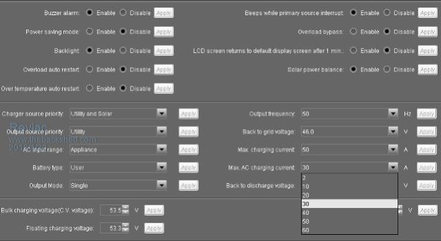

Revlac
Joined: 31/12/2016
Posts: 1310
Posted: 10:11pm 29 Jan 2018
Input Would may be called "Maximum Ac Charge Current" or something different.
However The one I use is pass-through mode and and will use use all the AC to power the hose (total load) and charge the battery at the same time.
If its overloads the generator it will reject it and go to battery, then after a short time it will reconnect to the generator
Yours will be a little different.

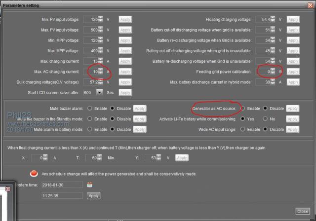

Phil23
Joined: 27/03/2016
Posts: 1667
Posted: 12:32am 30 Jan 2018
My Parameters page is a bit different.
It's in Off-Grid (II) Mode
AC charge setting doesn't seem to limit what it can pull from the mains either.
"Feeding Grid Power Calibration" is hard to find any decent explanation for, and get the impression it's not related to feeding back to the grid.
"Generator as Source", not real sure about that one either.
Phil.
Edited by Phil23 2018-01-31

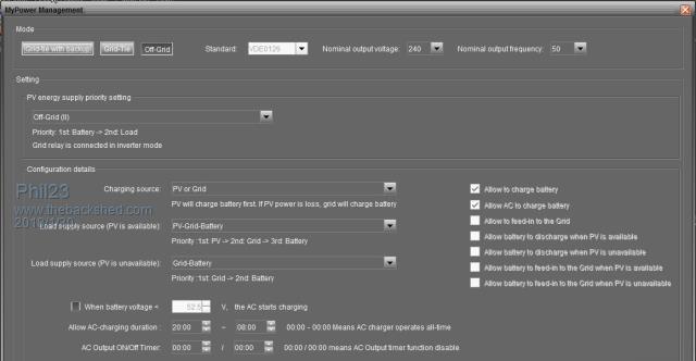

Phil23
Joined: 27/03/2016
Posts: 1667
Posted: 12:38am 30 Jan 2018
Very watery mention in the software manual.

The AC charge current will be on top of whatever AC loads you have running at the time so keep that in mind with what the generator can produce.
Phil23
Joined: 27/03/2016
Posts: 1667
Posted: 02:56am 30 Jan 2018
  Madness said   The AC charge current will be on top of whatever AC loads you have running at the time so keep that in mind with what the generator can produce.
Good point. 10A - 500 Watts +.

Madness
Joined: 08/10/2011
Posts: 2498
Posted: 03:42am 30 Jan 2018
10A = 2400W if it is the AC, can't read those setting pages.
Revlac
Joined: 31/12/2016
Posts: 1310
Posted: 10:52am 30 Jan 2018
What! you need glasses?
Downloaded the pdf manual and the screen shots are no better. (if it was the correct one)
After reading the off-grid section 1-2-3 I can see why its confusing.
Looks like the generator could ether supply the power to run the house direct (not ideal) or work as a DC supply (charger) which would work along with the solar and batteries, should be easier on the genny that way. Not sure, must be the only one that would do this.
I know for sure the HS model wont.
A note on gennys: some small ones don't have the neutral and earth joined, some do, have seen the little honda running ok on these.
Aaron
