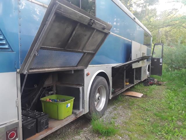

We are putting as many solar panels as we can fit on top
this is the reason why we're building a inverter
Neither one of us has ever installed solar panels on a bus before or anywhere else
we are currently in the process of taking all four roof-top heat and air units off
more room for solar
the whole top of the bus will be used for solar if anyone close to my location needs them give me a p.m. have all the paperwork for them
would really appreciate any adviceEdited by BenandAmber 2019-03-20

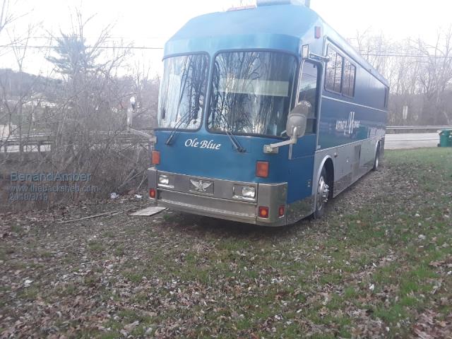

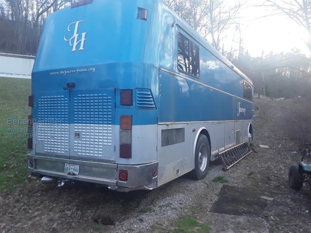

LadyN these are the same panels that the good morning good morning guy on YouTube used on his school bus conversion I love watching his videos by the way that are really good people
We are in the process of taking all four of the rooftop units off
we will be exhausting all are exhaust fans out the side of the bus
The roof of this bus is not like a regular RV this is the reason why we bought this one this RV is all heavy heavy gauge aluminum you can literally jump up and down anywhere on the roof and there will be absolutely no movement
When me and Amber went looking to buy an RV we looked at RVs that were only a year too old
They had already had leaks flat roofs and made out of literally toothpicks and a little thin coding of fiberglass or plastic
we have children and was scared to death for children to ride in one of these type RVs
even though we didn't think we could afford it we decided to get a tour bus
and converted into an RV
YouTube guy only use to rails 2 bolt his solar panels down and he did have a problem with one of them in the Wind but he fixed it pretty easily
I plan on putting at least four rails and plan on maybe riveting all the panels together
we know they would be harder to get apart
I think the advantages of them all being riveted might outweigh the problems
the bus is 40 foot long but the roof tilts down in the front and back that takes away about five foot of roof
we are working with 35 1/2 foot long by 8foot 4 inch wide there are giant storage bays across the hole bottom of the bus with plenty of room for batteries inverter charge controller and any other things we may need
we thought about taking the roof off my buddys golf cart and putting it in one of the Bays so lots of room is an understatement
thanks for your input and advice we appreciate it

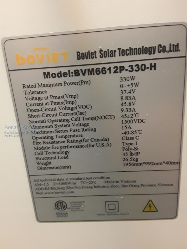

My solar panels are 77 inch Long that is 6 foot 5 inches and 39 inches that is 3 ft 3 inch wide
330 Watt
vmp 37.4
voc 45.8
9.33 amp
maximum system voltage
1500 vdc
cell technology poly-Si
We were wanting more solar and thought about a awning made out of solar panels that flip down to the side of the bus went on the road if anybody has any ideas on that it would be greatly appreciated also

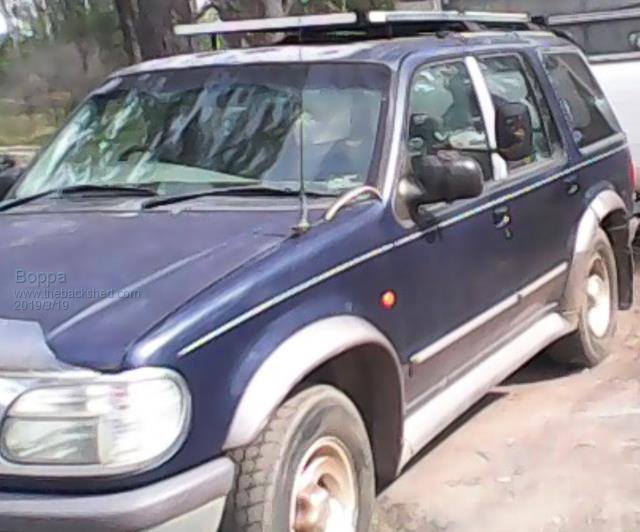

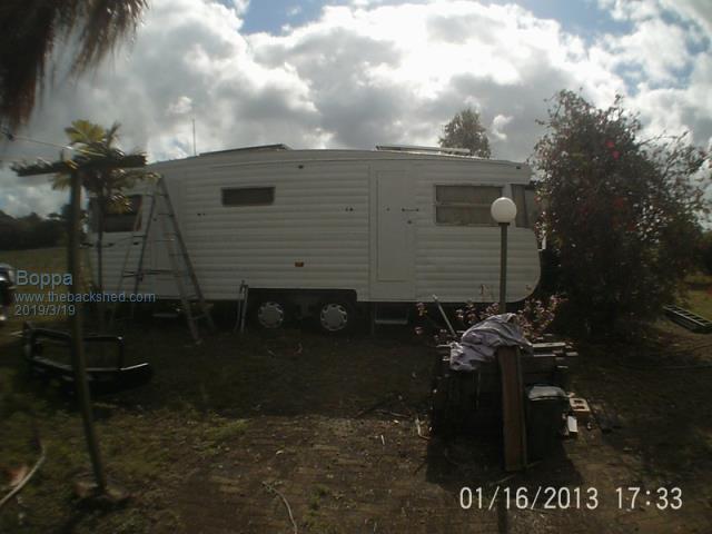

I had panels on the old Explorer on the roofracks, and on the caravan (nearly 2.5kw total, 500 on the exploder and the rest on the van)
They were mounted on ezystruts (having used it extensively in the mining game) with four rails in total down the length, and two cross struts under each set of panels lined up with the mounting holes in the panel frame, all mounted to the structural roof supports on the frame of the caravan (ezystrut is marvelous for this kind of thing- its a grownups mechano set lol, literally hundreds of brackets etc to make anything you want quickly and easily)
The four long rails (actually in hindsight it was massively overengineered and I could have used two) were spaced about 4 inches above the roof of the van, this gave the added advantage of having an airspace under the panels to keep them cool, and also dropped the interior temperature in the van markedly (it was originally only so I could open the roof ventilation hatches)
One thing I found with both the van and the exploders panels was to put a sloping 'wind deflector' between the panel and the roof if not mounted directly to the bodywork- unless they are flat or slightly nose down on the panels (to the direction of travel) the wind will get under them and they will try to 'take off'- acting like a planes wing, the deflector will stop this
The exploder panels actually bent the edges of the panel where the 1" washers were due to this, the panels will handle the wind pressing them down onto the cross struts with no issues, but lifting up, all the force was concentrated on the factory four mounting holes and bent the frame (due to the back of the exploder sitting tail down when heavily loaded and wind blast from a semi going the other way, with both of us doing 100)
ETA- you aren't the first to think of that awning idea either
;-)Edited by Boppa 2019-03-20

I thought about clamps, but as I was doing a lot of dirt road hauling, and I know from experience that EVERYTHING rattles loose (I lost a spare tyre off the back one time- the bolts holding the rack were still firmly bolted to the rear step- shame the entire rear step had come loose and fallen off (complete with my number plate!)
Nice guys some country cops, a copper pulled me over and asked me if I had lost something on the road from Cloncurry- looked at him with a 'huh what???' look, he walks around to the back of his 4wd and pulls out my bumperbar, and spare tyre LOL
I went with angle on the ute, bolted the panels to that with 1" washers and nylocks, then bolted another bit under the roofracks so they were 'sandwiched between them
Because the roofracks didnt go far enough forward and I was worried about the front lifting, the front edge of the angle was bolted to the roof with tube extensions (hey it was a 20 year old 4x4, I wasn't worried about drilling holes in it LOL)- if you look closely at the photo above you can see those mounts (literally being a piece of tube, with large washers top and bottom with rubber sandwiched between the roof and the washers)
The panels had reinforced holes in them (not reinforced enough as it turns out) and I put large washers under the nylock nuts to spread the load further just in case
The van I went with the ezystruts as they are mega strong, and if you need a weird bracket to make something fit- it's almost guaranteed they will have it in their range...
The frame on the roof was basically made to be self supporting, and to make sure it could handle it, I ran struts down the walls outside the van and bolted the entire thing to the chassis beams, plus bolted the uprights to wall beams- probably overkill but not only the panels but the entire van survived a cyclone near Mackay that many other vans, including the one right next to mine, didn't- I suspect the framework actually helped the walls of the van stand up to it- A 1970's aluminium framed Viscount was't the strongest beast around from the factory....
That was during the rebuild, new paint, new interior, 'new' secondhand windows (I ended up painting them all black as some had white frames, some painted grey, some natural aluminum and some black- and some were literally bits of all as I mixed and matched to get functional opening windows, the exploders new bullbar (not fitted until after that first shot of the exploder) lying on the ground next to it

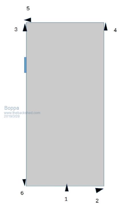

As an example
With the camera at the 'point of the triangle and looking towards the base (this would be for an Australian RV with the entry door in blue on the left and the front up the top, reverse left to right for US)
ch1 is reversing
ch2 is overtaking
ch3 is lane monitor farside, door monitor
ch4 is lane monitor nearside
ch5 is windscreen breakin/ security
ch6 is security
leaving two spares for extra monitoring, either more externals or internals
This gives 360 degree external coverage on the RV plus a reversing camera, all selectable viewing as either one or more on the monitor(s)
Actually I personally would put 7 as a mirror of 6 and 8 as a mirror of 5
Sorry about the size of the pic, turned out a little larger than I expected
Edited by Boppa 2019-03-29
