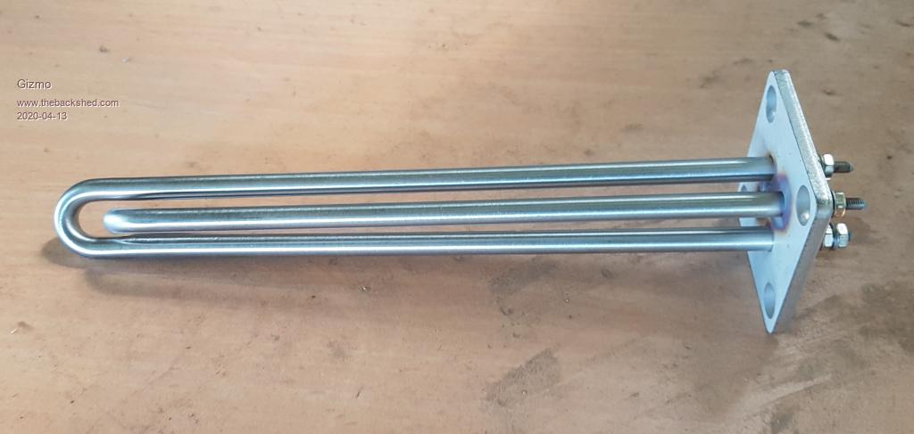

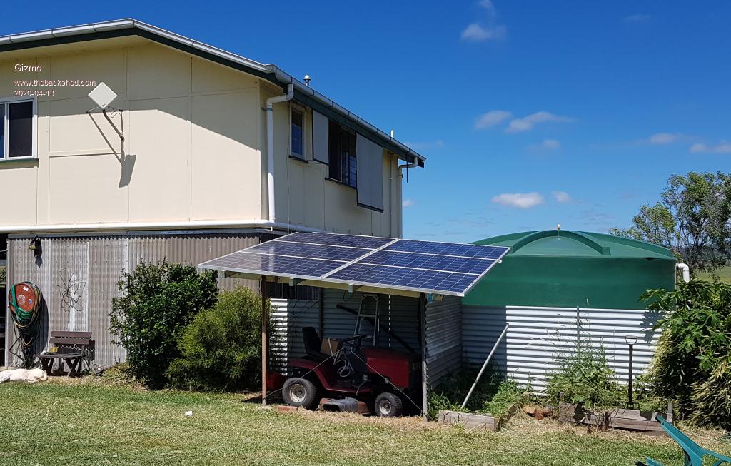

I've been running a thrown together hot water system for a few years. It used a 330 litre tank, a couple water heating solar panels, a pump and controller. It worked ok, but for a couple of months in winter it struggled to even warm the water, and I had to cover the panels each night to stop them freezing as it often goes below zero here. Fortunately I have a on demand gas hot water heater I can switch in when the solar water heater isn't up to the job.
After some interest on the forum regarding heating water electrically, I decided to go down that path. Second hand solar panels are very abundant and cheap here in Australia, a side effect of people upgrading their grid connected solar plans. I bought 7 230watt 60 cell panels for $55 each from a guy on Facebook, and a 1000watt 48 volt heater element for about $84 delivered from https://ringhotwater.com.au/.

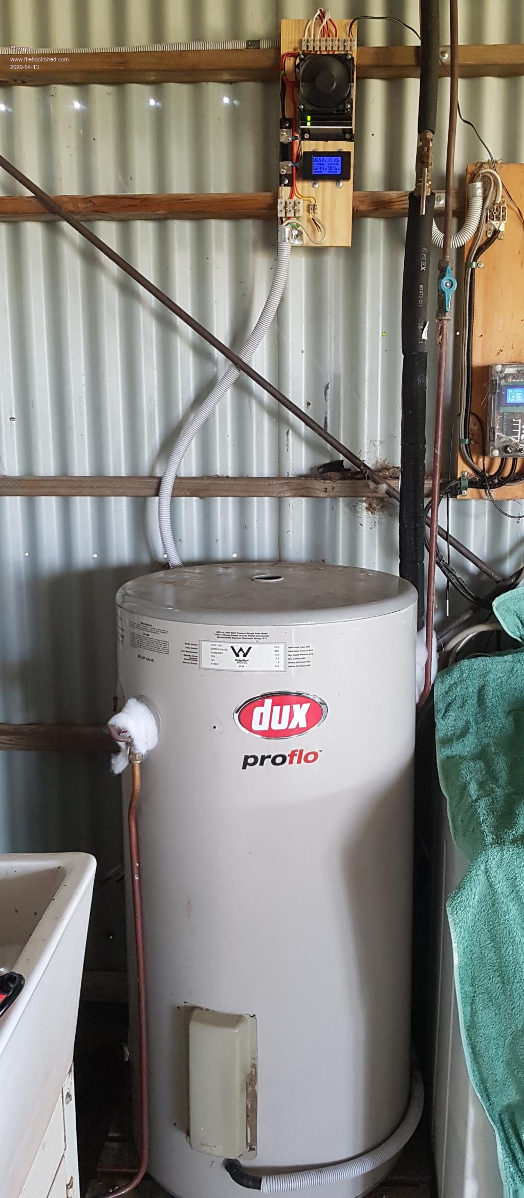

The existing 330litre tank was getting rusty, so swapped it for a near new 120litre tank I picked up at a clearing sale for $20.

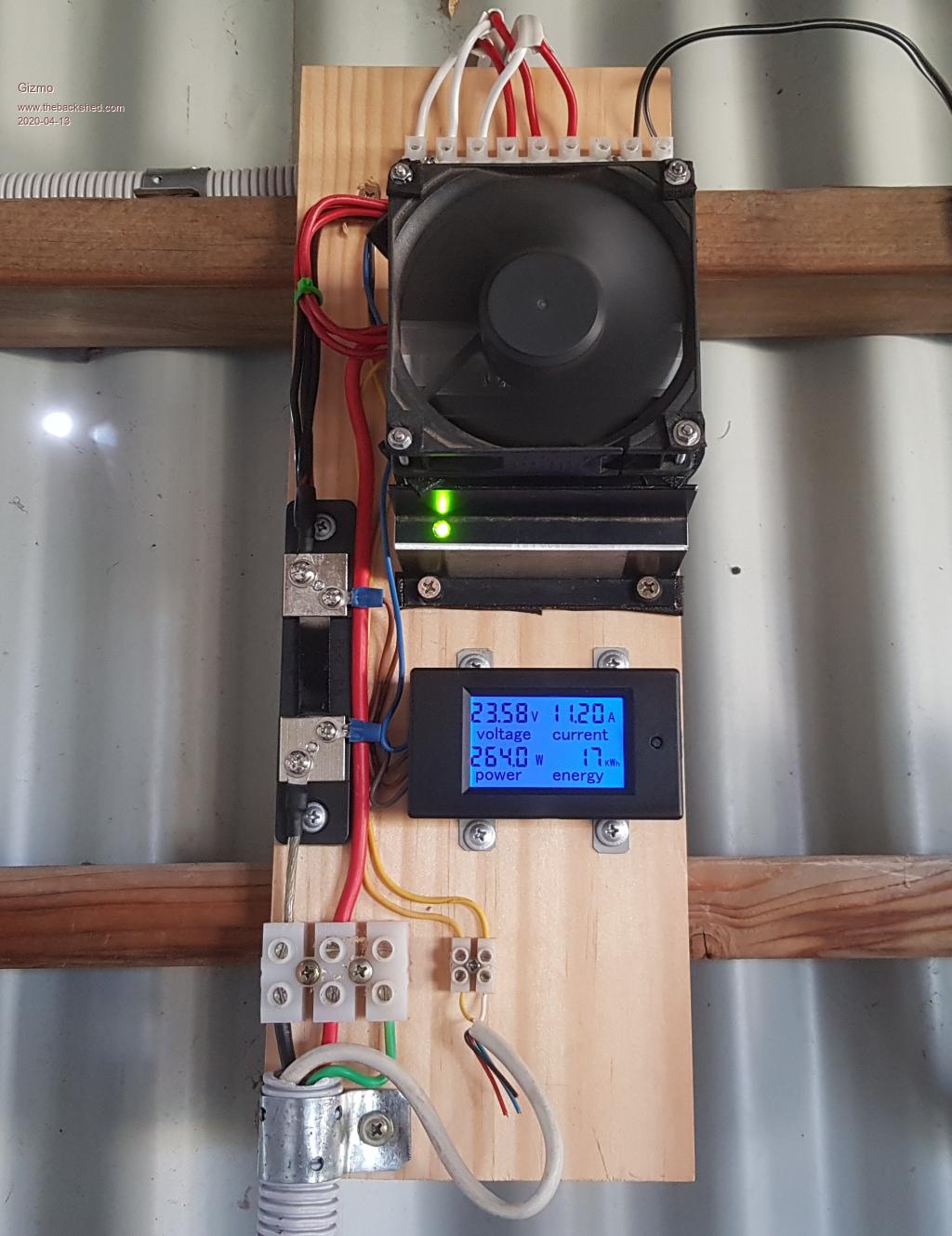

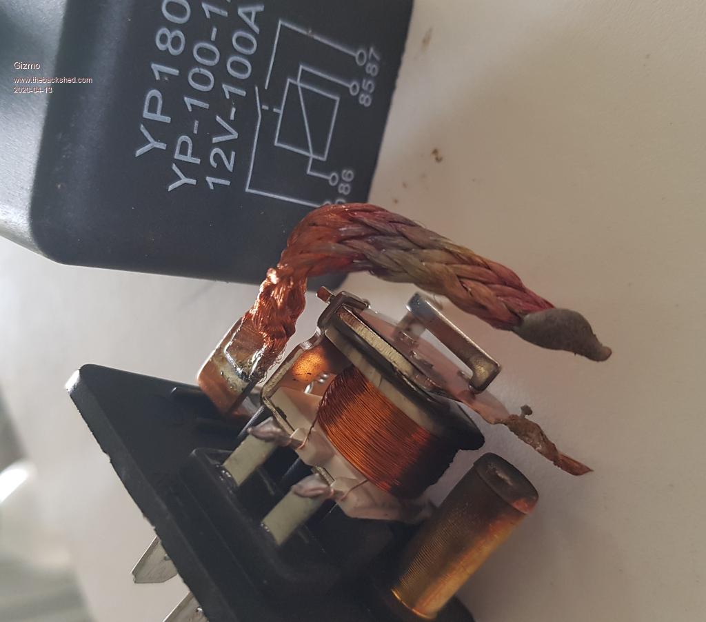

Mounted 6 of the solar panels in a series parallel setup, plumbed in the tank with the new element fitted and wired it up. I used a 100 amp relay, driven by 12 volts from a plug pack on a timer. This 12v was switched by the water tanks existing thermostat. All worked fine the first day, the tank was heater up to 70c from cold in about 6 hours. Next day, it wouldnt work. The relay had gone open circuit, on closer inspection, the contacts had vaporised.
This was due to the DC arc when the contacts were opened. So I tried new relay with capacitor resistor supression across the contacts. Same deal, zap. Dug up a power mosfet from a junked inverter welder, mounted it on a heat sink with a fan, added a few components and bingo, no more zap.

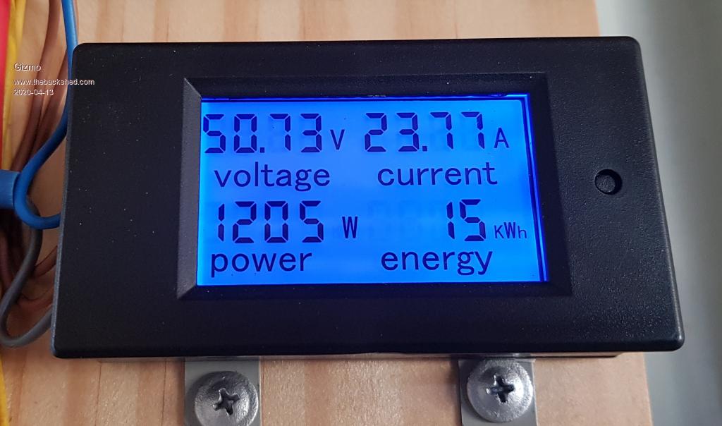

To keep an eye on things I wired in a amp/volt/watt meter.
So far so good. Be interesting to see how it goes in mid winter, at least I wont need to cover the panels at night anymore.

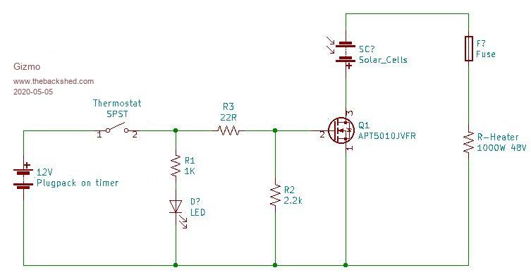

Yeah using the existing thermostat on the hot water tank to switch 12v to the MOSFET gate via a 47r resistor, and a 1k pull down resistor, plus a indicator LED with resistor. I'm using a big old MOSFET I found, but I would suggest using a 40 amp SSR on a heatsink with a fan. It would be easier and you can keep the 12v and solar panel volts separate.

Be interesting to see how it goes over winter. Yesterday afternoon the tank temp was 65c, and after 2 showers and washing the dishes, it was 50c this morning. See how long it takes to recover.
If it struggles in the winter sun, I have a 48v 20amp battery charger I could use to give a boost in the middle of the day. I used that battery charger with my petrol generator to top up my main battery bank if needed, but havn't needed to do that since I added more panels a few years back. My main battery bank is finished its charge cycle just after lunch time in winter, so I could spare a couple hours solar power first thing in the morning to boost the hot water.

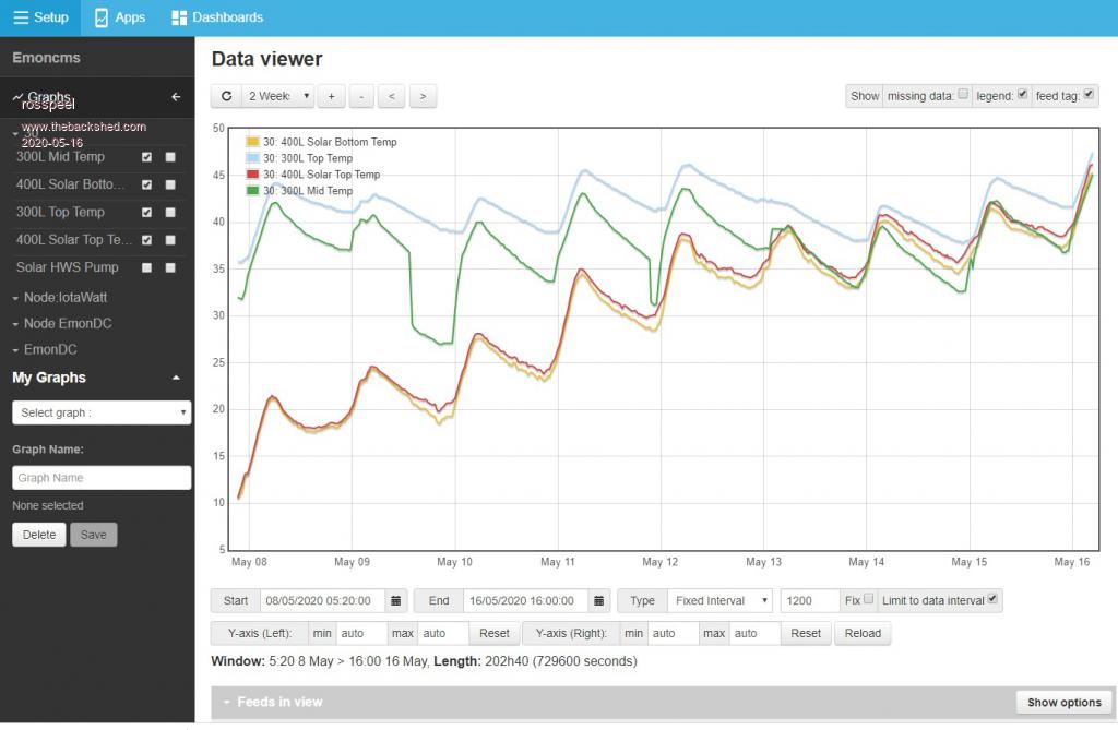

I went and checked on it just after lunch, it had finished heating and shut down by then.
Its funny watching the temperature. I have a thermister sitting against the bolt head attached to the anode, then covered in a rag to keep it close to the bolt temperature. So in effect I'm measuring the temperature of the anode, which extends down into the tank most of the way.
When the heater element is turned on, the temperature drops about 5c in about 10 minutes and then sits there for an hour or so before starting to rise. Must be some sort of convection going on.
Posted: 06:25am 14 Apr 2020
Convection will be pretty powerful, and keep the water mixed while the element is working. There will be ice cold water right at the bottom where the entering water is, but through mixing having the whole tank at a fairly even temperature makes the most efficient use of the insulation.
Later on, you might like to try wrapping the whole thing in some additional insulation.
You won't gain hugely, but its pretty much a way to gain something for nothing.

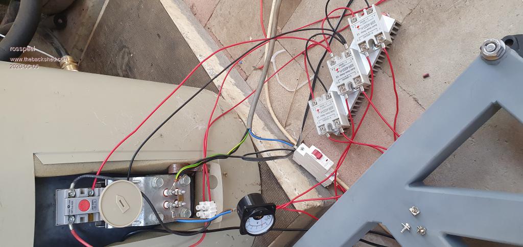

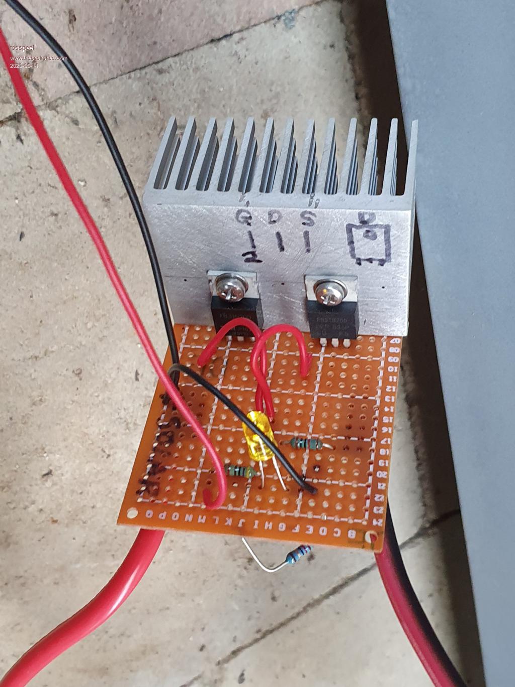

I am starting to play around with a similar setup using a 36v element and changing the bridging link on the element to turn it into a 72v element, my big problem is killing SSR relays, I don't know why this is happening they are rated at 40amp and 250VDC  (SSR_40DD-H), I would like to know about your mosfet setup as these SSR relays only last a few day. I got it on a trial 80L tank but as soon as i get the bugs out I am going the 400L tank.
Posted: 10:40pm 04 May 2020
I'll draw up the circuit later today, its pretty simple.
Where did you get your SSR's? I bought a 60A SSR of ebay once, it got very hot with just a few amps. So I pulled it apart and discovered a 30 amp NPN transistor instead of a much higher rated MOSFET. It was a fake.
Also, SSR's need lots of heat sinking and fan cooling when you push the amps.
rosspeel
Joined: 27/03/2020
Posts: 17
Posted: 12:03am 05 May 2020
  Gizmo said  I'll draw up the circuit later today, its pretty simple.
I got them from ebay, I will have to see how to pull a dead one apart and check the transistor
Posted: 01:48am 05 May 2020
Here's the circuit, from memory.

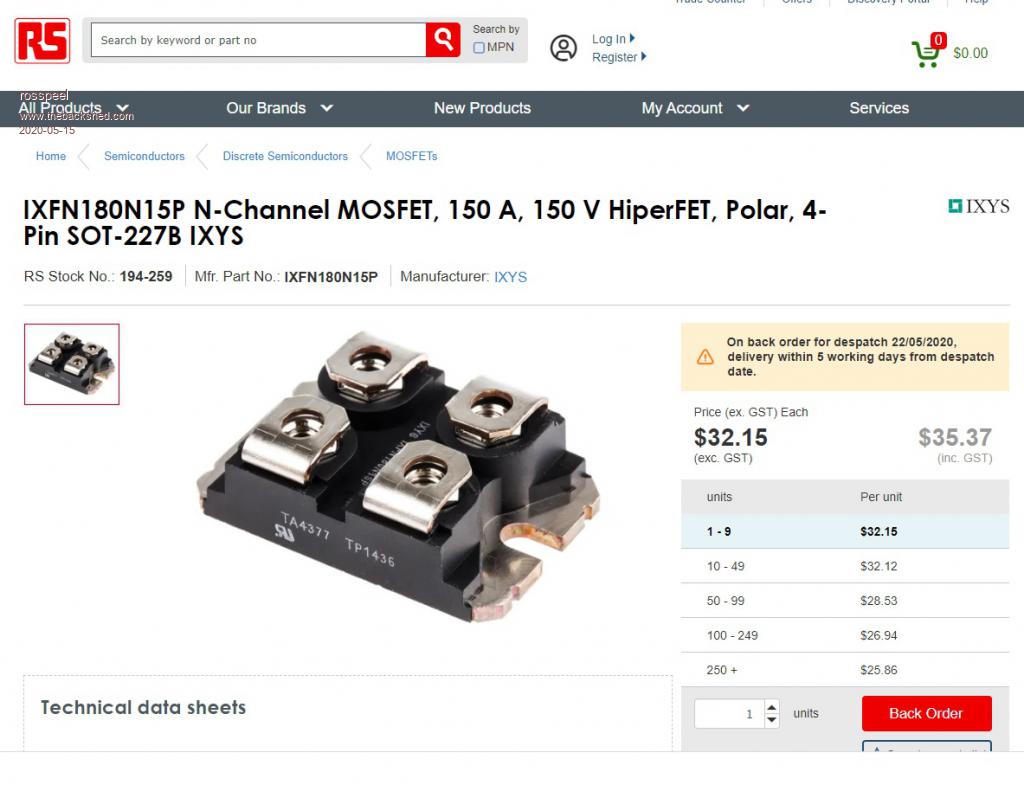

The mosfet is something I found in a dead inverter welder. Its probably expensive, so look for something cheaper, 40 amps 100 volts N channel mosfet.
I'm using a 12v plug pack on a timer as the 12 supply. Once day I'll use a little 12v solar panel instead.

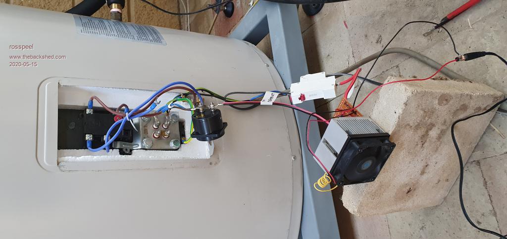

Had a spare heatsink so as temporary measure i have mounted 3 of these 40a cheap ebay SSR, I will look into mosfets
Edited 2020-05-05 13:41 by rosspeel
rosspeel
Joined: 27/03/2020
Posts: 17
Posted: 03:43am 05 May 2020
Well those 3 SSR ganged together didn't last long, killed all 3 of them, only lasted one thermostat switch cycle

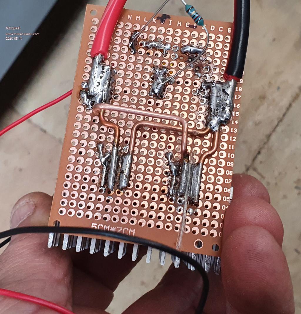

Thanks for the drawing Gizmo, I have ordered some Mosfets online, and now the wait for the postman...
rosspeel
Joined: 27/03/2020
Posts: 17

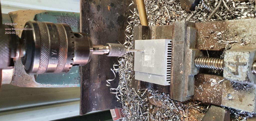

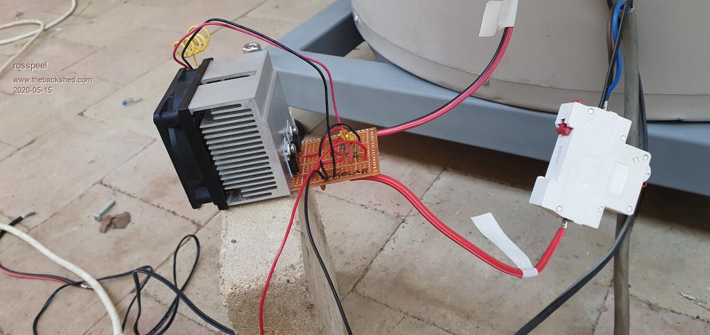

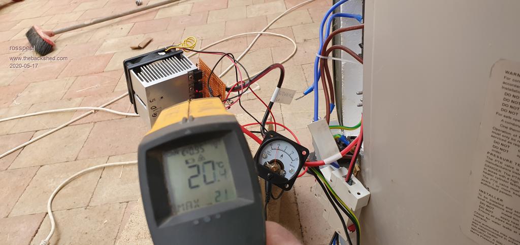

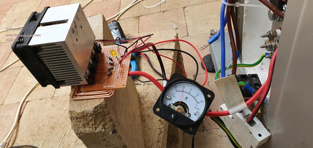

Posted: 06:11am 14 May 2020

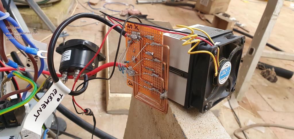

I have late this arvo made up a mosfet switch, bit late in day to give it a full test, I am using two FB31N20D rate at 200 volts, 31amps, tomorrow will be the test
Posted: 08:18am 14 May 2020
Looks good.
Watch the heat closely the first few days, mine needed a fan.
