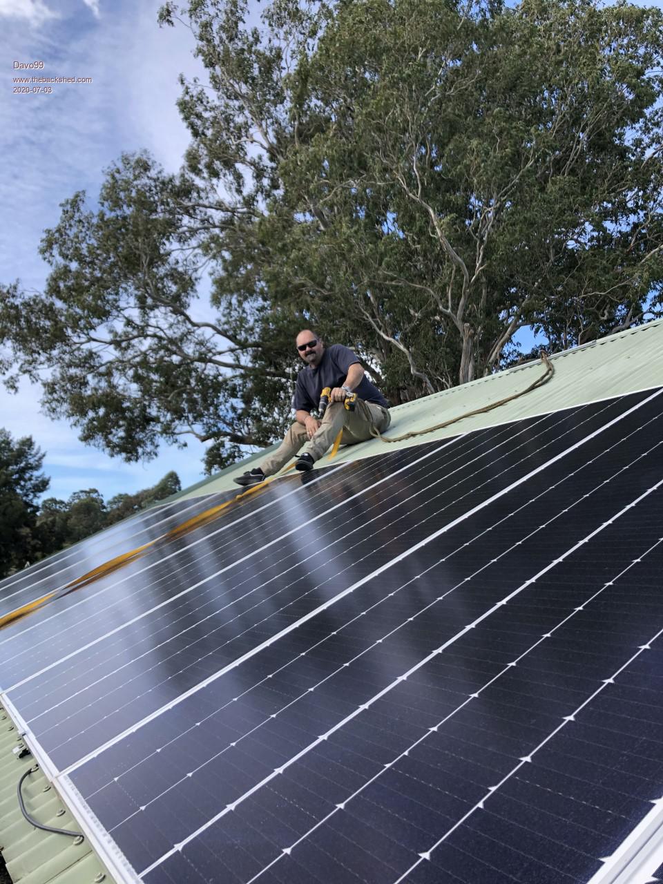

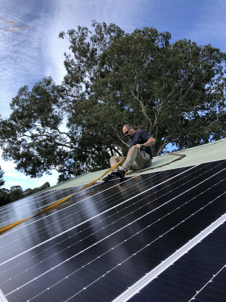

On the other roof I used the bottom row of panels I put up as foot holds as I leaned and walked my top half on my hands and used the panel edges as foot stops to save sliding down the roof. Doing the other roof I realised, the chances of falling were not very high, If I went off I'd likley be sliding and in reality, with the edge of the roof not even being a meter taller than I am, long as I came down feet first, the worst  thing was probably going to be grazes on my stomach or arse as I went over the gutter.
The 1m between the roof edge and my feet hitting the ground was a non issue. I tried to make a mental note NOT to grab the guttering as I went over and pull it off the eave, just bend my knees when I hit the ground and then get back up there and finish the damn job!

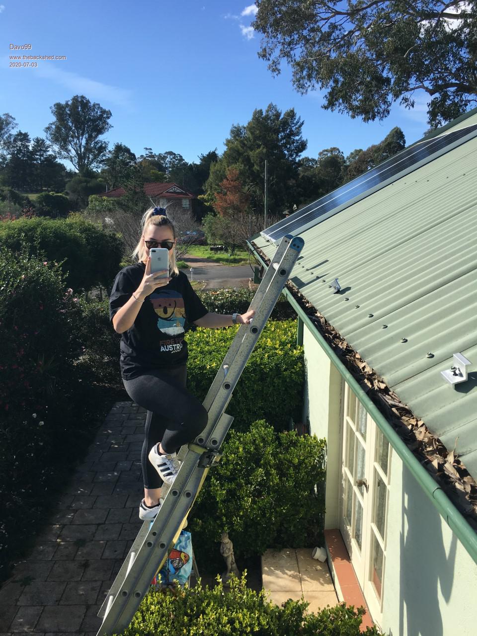

Yesterday  was the daughters day off so she was commandeered as the unhired and critical assistance needed. Was a great day for it, unseasonably warm and sunny.
To get the panels up, I got one of those extending ladders and put it just above the roof height. I got up and put a bracket in one of the roof screw holes and secured it with enough play it could go over the edge of the panel and stop it sliding off.
I then lent a panel against the ladder, Pushed it up and climbed up the ladder and pushed it onto the roof Using all approved OH&S safety equipment and procedures of Course!  :0)

From there I got up on the roof from the Front verandah, climbed up the roof channel and  locked down my home made securing point made from a piece of Unistrut with a Bolt welded across and a big  shackle Bolt through that. I put a thick piece of rope through that and tied it round myself Abseil style. I secured the unistrut across 4 roofing screws which I was satisfied would hold even my fat arse.
This was really less in mind of a fall prevention that something to be able to hang onto to haul myself up and around the roof on and not slide off. I could get some fixing on the roof screws themselves with the Volleys but they were an only just propositions and not something that I felt would take my bulk and the extra 22Kg of the panels.

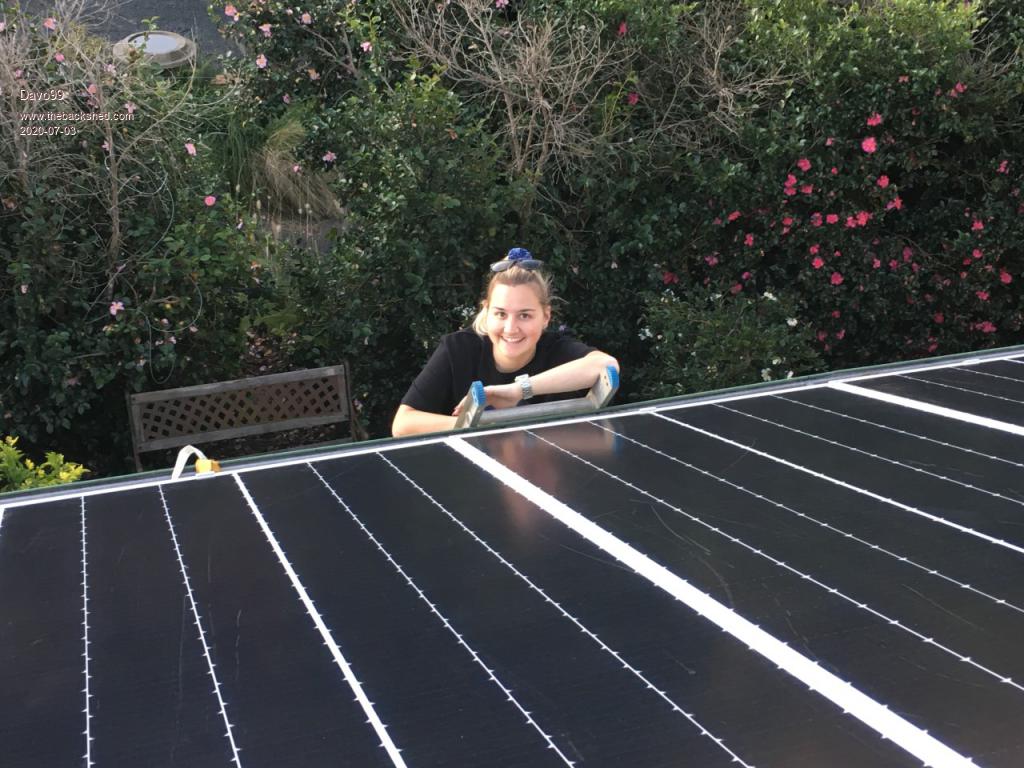

I  started with the biggest and heaviest 405W panels as I thought it would be easier to pull the other ones up over the top of those and less weight on them. I also have this mindset of do the hardest work first so you are doing the easiest work when you are the most tired not pushing yourself harder. Turned out to be no real difference in this case, the panels were more similar than I realised.
From there, my daughter lent a panel against the ladder and put the hook from a tie down strap under the top edge. I had the other end and hauled it up while she mainly Guided it and helped it over the top of the ladder. I used the first panel as the foot hold and then got the next panel up far enough to move it across to the next clamp I had measured and preset while I connected the cables and then moved it into position. My Daughter then tightened down the clamp and we rinsed and repeated along the roof for 8 panels. I put a good dob of silicone roof sealant under each clamp to make sure the screws were sealed as the original seals being 20 years old are pretty weathered and I wasn't sure of their durability when disturbed or if they would work with the clamps.

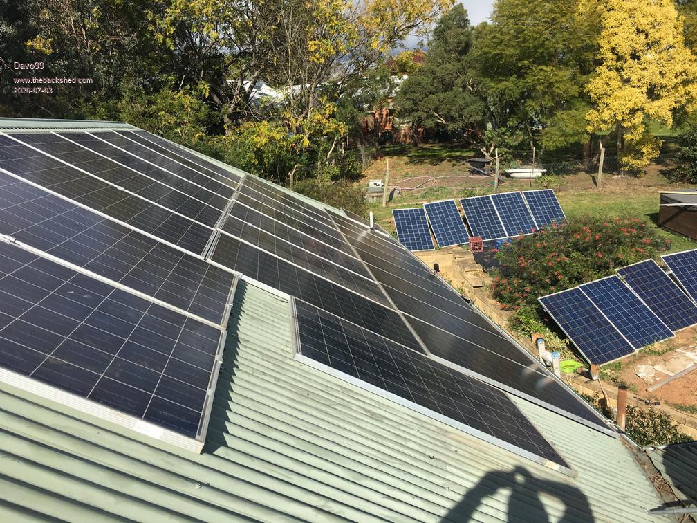

This was the array I put up last week and got my roof legs and tactics worked out.
24 x 250W panels.  Still enough room from the end the picture was taken to add another 12 panels so I might extend the strings from 8 to 12 to end up with one less.
That will be 3 Kw on a 2 Kw tracker so should be OK given I'm really chasing winter yield. Ground test array in background (That's been there a year!) will be finally going up on the roof to make way for outdoor bathroom and landscaped spa area to go in when Tractor finally arrives from stealership.

Note clamps in place along bottom row of roof screws  ready to hold panels.
Crash test Dummy overcoming fear of heights and installing panels.  Note full safety equipment, PPE and observation of all OH&S procedures and practices.  May be a bit hard to see in the pic but they are all there in place and was approved by a safety inspector before and during the time the work was carried out.

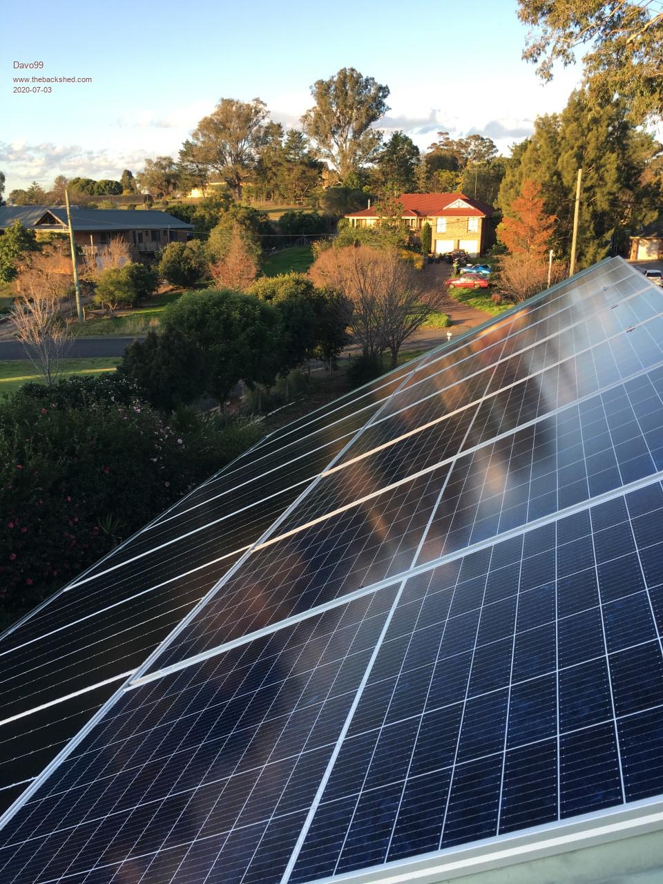

The finished array. These new panels look pretty good I reckon. About 95% of that roof area is covered bar a couple of angles at the back end. I put extra clamps on the end panels as we get scary strong winds here and the end panels are the ones that cop it the most. There is a small overlap on the top ridge of the roof of about 100MM which isn't Kosher these days although the neighbours panels have a lot more overhang and they were installed by someone " Licenced". Quite a few things with that setup I wouldn't do myself and think are dodgy but anyway.
The great thing about not being solar certified is everything you do is automatically against regs so no need to worry about complying from then on! :0)
No roof Isolators on this setup and I'd never entertain the idea of having them anyway. 100 times more problem than they are worth. Another benefit of not having to comply with often stupid regs.
I'm more than  satisfied no panels are going anywhere less the Colourbond and the roof trusses go with them.  Also satisfied that the roof is now less likely  to ever leak than it was before.
