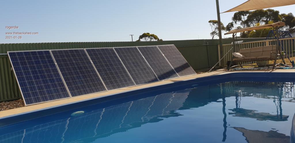

Hi everyone, I wanted to do a post on a project I have had running for the last year.
I had looked all over the place for answers as to whether I could run a pool pump directly from solar and with a bare minimum of control electronics ... but could never find anything ... other than other people asking the same question.
I found this forum 18 months ago in the middle of 2019 and got all excited about building some sort of inverter and adding a forklift battery to help reduce our power costs.
In the process of asking questions and trying to understand my best plan of attack, I realised that our pool pump was a large part of my annoyance with power useage/wastage ... and with a fair bit of prompting from Warpspeed, decided to experiment with tackling that.
Tony's suggestion was that I hook up a DC treadmill motor to the pump ... and match it with enough panels to drive it sufficiently ... and see if I could eliminate that usage from our bill.
To cut a long story short, I did exactly that ... and have had the pool pump running for a year on solar ... apart from when we switch over to mains to vacuum ... or need to circulate water at night after adding chemicals etc.
Apart from the mechanics of the system ... there is only a DC treadmill motor, a string of panels, a solar isolation switch ... and a diode to prevent the treadmill motor feeding power back into the panels if I switch on the pump's 240V AC motor (without isolating the panels or removing the belt).
Where before on AC it was set to run for 4 hours each day (probably should have been 6 hrs) ... now it runs most of every day, as long as there's enough sunlight to spin the motor.
I ended up using 6 x full size 250 watt 30 volt panels in series ... though in reality I should probably have 2 strings of 6 in parallel ... so it definitely does not run at full power for all that time. In fact it would rarely run at full power.
To give some idea, it might run at 50psi pressure at the filter ... and if I switch over to mains, it might go to 70psi. Of course it often runs way lower than that when conditions are poor ... or the belt is coming loose and needs to be nipped up.
Having said that, I regularly check the pressure of the feed-in to the pool to feel what the flow is like ... and it still moves a fair volume of water by the end of the day.
Certainly we need full pressure for vacuuming and various treatment type functions ... but the majority of the time (95%) we just need the water circulating through the filter.
I had investigated variable speed pumps in the past ... and the manufacturers make the point that the water does not need to be circulated flat-out to do the job ... and a fair bit of their power savings were through running them slower when possible. Only problem with them is the initial purchase cost.
... anyway, now that we're back into summer ... and I've made a bit of an effort to fine tune the pipes and fittings ... I've found that I can use the Kreepy Krauly pool vacuuming system quite effectively on solar on an average day.
In my next post I'll go over the process I went through and exactly what I used.

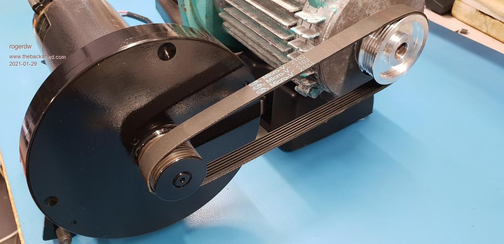

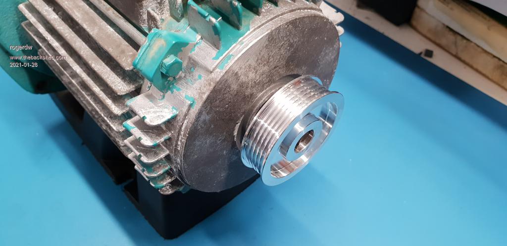

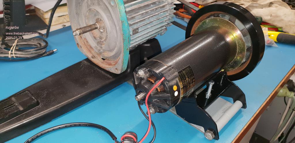

The pool pump is a 1.5hp Onga and has a cowling on the end of the motor covering a simple pressed on plastic fan.

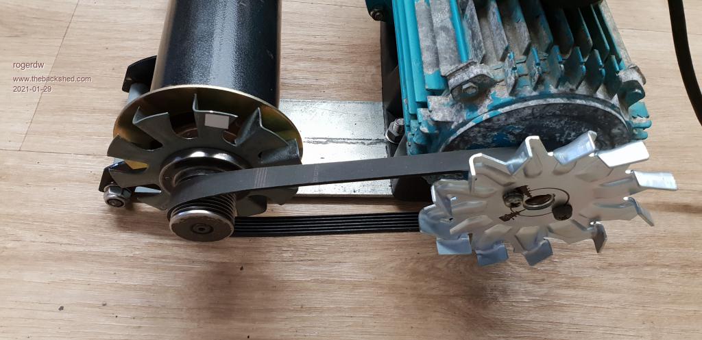

I hoped that I could remove the fan ... find a pulley of some type that could be held on with a grub screw ... then match up something for the treadmill motor.
After looking at various taper fit pulleys ... being a bit scared off by the prices ... as well as the fact that there was not a lot of shaft sticking out ... and also thinking of the friction that would be created by having a V-Belt tight enough to drive properly ... I was starting to have second thoughts.
Fortunately Tony came to the rescue when he sent me a link to some ribbed pulleys on eBay ... which just so happened to have the same profile ribbing as my existing treadmill motor pulley. He had calculated what sizes I most likely would need ... so I sent off an order for a selection.
They come in various bore diameters ... and I was fortunate enough to find some marginally smaller than the shaft size. I'd like to tell you I machined down the shaft to fit properly ... but I ... ahem ... powered up the motor and used a file to take the tops off the faint spline that was used to hold on the fan.
It only needed about half a mm off to accept the new pulley ... so it was a pretty simple exercise, if somewhat rough! A couple of grub screws holds it firmly in place.

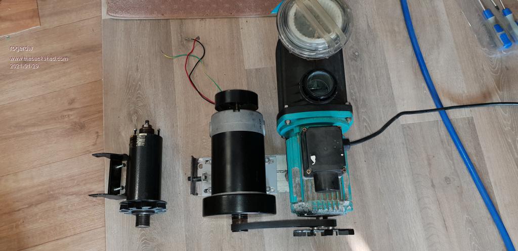

I had already collected a dozen 250 watt 30 volt panels, so I simply leaned some against the inside of the pool fence ... which fortunately happens to face north ... and hooked 6 in series ... for a total of 180 volts.
Check the pictures to see my first set-up.
It ran pretty well and I was happy with the performance, though I was a little casual about how hard the motor was working.

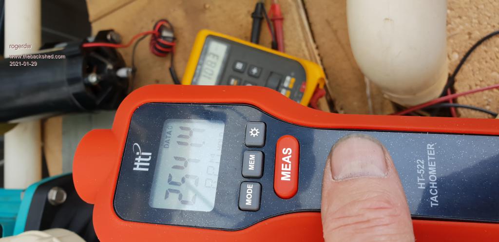

I bought an optical tacho and noted speeds with various loads and size pulleys.

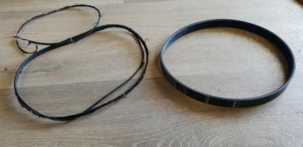

It only took about two weeks before the brushes burned out on the poor little motor and cooked it beyond repair.
Fortunately, in the mean time I had picked up another complete treadmill for $50 ... and this one had a physically much larger motor. I had to rebuild my motor mounting arrangement ... but it turned out pretty well ... and is relatively easy to adjust the belt tension.
I did measure the brushes before I installed the motor but despite spending ages on eBay etc ... could not find any brushes the same size. I probably do need to check them again ... but they've been going for more than 12 months already.
With the first treadmill motor and under Tony's guidance, I had removed the flywheel section of the treadmill motor pulley so that when I needed to run it on AC ... the AC motor wouldn't have such a hard job to get it up to speed.
I simply drilled a series of holes through the cast material and went up in sizes until it fell off. Then a few minutes on the grinder and it was nice and smooth. When the first motor failed and I replaced it, I never got around to removing the flywheel on the second motor ... but the majority of the times I do use AC, I remove the belt anyway ... just run it off with my fingers.

You have done very well with this. It's a great low cost and simple application of " appropriate technology" and making use of repurposed materials. You even managed to use the same pump for DC and AC use.
One thing that may be of help when driving with AC is an automotive over run clutch. They are used on alternators on Toyota's among other vehicles. Basically allow drive one way but not the other. You could set it up so the DC motor drove the pump but the AC motor wouldn't drive the treadmill motor.  Might be some gains and less wear and tear there.
What size ( power) is the treadmill motor?
Most I have seen are around 180-200W.  I can see you have geared this down but given most pool pumps are 750W + I have seen, I'm a bit surprised the treadmill motor has the grunt to do the job with sufficient flow rates.
One great thing with those poly Belts apart from lower losses, is that you don't need near as much wrap or tension to get the things to bite. You could easily add another motor in a tri configuration to increase the power and speed and lower the load on the individual motors.

Roger and I discussed alternator over run pulleys, but the problem is that most are designed to fit a standard 17mm alternator shaft with a keyway and a big nut.
The rear fan shaft on Rogers pump motor is rather short and of a much smaller diameter, it was only ever intended for a small plastic motor cooling fan.
The trick has been to match the solar panels to the motor requirement, then match the motor to the pump with a suitable pulley ratio. It seems Roger has all that pretty well sorted out.

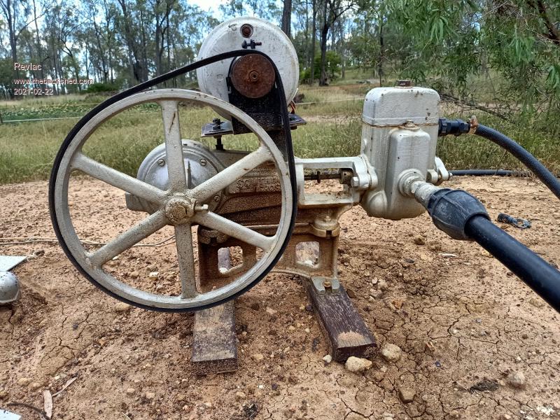

When I was about 7yr old,(Mid 80's) got hold of an old Ajax piston pump and done it all up nicely, never used it until last year.
Mounted an old 32vdc washing machine motor on it and connected up 5 250w solar panels and its run well (garden and dam is 250m from the house) up until 2 week's ago when the leather buckets give up.
Needed it working so made up a 3D printed piston with grooves for O rings (not ideal but needed) to get it going again in a hurry.
There is a small 400w Onga pump I would probably drive the same way with a multi V belt, The motor is one of those universal motors that can be found in some old washing machines and already has a multi V's cut into the shaft, probably not powerful enough to run a pool pump, I think the Onga pool pumps are much more powerful than the old garden variety.

I agree with the comments on the belt too ... it's not under a lot of tension and behaves quite well. I think that when I run the pump on AC, it gives it a bit of a hiding and needs to be adjusted again sooner than normal.
Having said that I've probably only adjusted it half a dozen times in a year.
I also think it could do with a bit of a 'sticking' agent to help prevent slip. There's a fine line between slipping and adding enough friction to start to load it down. When I was home on the farm we used 'Black Jack' ... a thick sticky treacle like substance on any flat belts to help prevent slipage and improve drive.
I'll have to try one of the farm machinery places  ...  I'm sure there would be a modern day spray-on version ... with a more pc name!
The other way to do this  might be to use a spring loaded  tensioner.  Done that on a couple of generator setups.  you could have the belt loose enough so when the tensioner wasn't engaged, the belt slipped freely for when you were driving the pump on AC.
Reconnect the spring or have the tensioner on a lever ( and the lever itself can be the tension weight) and the  treadmill motor will be engaged. you can get them off cars and I have seen skateboard wheel used as the rollers as well.

As Dave says, more belt tension would be very helpful, and a really strong spring tensioner would be the way to go.
A suitably long lever that sockets in (like a jack handle) to easily override the spring, would be a convenient way to slip the belt on and off when full mains power operation is required.

I use one on my standby petrol powered battery charger, and I have hooked it up to one of those 12v dc bilge blowers advertised on e-bay. That makes a huge difference to the temperature of the windings and the bearings.
The hot tip with any treadmill motor might be to not overload the motor. Allow it to run fairly free at high rpm and high voltage, and keep the current and torque down. Its only current that heats up the windings.
That way, it can produce significant horsepower at relatively low current, and run cooler.
Use a pulley ratio high enough to let the motor rev fast, and let the pulley ratio multiply the torque.
