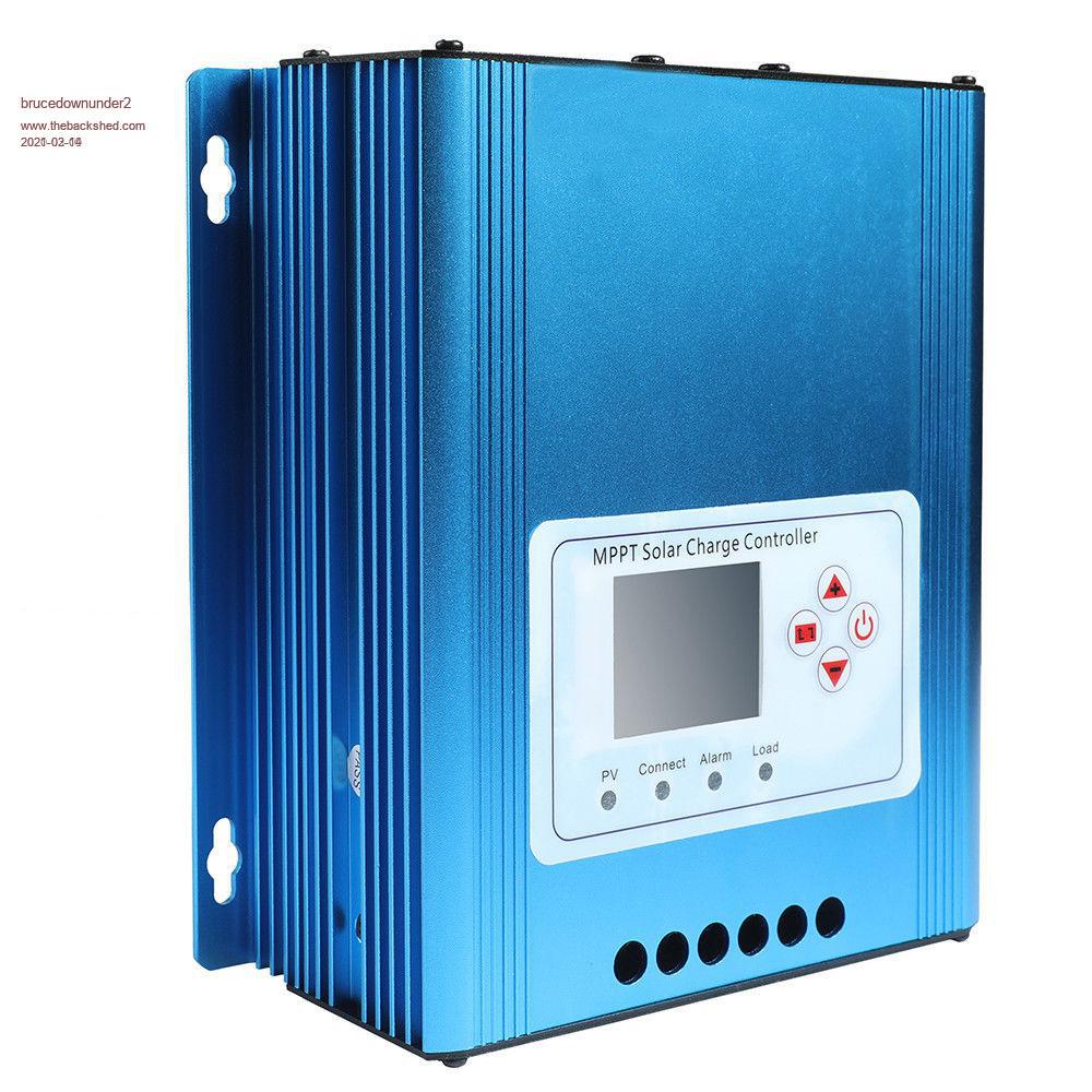

I purchased a new MPPT controller about a year ago , and I need some help ?.
I'm happy with the controller,  a CPE series 060(60 Amp) ,   have written many times to the distributor ,but answers to my questions seem to be fairly vague.... it cost around $250 ,so I thought it might be OK .
There may be nothing wrong, but I'm concerned ,because I don't see any "battery use" . I'm connected to around 500 watts of lights , battery is showing 3/4 full to full most of the day ,but no battery consumption on my controller display.
I've got it wired to about 2.5 Kw of solar , so should be no problems there.
My main wish is to talk to someone who actually has one , so anyone that has one could you please phone me ,so we can exchange our experiences.
I've read the instruction booklet hundreds of times , but its sort of written in a way that my brain can't fully understand. 76 , so may be missing a few bits of the OL brain box  ,??? .

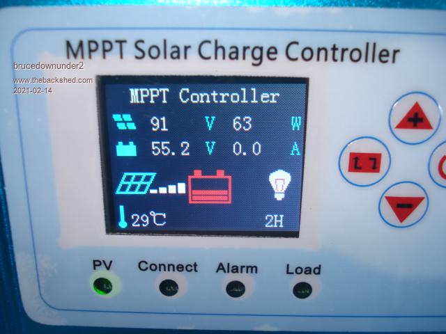

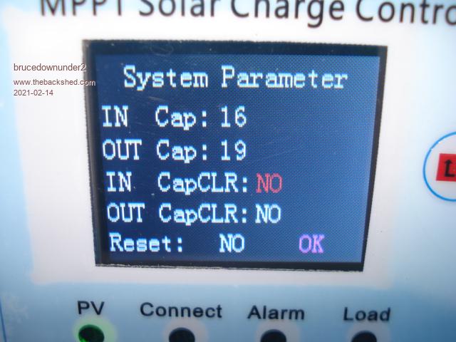

From my previous post, the illustrated bottom MPPT Controller view,   you can see that I only get or ever have got , somewhere around from  63watts . mostly less, I don't think ever much more .
So, I'm wondering if I have the parameters not set correctly,(because the 8 x40watt are using in the order of 6-8 amps ?
Yet, my batteries are being charged, because the controller shuts down around 55 volts. and the battery symbol shows a full charged battery, plus I've seen the PV green light (led),the bottom lefthand indicator LED on the bottom row of LEDS) extinguish for a short time before it charges again.

 I think ,along with Aaron, that my particular problem lies with the unit never charging above float mode voltage ??.
 Mostly ,have seen it in the 60-70 watt charging range , where with my workshop lights load of ,say 400 watts , I'd expect the charging to be in the 300-600 watt range ,but never seen this.
Be great if the video poster could call me on the telephone ,so I could be led through the steps required to ,maybe, get mine working correctly ,please call or send me a PM and I'll call you back ,please.
I've checked everything that I possibly know of ,,,except the darn instruction leaflet,which is confusing in it's interpretation -all those little buttons .
Thank you again,
Bruce
 I think I should have said --TRICKLE MODE-  that the unit is constantly charging at ,,not FLOAT MODE .
