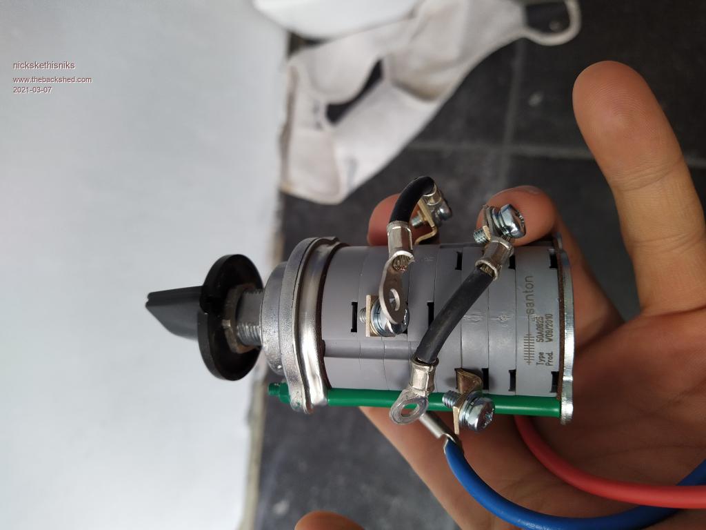

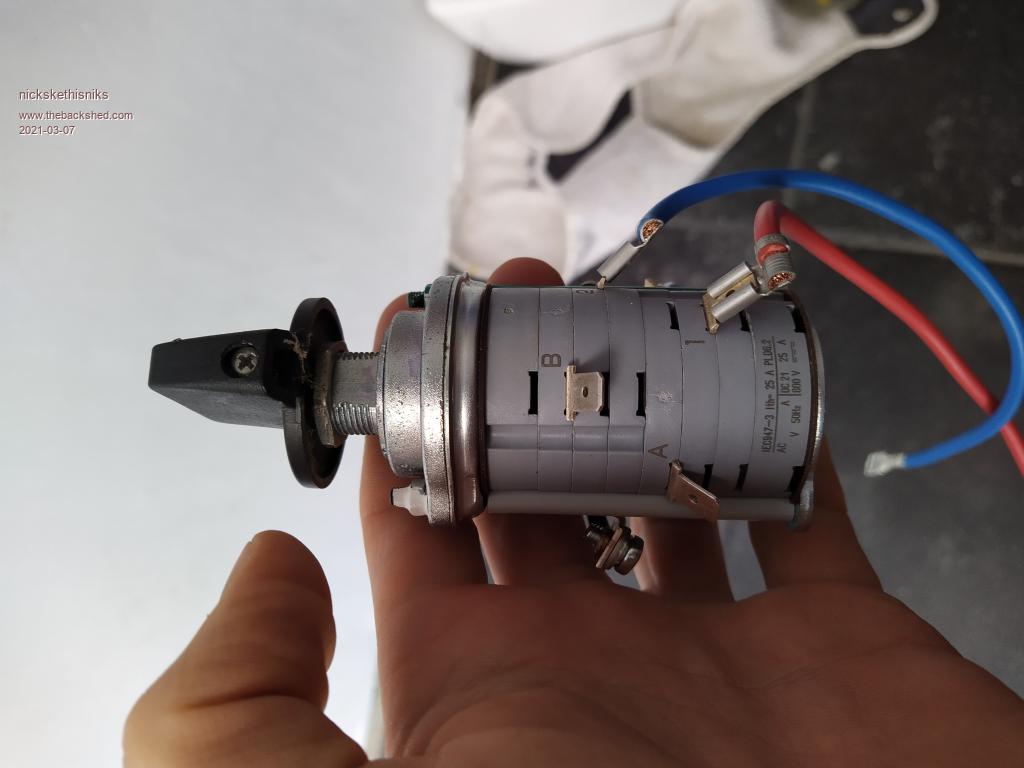

Hi there,
I'm redesigning my energy system. I'm making cable run's shorter and thicker. One thing I want to include are solar disconnect switches for bringing down the solar arrays. That way I can work more safely on the system when things need to be swapped or changed. I do have breakers at the moment.
So I have some solar disconnect switches out of solar inverters I can use, but they are only 25A 800V. I do have 3 strings so I will use 3 disconnects. I have 24 panels, maybe 26 in the future,that makes 120A (130) +/-60V, I have 3 cable's coming down (each 25mm^2) So I can still spread the load over this cable's.
But 25A will be to little, what I noticed on the switch, they have 4 separate contacts, they were used 2 times 2 in series. So in theory I could rewire the switch in 2 times 2 contacts in parallel to have 50A. It's only a low voltage system I have, so the voltage rating would still be enough.
I can't find a datasheet of the switch, any thoughts on this?

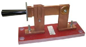

I suppose you could always use knife switches ?

Posted: 02:21pm 07 Mar 2021
Four sets of 25A contacts in parallel, other than being a big no-no in our code, isn't a great idea in the first place.
And the kids on the internet generally think that it is a bad idea as well:
https://electronics.stackexchange.com/questions/105126/is-it-good-practice-to-parallel-relay-contacts-for-increased-current-capacity
And while there are relays designed for this:
http://www.ia.omron.com/products/family/1767/
But while it can handle 40A @ 480 volts on AC times 4 poles for 160 amps, it drops down to 5A @ 110 volts on DC.
So no...
Where switches get torn up by DC is when you open them since there is no alternating part of the cycle to help quench the arc. We would go as far as to install a fan in panels aimed at the DC contactor to help blow out the arc. :)
The lower DC ratings for a switch compared to the same switch running on AC reflect this.
*A* solution for this is to add a MOSFET "switch" downstream to cut the power first and then your disconnect won't be opened up under load. Interlock that with the disconnect so it shuts down before opening the disconnect.
For something that's designed to be turned on and left on, I would go with one of these:
https://www.digikey.com/en/products/detail/microchip-technology/APT75GT120JU2/1920297
A bit pricey at about $25 each, but you won't have much of a board to develop to drive it, nor the hardware to purchase to complete it. Basically you are paying for your heavy duty terminal connections up front.
This would effectively allow you to ignore the lower DC ratings on a disconnect and use the nicer AC ones.
Then you could use Tony's knife switch and not have it look like a summer production of Young Frankenstein every time you opened it up. :)

Posted: 10:45pm 07 Mar 2021
As much as it goes against the approved internet mentality, I use ordinary AC breakers.
I have them so both poles are disconnected at once and have them on multiple inverters I have switched off under load dozens of times with no problem or arcing at all.
Switching both poles gives a very different outcome to trying to break one side only.
The small Inverter I have these on is 3 KW and the largest is 5 Kw and switching the DC side under full load is clean and instant.
I tried some of those Rotary Switches on an AC Circuit and fund them to be very wanting. I am very wary of them at anything near half their rating and I certainly wouldn't use them on DC rated for it or not.
The other method I use for Disconnecting panels is the MC4 connector. Most of them are so hard to get apart you automatically  pull them 2 Ft apart when they let go which gives little time for any arcing.

  Davo99 said  As much as it goes against the approved internet mentality, I use ordinary AC breakers.
If you only cycle them once in awhile you will probably get away with it. Until you don't. :)
Posted: 12:24am 08 Mar 2021
The trick is never to disconnect under full load.
First remove the load from your inverter on the ac side, THEN switch off solar.
I use the two pole 63 amp dc breakers advertised on e-bay with great success.

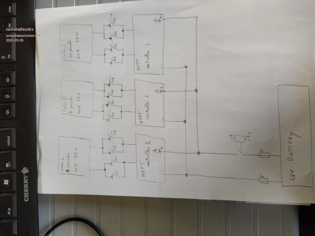

Thank you for the input, maybe a little sketch is helping the case.
So what I'm trying to achieve is something like this:
On the position of the switches I now have "AC" breakers.
Suggestion is to just use DC breakers at this position? Although I have included DC breakers in my mppt controllers. But the case need to be opened to reach them, maybe I need to redesign it a bit to have acces.

Posted: 07:13pm 08 Apr 2021
Davo- I appreciate you wanting to save money- but using AC breakers in a DC situation is an incredibly bad idea- you can get away with it- until the day you don't....
(and one day it will- for certain)
They can set up a self sustaining arc- which is then almost impossible to extinguish (often even reclosing them wont stop it)- and  you can easily start a fire thats almost impossible to extinguish as well- it will simply keep restarting until everything around it that is combustible-well- is combusted...
It's not as if DC breakers are that expensive or hard to find- get some and replace those AC ones- before you get a fire that takes out everything nearby....
