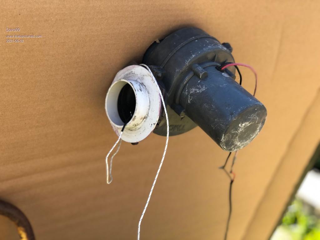

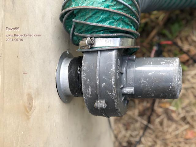

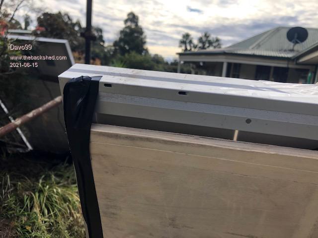

Inspired by Rogers Thread on heating with Evacuated tubes, I decided to give something a go that came up in the discussion, harvesting the heat from PV panels.
Seemed to me after all I learned from that thread that a and ordinary solar electric panel was just a big flat plate collector and it was shown they are also only around 20% efficient at making power so must be some good heat to be had.
I Pondered what to use for a backing which would not loose the heat from the panel and give accurate measurements of the heat generated. Being the exacting and scientific type that always like to do things to the highest standards possible, I spotted the cardboard box lying on the pile waiting for Council Clean up and thought Ripper, that's big enough so grabbed that.
Cut it to size with a stanley knife and without any skill or dexterity what so ever, Duckt Taped ( Note precision spelling!) to the back of a new 270W panel that was handily within reach. With Infinite wisdom, For once, I remembered to cut a little hole and pull the leads through before I taped the thing down and had to work out which end and where they were.
I then cut 5 Slots near the cable end of about 1 Cm wide and 10 or so cm long as inlets.  I grabbed the also handy ( where I had been playing with it before and hadn't put away in 3 weeks) 12 V Bilge blower.
It's a TMC that is rated at 90 CFM or for metric Minded, about 2.5 Cubic meters a minute.
I managed much to my surprise to hack a neat hole  near the other end of the panel and  secured it with a good push fit being careful to leave  some space for the air to pull in.
Sorry for the crappy pic, that's what happens when you go all modern and use a phine instead of the proper tool for the job.
All I did was put some cardboard on the back of a panel with slots on the bottom and a bilge blower sucking through the top. The voltage converter can be seen in the lower left of the poor quality Pic.  The slots are in the shadow at the bottom of the pic. I carefully worked them out with great detail and precision using complicated formulas in eyeballing them then hacking them out with a half sharp box cutter knife.

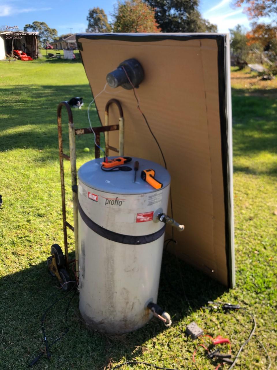

given the temp I was getting and the fact it didn't fall off, I think they may have been pretty close to the mark by some dumb luck.
I stood the panel up on another experiment I had finished with and yet to put away and felt the panel which was dead cold from lying face down on the grass.  Didn't seem to be warming up real fast in the 2Pm fading sun so I though not going to see much out of this.

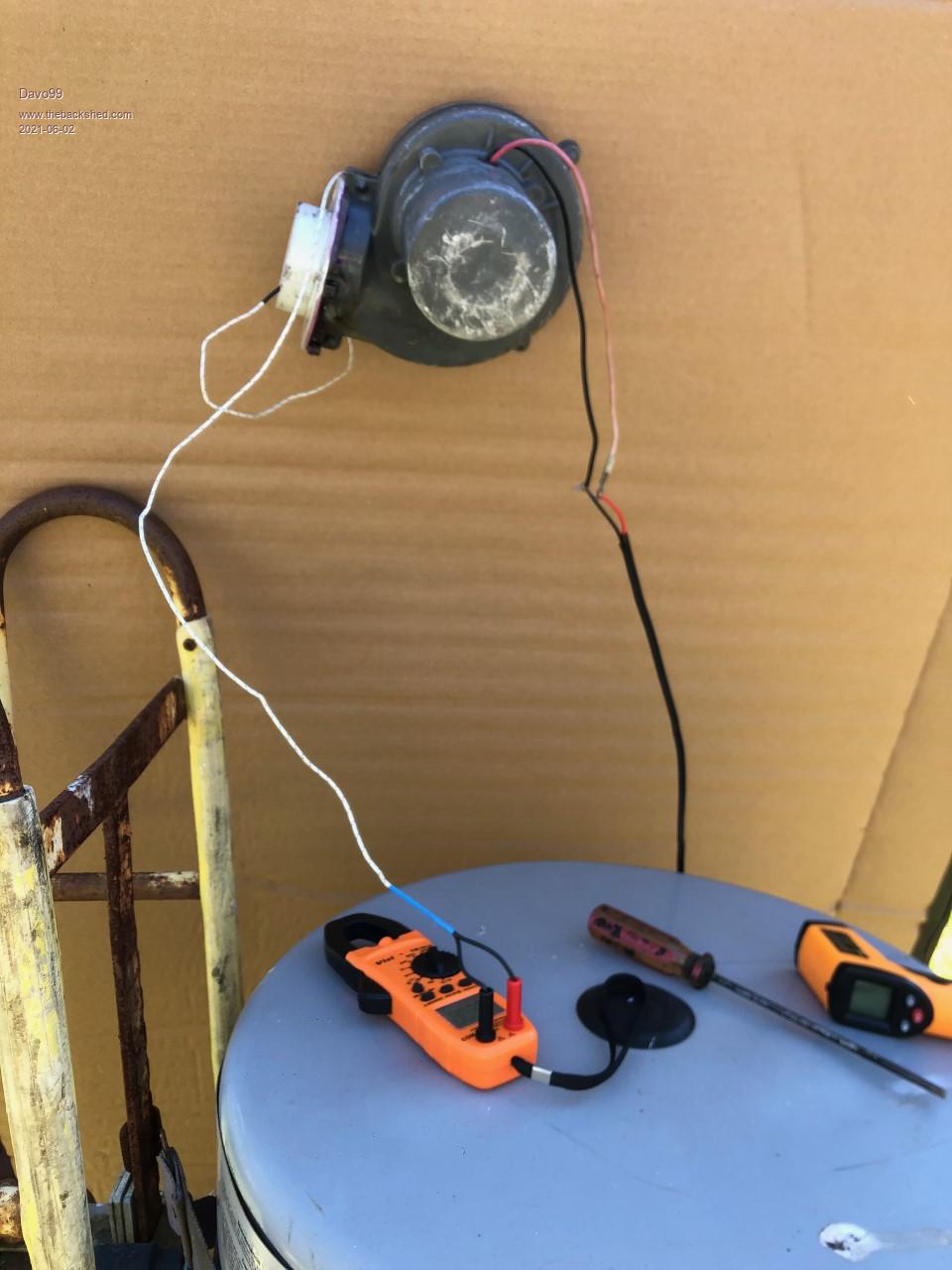

I jammed the wires from the blower into the panel leads and the thing ran like it was getting 30V so I disconnected it and went and got my little 20A 24>12V converter.
Took me 5 or so minutes to get some leads and a screwdriver etc and hook it all up.
By this time the panel had gained some surprising heat.  The temp gun said about 68oC.
I thought yeah, that's all good and well, that will soon cool off when the blower starts.
Fired it up and could tell straight away the heat coming out was significant.
I ran it a few minutes and the heat didn't seem to be dropping off so I ran off like an excited little girl and brought back my thermometer.
The ambient air temp in the shade was 19 oC. The air coming out of the blower was 34.
Confirmed this with the heat gun.
Ran the thing for a good 10 Min and it did not drop.  I measured the panel angle and found I had the thing standing at 76o and was off on the orientation to the sun a bit. I re aligned it and changed the angle to 62 o which I thought close enough and to my amazement, the temp went up to 38 C coming out the blower.
Got to say, I didn't see this happening! Right up till the time I started the blower I thought this is going to amount to nothing but, I have certainly changed my mind.
The panel face was sitting at around 67o and didn't really drop nor did the temp of the output. The cardboard backing was around 44O for some time but then fell to around 38 also.
After about 30 Min I went and got a 12V 55W Light bulb and put that across the converter output and it lit full bright without the fan speed dropping. I measured the Voltage and got 11.78 so I would say the fan was doing close to rated output.
I don't know the Precise CFM I was getting or how much energy that equated to but it was certainly enough for me to think that it was significant enough to do a proper build with this.  I would by guesstimate say the airflow was similar to that of a fan heater on high although the temp was obviously less.
By about 3 pm the big tree in the back yard was starting to cast shadows on the panel.  Thinking of my good friend Roger, I thought I'll watch this and see how this goes with the fall off in fan speed with the converter.  It audibly did fall off although the temp remained the same.  I thought I'll speed this up a bit and cover some of the panel.  It slowed the fan noticeably but to my surprise  yet again, the temp went up to 41. Considering the amount of panel I had shaded, even with the lower airflow I was not expecting that either.
This is the opposite of what I would have thought in the fan would over power the panel. Seems the efficiency of the panel ( and Tubes) to make heat is way ahead of a panel to make power. Maybe that should have been obvious given their relative efficiency's but when one is powering a 36W fan with a 270W panel.... I would have thought there was plenty of margin to push the equation the other way.  Seems not and I can see why Roger had much the same result with his tubes making heat before the fan kicked in.
I can say I am quite surprised by the results I got. Not what I would have thought at all.  As I said, No idea what the actual energy generation was but the result of my test left me feeling that it was certainly something worth while and that there was more energy to be had. There is still plenty of electrical energy that could be converted to heat if that is the primary goal or a lot of heat as a bonus for making power.

Measuring output temp.
Blower I bought a few years back for $20.  90 CFM, 12V, 3A.
It's a flange mount but I glued the white spigot on a few weeks back to use for providing combustion air to an Oil burner.  The flanges are for std PVC pipe so could be used on the back of each panel and connected together with T pieces  and pipe and one fan ( although maybe larger) used.

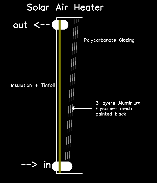

I have to admit, I have thought I should build a basic flywire collector to compare with mine in case I'm wasting all this time for nothing. I shall work out the best way to compare this and maybe give it a try.

Hey Dave, placing some sort of sealed boxes behind your panels seems a lot of work.
The most efficient cheap solar air heater you can easily make is a timber box made out of rough sawn 6 x 1 fence palings approx 1m x 2.4m. - to fit the corflute size, recess the back with corflute siliconed in around the edges and tinfoil glued inside to that. Extra insulation on the sides doesn't make much difference.
Run 3 layers of open mesh aluminum flyscreen door material painted black spaced 15mm apart on a slant, glaze with 1 - 1.5mm clear polycarbonate, >90% light transmission. Black polypropylene garden shade cloth works almost as well here.
150mm air ducts in at the bottom extended near the glazing and out  at the top on the other side of the mesh, couple of 120mm computer muffin fans in the inlet driven off a small 12v PV panel.
This setup will be >70% efficiency, you will be surprised at the amount of heat that it generates, if the sun is shining.
Mike

Interesting. I now get the use of the flyscreen, the air is drawn though it rather than over it. Clever. I was wondering why the design use screen instead of a solid collector?  You diagram cleared that up.
Mike you are obviously an expert on this, do you have any links to charts or input as to what the expected output of such a setup might be?
I calculate for the area of the collector using 400W as the Sydney winter insolation and the 70% efficiency you state, this should give about 672w of thermal energy. Dies that agree with your thoughts?
