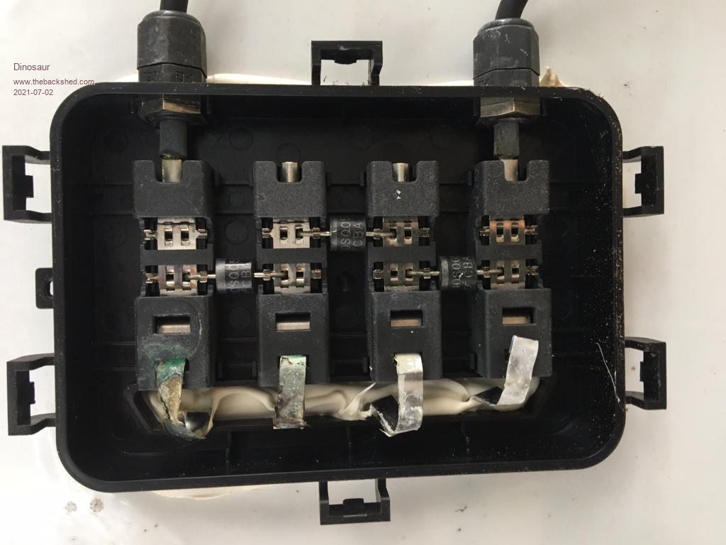

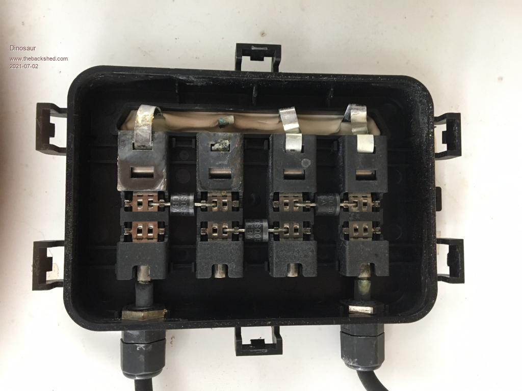

After a recent trip in the van discovered a loss of solar charging (about 1/2).
Finally got to pivot the panels up and open the connection boxes underneath.
Photo's show burned out (or corroded) fuse links.
There didn't appear to be any water marks in the lid and the lid has a very good seal.
The panels are SPM-ST-200W, VOC = 45.63V Max Power current 5.27A.
I have 4 of these with 2 each in series. The two panels that failed are in series
with each other.
The tops of the panels look in good condition, no cracks or signs of corrosion on the cell tracks.
On one of the units that failed, the white plastic sheet under the panels showed bubbles. Perhaps that means water got in from the top ??
These are 72 cell panels and not that popular these days, so will probably replace them with 250 Watt panels.
Anyone have any ideas on the reason of the failure.?
Haven't had a chance to check the diodes yet.

Could be a lot of things but with the lookup I just did on the manufacturer, the likelihood seems they were just crap panels to begin with.
Couldn't find those ones specifically but seems the same brand was brought in by an ebay seller as well as a now defunct solar company way back in 2012.
Unless the things were standing in water and for a considerable time. They should never get water bubbles. My guess is the next thing would be scorch marks where the tracks in the panels burnt though. Seen that a few times. There is some green in the junction boxes which to me says Moisture but I doubt that's the whole story.
How were they wired? Were they 2x2  to different controllers or series/ Parallel all together? Looks like they have had a lot of current going through them.
Personally, wouldn't worry about them too much.

The green is "verdigris"
Look to that point for the failure reason and obviously its water ingress . Clean that up and continue . Everything else will be fine.

Hi Dinosaur, if they were mine I would clean up the connections and repair them.
Seems that water got in and corroded the copper straps.
I may be a cheapskate but I would just repair them and see how long they last.
I would suggest also covering the connecting straps in a waterproofing agent such as battery terminal corrosion inhibitor.

As the solar cells appear perfect, I may just do as suggested.
