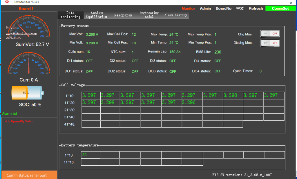

After many attempts at trying different wake up methods, most of which would wake up the BMS still did not turn on the mosfets, connected to the BMS with the PC software and could see in the bottom left corner a small message in red.......I guess that's the answer.

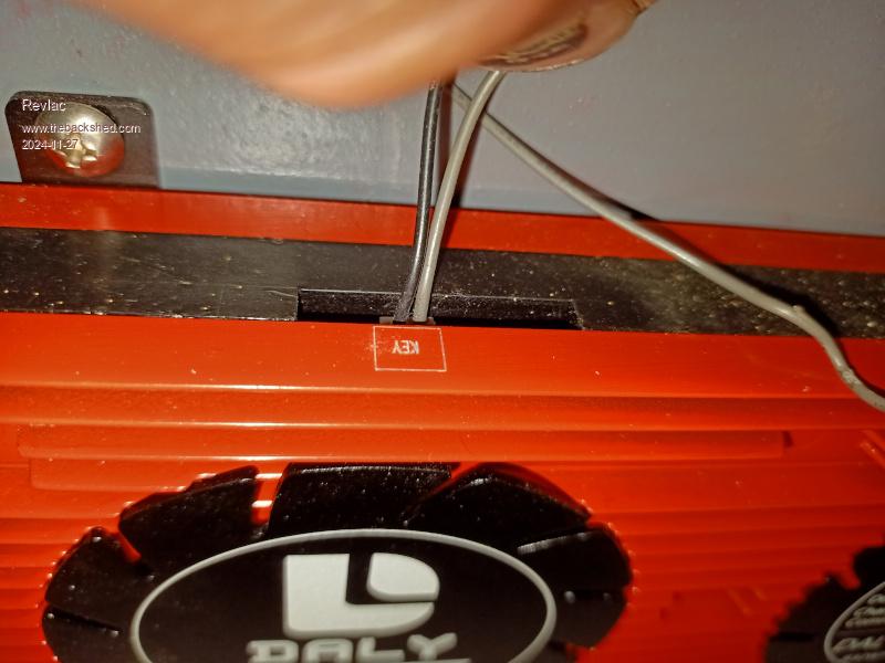

So I tried the 2 pins by shorting them with a switch and the mosfets switch on, but it want the switch to remain on or the fets will switch off again.....why they change this?

How did you go with this, option  D01 can be turned on or off, which from memory might be the MOS control ??  Strange that it was on by default, I think there is also an option to change the polarity of the pin link - pin shorted = on or off, but it's not on the PC software?
That latest version of BmsMonitor does not have the button to clear the diagnostic data memory which, is dumb? Loaded the older SW version and cleared it correctly.
BTW diagnostic memory is only available on the more expensive BMS.

The switch port, sometimes this is unmarked and in different locations on other versions of BMS they just love to keep changing things.

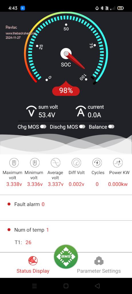

Ok the BMS will wake up easily, thought it good to show a pic of it on the Phone APP, can see the fets turned off.

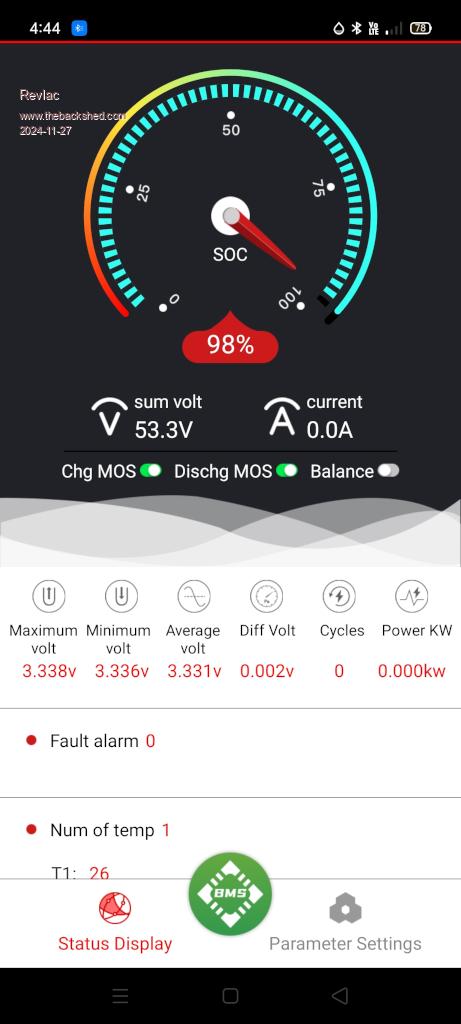

And now with the switch turned on, the green toggle's showing the fets on, still don't know if the BMS will do exactly as it supposed to, will have to test it with an over voltage cell trigger and see if the chg moss switches off.
I have to get the other BMS tool on the new laptop computer and find those settings, still not sure weather to change the switch option or use it this way, it would be good for a caravan or something very easy to isolate the batteries from the rest of the system, although startup procedure would have to be followed for the inverter and charge controller hope no one forgets it.
