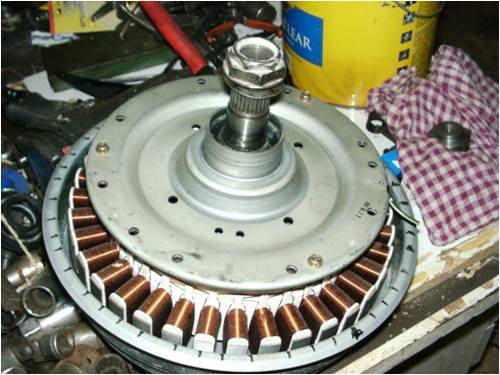

I have been looking at one of these http://cgi.ebay.com/ws/eBayISAPI.dll?ViewItem&item=180592542 976 Anyone familiar with these? Comments etc?
MY EXPERIENCE WITH WIND TURBINES FROM FLEABAY IS THAT YOU NEED TO DO A BIT OF WORK TO SORT THEM OUT AS BEARINGS ARE NOT ALWAYS THE BEST, AND THE ELECTRONICS IS GENERALLY HOPELESS ON THE CHEAPER ONES.
I WOULD SUGGEST YOU CONTACT PHILLM ON THE FORUM TO GET YOU GOING AS HE HAS BASIC MILLS AND BLADES FOR DIY.
MY NEXT PROJECT IS A LG MOTOR CONVERSION SO THAT IS WORTH A LOOK
MY AIM IS TO MAKE A MILL FOR $300 SO IS AROUND YOUR BUDGET PRICE.

I get your point on the turbines, but be aware that you will need to do a bit of work on them to get a reliable machine, bearings are suspect, regulators are unreliable and blades need a lot of work, in my experience anyway. The little mill I got from Phill was at a reasonable price for the whole lot and if run as intended 500 watts in star would be a real winner. It is small and if painted duck egg blue it would nearly disappear into the skyline.
