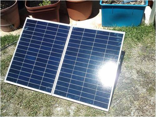

got some camping panels (trick -back contact 21%+ efficient)120W for 1m x 700mm

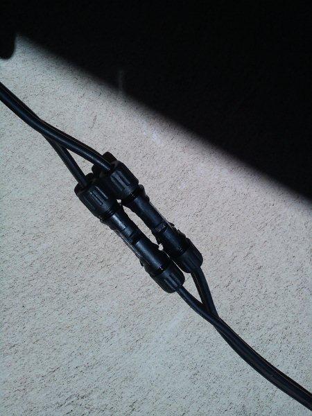

Utilised some thrown away connections and cable to connect.

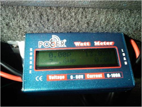

Watts up $35 from EV power measures exactly how much things use/input.

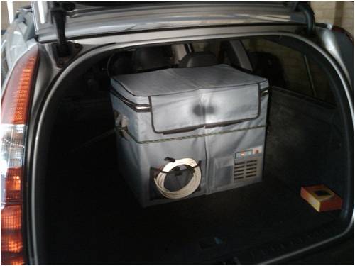

Fridge is mmmm HUGE at 55L capacity and works really well even in the steaming hot car.
Aussie Direct $650 beats the hell out of Engell at 3x the price sawafuji swing motor or not!
next is the LIfePO4 60AH battery as missus wants to be able to leave the lot for road trips (will get a cable/siren lock for $60 too)
Oh and for those of you who reckon it takes up most of the boot, you're right!

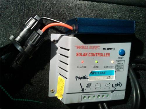

Re the MPPT controller, I got the same and tested it - it does no MPPT (more current out than in from the regulator) but it works very well as a multi stage regulator on my sailboat.

Perhaps yours is a dud, when did you test it -if hot no surprises you didnt seem much different.
I had panel inside, 22degrees, put into the sun get 17V from panel to reg and 12.8V to battery.
give it 10 minutes when the panel has heated up and more like 14V from the panel
and 13.2V in the battery.
Voltage drop is fairly typical of all panels -ie derating due to temp.
Next weekend advise pending, i'll connect the panels as 24V and see what happens
looks like spec allows for upto 40V input, this would obviously halve the wiring losses. dont want to blow it up for the sake of 5W though.
here are pertinant specs
Technical Index:
1. Model:WS-MPPT15
2. Rated Voltage:12V/24V
3. Max load current:15A
4. Input Voltage:12V~40V/24V~80V
hence guessing that the panel in 24V mode will be OK.
I'm waiting on Val to get back to me first.

Re the little MPPT, I measured Amps in and out as well as voltage across it. Compared that to a 'real' MPPT (60A job) that charges the house battery bank.
There was no difference on both input & output Amp meters with the Wellsee from a 64W amorphous panel, hot or cold. Voltage across the unit looks just like what one expects from a regulator, not the big difference seen with the big MPPT.
There is always about 3A difference between in/out charge from the 420W panel (2 x 210W Sunpower, 24V) on the tracker on the shed roof, no matter what the time of the day or panel temperature.
I conclude the Wellsee is no MPPT but found it is a good regulator for the boat panels to charge the batteries which feed the boat fridge & the beer cold
BTW, the heat sinking arrangement inside my Wellsee was poor, fixed that.

to be honest i'm not that surprised
you're thinking -probably right too
is that the voltage drop across the controller is simply a function of
its resistance and PWM charging circuit.
re the heatsinking i'll have a look at that!
