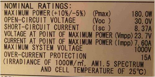

going by the panels specs the mpp 23.7v (see below)
Q: 16 panels in series would be safe (16 X 23.7Volt = 379.20 mpp volts)
Q: max voltage would be max open voltage of 30v x 16panels= 480volts

OK limiting factor is the VOC
aim for panel voltage max VOC x 1.2 to be under the 500V
EG the panels you have with VOC of 30 V
15 would be 15 x 30 X 1.2 =540V BANG!

your panels at 7.6A normally would run max 2 strings of 13 panels
=26 x 180W = 4680W. for realistic output multiply by 0.8

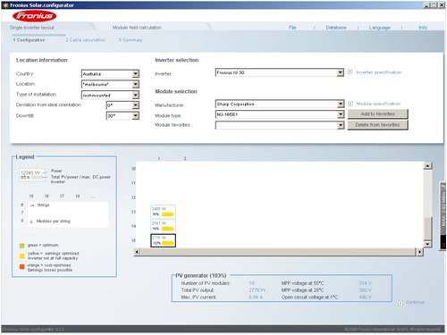

ok i actually have put them last week, 15 in series.....
the highest voltage from the panels on a nice 20 degree cloud "edge" midday effect day was 394v and the peak watts was 2792.
you say a VOC factor of 1.2 (30 * 15 * 1.2= 540v =bang!)
i used the fronius configuration tool imputing all the bits it wanted (including my
actual sharp models) and it came back at 15 panels. as the perfect match to the IG30
Also noted a spec sheet for the panels said the max VOC of 30.2v was at 1 degree

Given their own design tool says its OK, then I guess its OK
