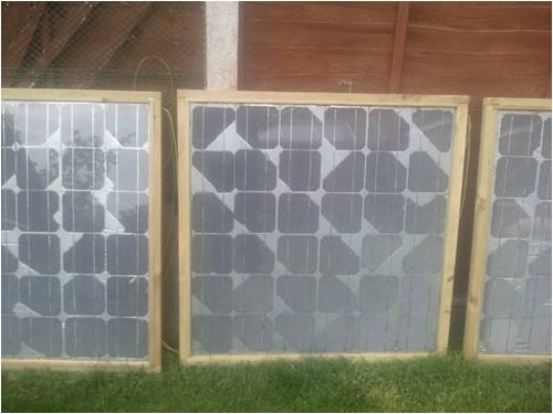

ALL like some help please grid tie inverters just got 2 kg of damaged cells and put 5 panels together look not to bad for a experiment all panels have 36 cells put out about 20 21 v no lode.
Looking for tips how many panels to an inverter how to test so i don’t over lode thing like that in a newbe but starting to pick thing up just looking for advice please

The cells would be good to play with for small projects but not much use on the inverter you have ordered as this inverter will hardly cut in on these cells as the voltage under load will sag to a point to low to drive the inverter. I have one of these units and to get any sort of output it needs to be on e 24 volt system with panel rating of 600 watts plus to get 500 watts to the grid. On your panels it would have a hard time synchronizing with the mains. They are only efficient above 24 volts and as it comes back to 14 volts it is useless. Just enough power to flash the led indicator.

Hi thanks for the info i can lift the pannel voltage just by adding a half pannel or hook 2 up together the inverter is 14 to 28 v the pannels put out a good 14-15 v when pulling 6 ammps that is only 4 pannels i will have about 14 pannels when compleate i can boost the power by adding cells as they give out a good .62 volt
just need to know some of the pit falls as very new to this i can buld any size / voltage pannel i need just need some pratice and a lot of mentoring
