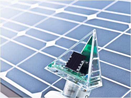

this is my all time favorite mainly cos it looks so fricken cool!
its called the DEGERconecter and I have never seen one for sale so I assume that it can only be bought as part of a tracker array kit. they call it a maximum light detection tetrahedron DEGERconecter

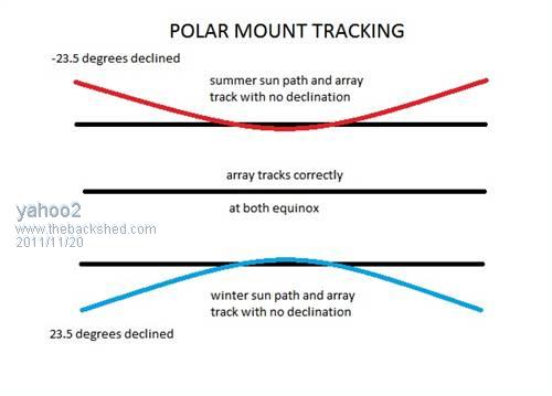

the " follow the sun " axis is called Right Ascension.
You have built something pretty cool here, basically two trackers in one. when you decide to go dual axis you will have to decide to lock one or the other depending on what you chose.
The standard small tracker would lock the azimuth turntable (brake drum)at true north and use the elevation and right ascension.
Big arrays 10kw + usually lock the right ascension pointing straight up and use elevation and the azimuth turntable, mainly for strength and wind loading.
at your latitude you could set the elevation seasonally and make a fair fist of following the sun with an actuator on the right ascension OR a slew ring on the turntable. Solar panels can handle a fair bit of incorrect angle before the power rolls off significantly.
Both methods have downsides.Both can use light sensor tracking or some complex electronics to trace the suns path.
There is a third option and that is to make it a true polar tracker, that would mean a bit more fabrication. But then it will track the suns path very closely with one motor and some seasonal adjustment and fairly simple electronics.
It is hard to describe,weld the turntable at true north, then you lock the elevation to suit your latitude suns angle on the equinox 20th of March and 23rd of September (these are the days that it will track a straight line across the sky)then fabricate a elevation axis ABOVE the right ascension axis that only moves the panel angle 23.5 degrees up and 23.5 degrees down for seasonal correction. This makes the panels trace a curve across the sky. This is called declination. The big advantage is a constant 15 degrees per hour (of right ascension) is all that is needed to trace the suns path, the declination motor only moves once per day to change the curve.
I have done a diagram that shows a where a standard single axis tracker (with seasonal elevation adjustment)loses the sun, its mornings and afternoons. You might get the concept quicker than I did. I was trying to track inclined orbit satellites, it is a bit like catching mosquito's in the dark I could tell I missed but that was about it.
the summer and winter sun is the coloured lines. Standing facing north and looking up.
