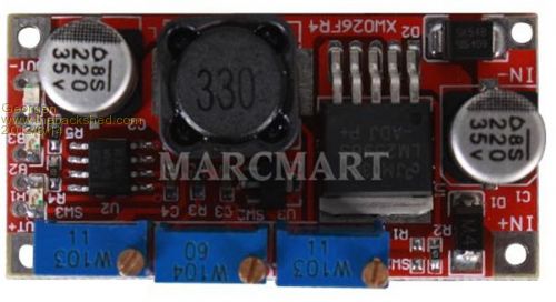

Posted: 07:46pm 13 Jun 2012
Noticed on E-Bay this device:
5-35V LM2596 DC-DC Stepdown Adjust Power Supply Module f battery LED solar panel
It has 3 adjustments, 2 of them understand, one is V-volts second one is A-amps,
Cannot work out what is 3-rd adjustment for?
Picture copy from E-Bay

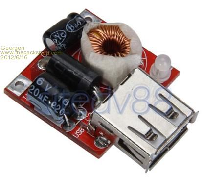

Posted: 05:15pm 15 Jun 2012
If I understand it right, I could be able to charge my 3.6V batteries
setting output to say 3.7V and limit curerent to 50mA or 100mA (will have to check out)
Also I could charge GPS, setting another one of those to 5V and correct current
For USB charge I noticed device on E-Bay specifically for USB application
pre-set to 800mA
Picture copied form E-Bay
Is it correct assumption?Edited by Georgen 2012-06-17
