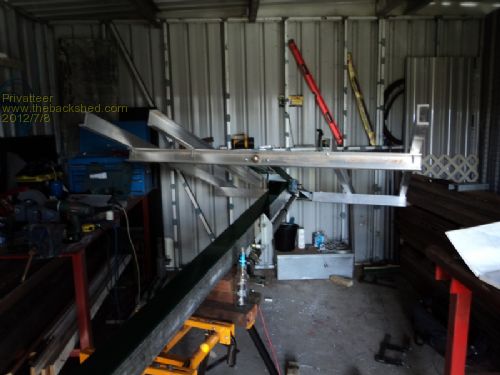

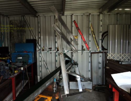

I am honest enough to admit I made a mistake and deviated from my original plan.
Due to the available aluminum lengths being 5.5m not 6m I shortened my center pivot to make the 2 inside supports reach one side of the panel. One of those inside supports also picks up the attachment for the east/west actuator.
As you can see I now have far more travel on the North/South than I can use due to the East West arm hitting the main pole.
So now I need to work out the compromise of vertical angle vs East/West for this unit.
Location is 33° 21' South and if I have worked it out correctly the sun is about 35deg at this time of year from horizon.
N/S arm currently can go from about 10deg from vertical to horizontal.
Any calculators I can use to make it easy to compare the different angles and production estimates??
The heavy design is due to intermittent winds I get. North side is facing up.Edited by Privatteer 2012-07-09

I realised that I was looking at a similar restriction when designing. My solution was to put the pole on a rotating base. I now have (theoretically) 360 deg. azimuth rotation (east/west) and 15 - to 150 deg. tilt. (The extension beyond the horizontal is simply to allow the array to be 'flipped over' for cleaning access of the top panels.)
