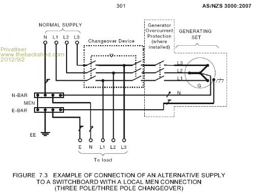

Posted: 05:37am 02 Sep 2012
Glenn,
Actually I think the listing of structural metal would cover things like the dog fence.
I thinking this over today. I also got a draft copy of the solar AS/NZS 5033 to try to get some ideas.
While there are a number of clauses that cover outbuildings and so forth the 5.5.3.1 makes things very difficult if you have metal water pipes etc.
It sounds silly but the safest method I can think of is to actually run the supply from the inverter direct back to the main switchboard and have one MEN only. The issue then is a second cable being required for the lights/gpo in the shed if needed.
I might ask the question on a different forum to see if there has been any clarifications on the matter given to solar installers.
I am assuming you do have mains power, don't think thats been mentioned?
A full standalone would be easy. Just put the MEN in the shed and not have one at the house.

The below pic is the best answer I could give.

As per the diagram above that is correct to my understanding as well, it might be said that BOTH earth and neutral from the inverter should share ONE common connection each, and when you factor in using one or more RCD's within the wiring circuits then the neutral will need to be via a common supply.
Only the active should be switched (this might be different in the US where 2 phases are used (VAC 220) and no neutral)
I see no problem with a separate earth from the chassis of the inverter to its own earth stake as long as the chassis is not connected to the mains earth, this is actually requested in some inverter manuals.
