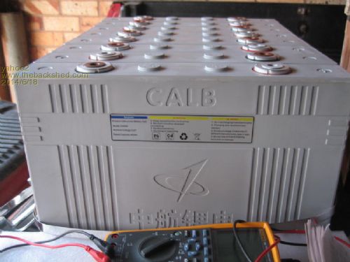

After talking about it and thinking about it for close to 4 years I have finally got my hands on a LiFePo4 to install. Ive got a feeling it wont be the last!
Its a 24volt 400Ah bank. This photo is just before I fired up the banding tool and clamped the cells together.
The cell voltages averaged 3.2908 volts out of the box with the highest at 3.2933V and the lowest 3.2889V. I couldn't make a decision about how to charge and balance them before I get to the installation stage. I thought they were close enough that I didn't need to wire them parallel for an initial balance before I started.
Originally I was going to charge each cell individually with a Revolectrix Cellpro Powerlab 8(V2).
In the end I decided against it as I was keen to see what the charge curve would look like with a standard charger.
I temporarily assembled the pack and bulk charged it to 27.6 volts (roughly 3.45 volts per cell) making sure that all the cells were under 3.6 volts and the shunt modules had not triggered. I had a 12 volt spotlight standing by that I could use to drain some power from a cell if the voltage got too high and it started to shunt power but happily I didn't need to use it.

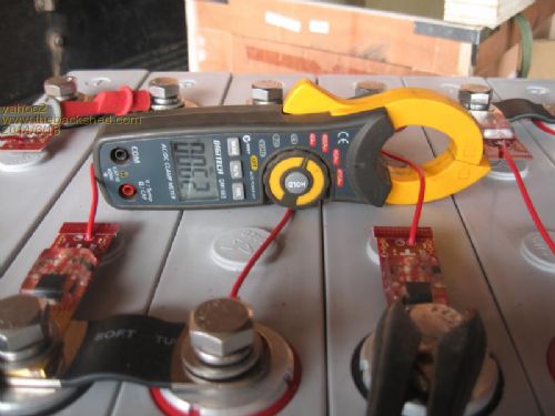

Then I split the bank in half and charged it with 2 smaller 12 volt chargers that would cut out at 14.4 volts and not overload any of the 2 amp cell shunts in the process. Need to be cautious because I have not wired the Battery Control Unit in at this stage so there is no protection for a over volt cell other than the 2 amp shunt.
With each half of the pack getting close to 14.4 volts, four of the cell modules triggered at 3.6 volts and started to balance those cells.
This one bypassed the most at 0.6 amps for about 10 minutes. the others were less than 0.2 amps for less than 5 minutes. A bit of an anticlimax in the end, I was expecting to have to work a bit harder than that.
At the end of all of this the pack has taken a total of 281 Amps, that's about 100amps more than I expected, as I was advised that they come 50% to 60% charged when you get them.

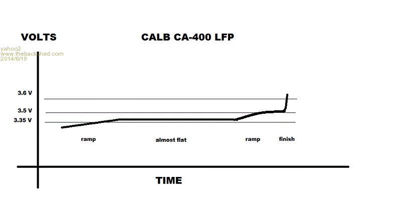

One of the things the more observant of you may have already noticed (if you dusted of a calculator) is the higher voltage we are dealing with here.
I will convert the volts to 4 cells so I can compare it to 6 cells 12 volt of wet lead acid (WLA). (cell volts in brackets)
nominal volts for LFP (3.2V) 12.8 volt
state of charge delivered was 30% @ 3.29 volts/cell for the LFP's
30% SOC
CALB LFP(3.29) 13.16 volts
WLA____(1.96) 11.75 volts
One thing I noticed while charging is the curve has two distinct ramps and two sections that are almost flat.
At one point one of my multimeters was not capable of measuring the cell voltage rise, the other one was ticking over at one ten thousandths of a volt every two and a half minutes, that is almost billiard table flat. The voltage rise is very rapid at the finish, even with the tiny chargers hooked up it was going up at one mV every 2 seconds.
This looks to be a distinctive characteristic of charging the CALB cells at less than 25% of their capacity.
Edited by yahoo2 2014-06-20

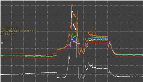

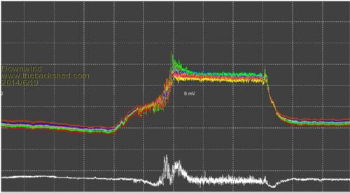

Recording a pack voltage only tells a small part of the overall view, i would say almost useless information,
To log and plot each cell will be a tell all of what the pack is doing.
You have some dinky device on each cell to control the max voltage, Is it actuactually doing what you expect it to do, or is it doing what it wants to do.
Untill you log each cell then its pointless in posting pack voltage curves, they tell nothing, as the important part is when the cells reach full charge (in the mV range)and how the cell controllers work at that point.
Lets look at a log plot of the equalizer off for a period in the day.
As you can see how far each cell (coloured line) becomes seperated from each other.
Then we look at a day with the equalizers on and how each cell follows the other.
As you can see there is a big difference to each cell, and its up in the Mv range and not down in the general bulk charge range that matters.
Pete

The shape of the bulk charge curve is just my observation of what happened, I recall someone telling me a few years ago it was some sort of gassing and re-absorption that caused it. What it does show, is that for a large part of the batteries capacity measuring the voltage would give no reliable indication of the state of charge.
Any sort of capacity meter will have to be counting amps (or coulombs).
I took a guess at how much charge these would take, based on some old thundersky data I had and the voltage, I was out by 100 amps. I started to think some ninjas or bunyips had been sneaking in and switching my charger off while I wasn't there .
The manufacturer says these cells are regarded as fully charged at 3.50 volts, so yes Pete, it wasn't till I got above this point (plus some mV for charging resistance)that I started to see any useful spread of voltage between the cells.
Even then, with new cells it was tiny.

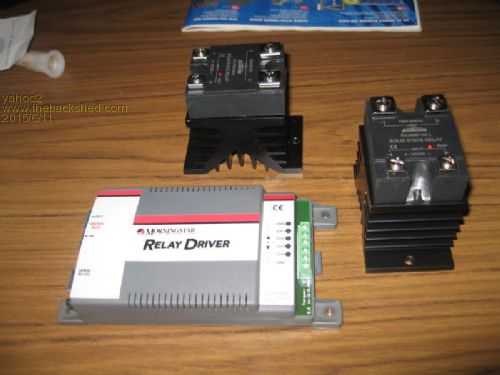

I purchased a high power schottky diode pair with a common cathode and put that in series with the positive lead to the LYP battery bank.
Each diode is normally shorted out by the contacts of a latching relay (mine have 80A contacts). The latching relay are operated by the BMS, one opens at over voltage and the other at under voltage.
The diodes ensure that if, say, under voltage trips, charge can still flow into the bank but nothing out until the bank voltage has risen sufficiently.
