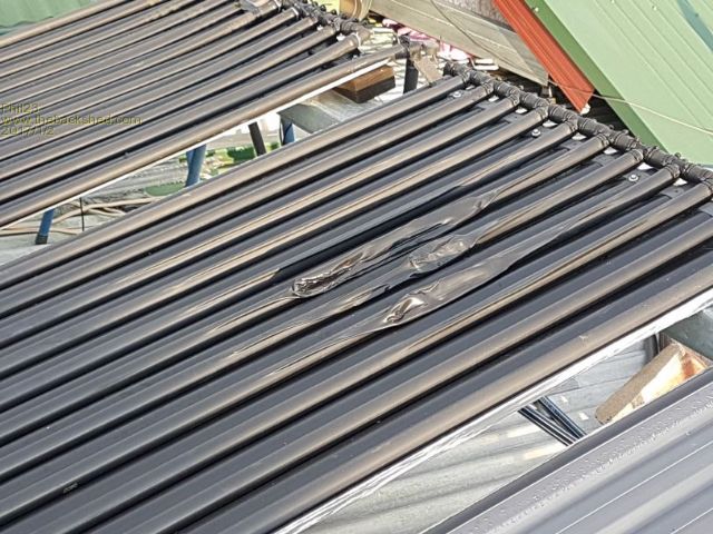

kicked the circulation pump in & checked for leaks on the roof & found one to have sprung a few leaks.

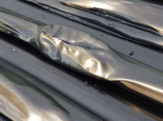

3 of the pipes had literally melted & burst, little hard to understand given they have been up for so long, and have endured hotter weather.

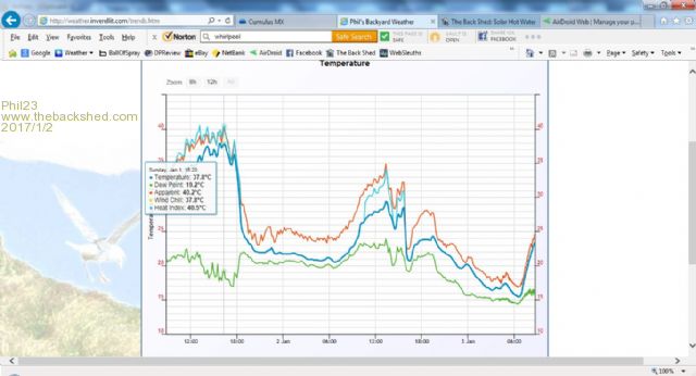

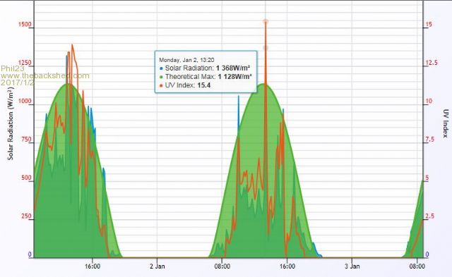

Main thing of interest is the data from my weather station, which shows unusual extremes in Solar Radiation & UV indexes.

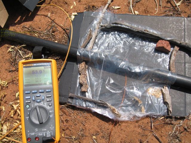

that is quite common with exposed poly pipe. it is caused by the water being stationary, hot and under pressure in the pipe.
for example a pipe can be rated for a 100 year life at 150 psi below 30C and 6-12 months at 70 psi at above 70C.
I took this pic on a mild spring slightly breezy morning, when the wind dropped the pipe got to 64.7C with the air temp at 25C, there is a good possibility your pipe could get well into the 90C+ range on a summers day.
PS that is inch rural B class poly not garden pipe.Edited by yahoo2 2017-01-04

The other thing is that several of pipes now have west facing ribs on them, you can sort of make them out in the first pic.
They are basically below the radius on the poly carb sheet where the angled part meets the flat top surface, almost as if the radius of the bend acted as a lens.
Strangely though, the third panel, just visible in the right lower corner of the pic, shows no sign of overheating.
Other thing is it was a broken cloudy day, bight have been extra reflection from the clouds, as on the hottest & clearest days we've hade the weather station showed only a bit over 1100w/m2.
Averages for the day, shown under the curve are not that extreme really, considering what we've had a few weeks earlier.
