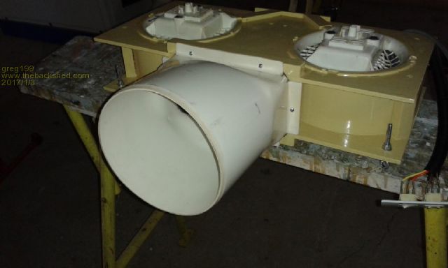

I've re built a 240V range hood exhaust fan system to exhaust the hot air from my shed ceiling space. This is it:
It has three different speeds and draws up to 200W. I'm considering buying a solar panel of about 250W, attach it directly to a suitable (inexpensive) inverter (12V DC to 240V AC) and run the exhaust fan directly from the inverter. It would only be used when it is hot and I could simply leave it ON all the time. Whenever the sun is heating up the shed it will also run the fan. Seems simple conceptually.
Three questions:
(1) will it work?
(2) any suggestion for an inverter that would do the job reliably (and without setting fire to the shed in my absence) ?
(2) I'm guessing the inverter may lose about 10% of its input wattage in the conversion. Is this about right?

Being that they are probably induction motors, you will probably want Pure Sine Wave.
300W may do it but 600 would be safer.
I've got a Projecta 600W for camping, Link, and have tried it on the freezer outside, 300l, and about 200-300 watts & it can't swing the compressor for startup; pulls the battery too low & causes an alarm state.
The induction motors should have an easier start-up though.
Are you intending to include a battery & some sort of charge regulator, as I'd expect the inverter will expect something like 12.2 to 14v & without a battery, current available could be all over the place.
Curious about the physical sizing & flow rates. 200mm fans?

Why not a pair of 12v dc radiator cooling fans ?Edited by Warpspeed 2017-01-04

  Warpspeed said   Just curious.
Hmmm,
They may not suit well to ducting & hose friction, but in certain situations they might be good.
Did just Google a Honda Civic one that was tested at 9.5 Amps.
Personally, I'm using a 200mm duct fan that uses 100W on high & moves 830m³ per hour.
Phil.
Posted: 12:03pm 03 Jan 2017
I think a 12v radiator cooling fan would be a much better match for a solar panel.
It might be rather interesting to do a comparison.
What worries me about running an inverter and an induction motor, is that it will probably work perfectly well in a clear blue sky, but what about hot cloudy days ?
The inverter must work at full frequency and output voltage, it cannot decide to run at 25Hz and 90 volts output if dc input power is very low.
However, a car radiator fan should still work pretty well with low dc input voltage, just a bit slow, but it will still flow some air.
Much less to go wrong too.

greg199
Joined: 03/11/2015
Posts: 39
Posted: 12:55pm 03 Jan 2017
... because I don't have any but I did have the range hood exhaust fans.
I don't have any way of measuring the air flow rate but they seemed to be pretty powerful for their size. After all, they are designed to exhaust air.
No, I did not plan to attach a battery and regulator. That would just add extra (and maybe unnecessary) cost and complication.
I'm keeping it real simple at the moment and wondered if any one else had tried a direct connection between solar panel, inverter and fan. It does not matter if it is not efficient since exhausting any hot air is better than nothing.
If the sun isn't shining and I'm desperate then I can simply plug the fan unit into the existing mains power (as I do now).

  greg199 said  No, I did not plan to attach a battery and regulator. That would just add extra (and maybe unnecessary) cost and complication.
Haven't tried that, but have a sneaking suspicion that it won't work due to the current inrush when the inverter charges it's caps at startup.
Considering you already have the fan unit, I'd be thinking that about a 20A solar charge reg will be required & something basic for a battery load.
Don't think it will work with just an inverter connected to a panel.

Wouldn't suggest connecting the inverter direct to the panel without a battery, I have a 600w and a 2400w both sitting on my workbench needing repairs after I blew them up doing exactly that (by mistake)
Was camping, was using alligator clips to connect to the battery, had the inverter alligator clips clamped to the panel ones, people tripped over leads and pull them off the battery and bang- inverter stops working
Both have the same symptoms, caps still charge when connected to battery, led comes on when turned on, internal fuses ok but no 240v
I'm assuming either mosfets or driver circuits blown, haven't had time to do a full diagnostic on them yet tho

My 12VDC 2500W Mishto inverter has over voltage protection of 15-16V. I thought this would mean it would shut down whenever the input voltage exceeds roughly 15 or 16V. Is this thinking incorrect?
Does it really mean that the inverter will shut down ONLY if the high voltage input is between 15 and 16V and that anything over 16V may cause damage (as in your case)?
Boppa
Joined: 08/11/2016
Posts: 816
Posted: 05:19pm 06 Jan 2017
I suspect that the overvoltage is designed to shut down and protect the inverter against slight overvolts, but my panels without a battery hit nearly 20v and I suspect that it simply wasn't designed to clamp voltages that high,most O.V. circuits are a crowbar, that will basically lower the voltage the circuitry sees, but only by a certain amount (so adding say 2v drop from 16v to 14v will still leave the circuit in safe voltage territory, but that same 2v drop from say 20v is simply still too high, letting out the magic smoke
I'm still on holidays atm, so until i get back home, I cant actually open them up and see whats broken- I suspect either all the mosfets have blown or the driver circuit- the power led lights up, but that's all that happens
Time to buy another tin of smoke :-(
One possible solution is to use a cheap solar reg (I bought one for my cars solarpanels, cost about $60), get a `stuffed' car battery from the local garage (just to act as a load) and simply let the inverters undervolts turn the fans on and off (the fans would run for a short while on the battery in the evening until it went flat) and wouldnt turn on until the panels had put a small charge into the battery in the morning, once the battery voltage rises back up again, most of the cheap inverters will turn themselves back on, starting the fans back up
Only drawback is most of these inverters have a buzzer that goes off when the undervolts goes off, so it buzzes all night until the panel brings the battery back up again (its often easy to disable the buzzer tho)
Another advantage of using a small capacity `dead' battery would be that intermittently cloudy weather, the fans wouldn't cycle as much as clouds cover then uncover the sun
