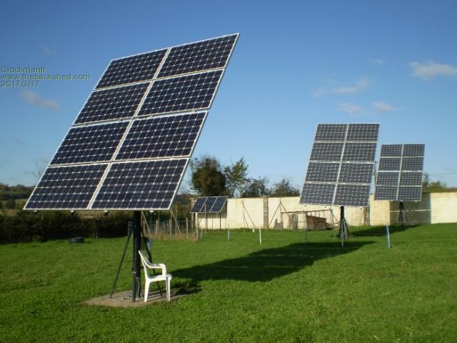

Cost effectiveness.....
The best I can do with a 2kW Solar PV Tracker is $800 cost for materials for the tracker itself, includes ..... Actuator arm,.... control electronics, (Dave in NSW)........ metal and base concrete.
Any bigger surface area of PV than 2kW, then your pushing Wind stress with this particular design to its limits.
This photo shows at about midday setting on one axis, and set for Winter setting on the other axis.
These of mine have coped with hurricane conditions.
See........ http://www.echorenovate.com/purchase-book---make-a-2kw-solar-tracker.php

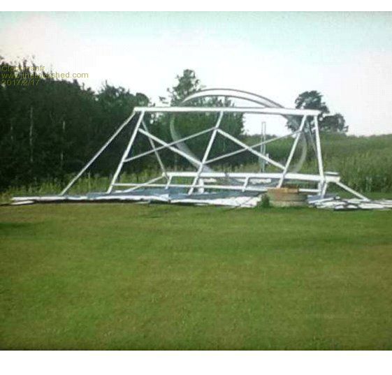

The below photo is a normal standard rotating design, this one is a 10kW in US, (not mine) looks good... then severe gusting and WHOOPs
