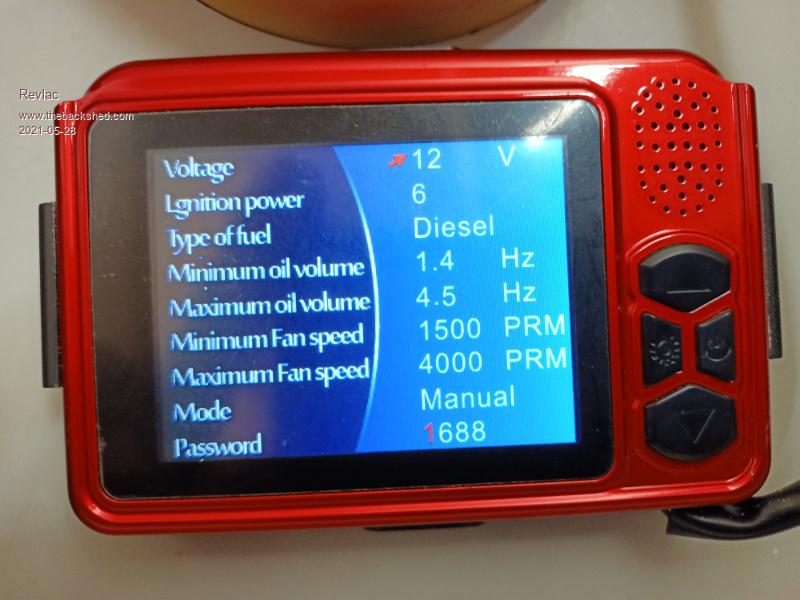

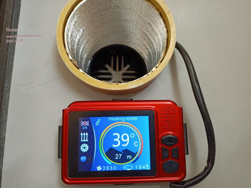

Have a photo of the screen and settings, looks like The control unit has a temp sensor in it, and is too close to the heat outlet.

  Quote  Have a photo of the screen and settings, looks like The control unit has a temp sensor in it, and is too close to the heat outlet.
Mine has the temp readout in it too but pretty optimistic. Sometimes it's out by 5o.
Must want you to think it's doing a better job than it is.  I have just been running mine in manual Mode. Never going to get the temp up much where I have mine, happy for it just not to let the place get too cold.
I think these are brilliant little units for what they are designed for and well beyond as many people are adapting them for.  No, they aren't new being knockoffs but  they are now affordable to everyone rather than being a major purchase like the originals.  They are  from all I have seen interchangeable  with the originals and despite their Tightarse Chineseness, They seem to be reliable  and durable enough.
