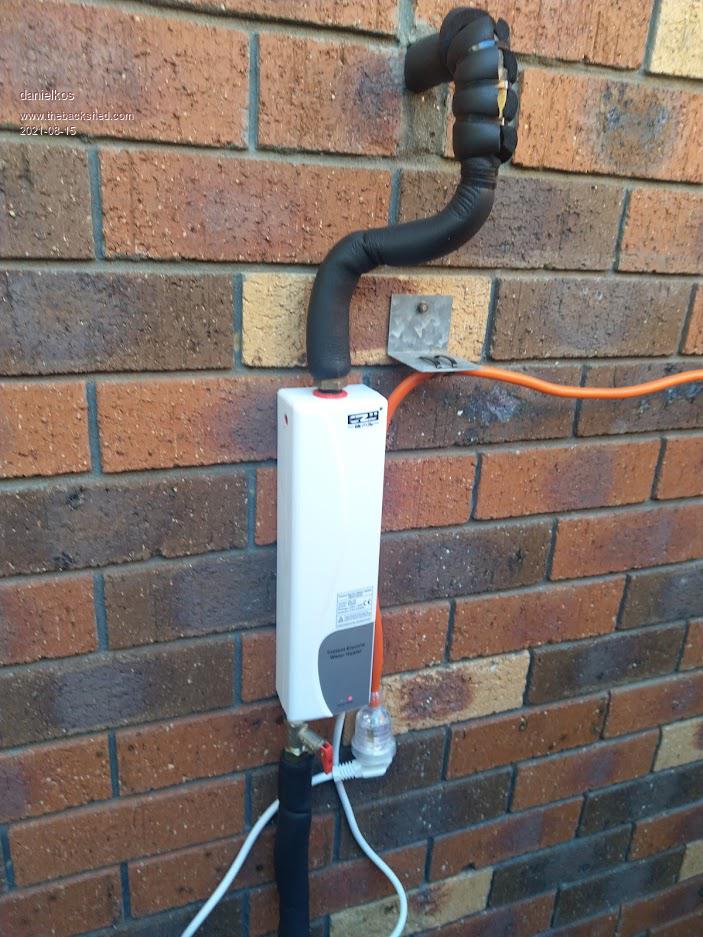

Earlier this year (during lockdown no less) my old Rheem gas 135L storage hot water service exploded into a million pieces so I had to do something to get my non-cold showers back. This is in a Melbourne climate where our hot water systems are mounted outside against on the side of the house.
I've often felt like we're spoiled in the modern age and having a big tank of water maintained at 70 degrees 24 hours a day is probably excess to what we need to be happy in life. But all the instant gas systems on the market are overkill too! I didn't want to upgrade my gas main to be able to run a 26L/min continuous flow system. What the hell am I supposed to do with a 26L/min flow rate through my hot water pipes? Can my plumbing even handle that much?
I ended up getting the cheapest possible instant electric water heater by express post via eBay. I removed my old system and hooked it up to the existing plumbing connections using flexible hoses at first, but later I was happy enough that I used copper pipe fittings and lengths of copper pipe salvaged from the old installation and made it permanent. I also capped off the old gas connection for future re-connection when I get tired of this solution.
This was a case of second-time-lucky for me. These systems are made in China and meant for sale in the Philippines (even came with a warranty card for the Philippines) for hooking up to a shower head since many there don't have central hot water. They are made with poor quality control. I paid $35 for the first one and it exploded due to a water hammer in the pipes (couldn't handle sudden surge of pressure), so I bought a second one from a different seller, this time for a cheaper price of $29 and added an inline pressure relief valve (extra fitting with red lever screwed onto the inlet in the pic). It's been 1.5 months and no issues so far. I also had to open it up in order to silicone around the top, left and right seams of the case because out of the box these aren't really waterproof as the manufacturer claims (they sell these with a fake IP rating for waterproofing, but water gets inside and stays there) I left the bottom un-sealed and drilled an extra hole in the plastic for drainage.
The main drawback with this system is that you have to adjust the inlet valve that runs into it to limit the flow rate that you get at the hot taps inside the house. It can only handle a rather poor flow rate (only about 2L/min but my low-flow shower head handles that well enough) otherwise the heating element can't 'keep up' and the water is cold. This gives me about 40 degree water straight out of the hot tap, and if I want it hotter in the kitchen I turn down the hot tap so that the water moves through the water heater slower (this gives me just over 50 degrees for washing dishes).
Pros and cons
Economical: This solution has an INSANELY low total-cost-of-ownership if you only have modest hot water requirements. I use 10-20 minutes of hot water per day and I've calculated this adds up to about 10-20 cents of electricity per day. At that rate I can use this system for about 15 years before I've spend what it would have cost just to only *purchase and install* a 'proper' hot water service (before even factoring in the usage costs).
I would NOT recommend this system unless you're happy with a very low flow rate (this also means waiting longer for the hot water to reach your tap), having the water temperature dependent on how much you turn your hot tap on, don't care about filling a bath, or have fussy family members (the above factors would drive them insane).
But for me it does just fine and there's a certain satisfaction in doing more with less. Hot water systems aren't built to last anymore and this is my way of sticking it to the 'big hot water' mob.
Also if you don't have a 15amp outlet handy to power it from, you're out of luck, since it draws a lot of amps when you turn the hot tap on. I suspect it draws more current than the manufacturer claims too.

  Davo99 said  Very interesting.
I was only saying to the Mrs yesterday that I have a tank up the back I could put under the sink to save having to wait about a minute for the hot water to arrive at the kitchen tap. Been wanting to do that since we got here.  Our Kitchen is huge but she didn't want to loose the Cupboard space with a tank under there. My wife is like a gas, completely fills every space no matter how large it is!
One of these may be ideal.
There is a power point right there for the dish washer  and as these things are 3000W, could be hard wired into that circuit.
All good in theory, under the sink would actually be a better spot for mine too (the kitchen sink in my house is actually closer to the bathroom and laundry than the hot water service spot is), but I don't think these cheaply-built things can be trusted, unless you look around for a more reliable model. As mentioned, the first one I got, the blowoff valve randomly popped, and I was VERY happy I hadn't installed it indoors when that happened! When the blowoff valve pops it spurts water everywhere since the valve is mounted half-inside and half-outside the plastic case
I also think these draw more than 3000W. Their power rating, if you can trust it, is quoted at 220V and assuming it obeys P=V*V/R (from ohms law and P=IV), then with the same element resistance that power draw would be quite a bit higher when the same system is run at 240V instead of 220V; maybe it would jump up nearer to 3500W. I'm also pretty sure my second one is producing more heat than the first one did, so they might not be sizing their heating elements too carefully in the factory anyway.
I was also thinking of running these in series, or maybe parallel, to improve the flow rate (but I only have one 15A power outlet handy outdoors). They have a thermal safety cutout which limits them to 55 degrees so parallel might work better.
The flow rate issue is that if you turn on the valve just a little bit too high, you still get a temperature rise out of the higher flow rate but it then only feels lukewarm (something to do with how we feel temperature I guess). When I turned up the flow rate too high I got 30 degrees coming out at the tap which barely felt warm to me, while adjusting it to give a rise to 40 degrees felt hot. So it took a fair bit of getting used to at first, before I found the sweet spot flow rate that gave me a shower I was happy with. Again, the usable flow rate is a weaker flow than you'd get from a mains pressure tank and I don't use the cold tap at all since the temperature rise is lower; the low-flow showerhead does a good job with it though.

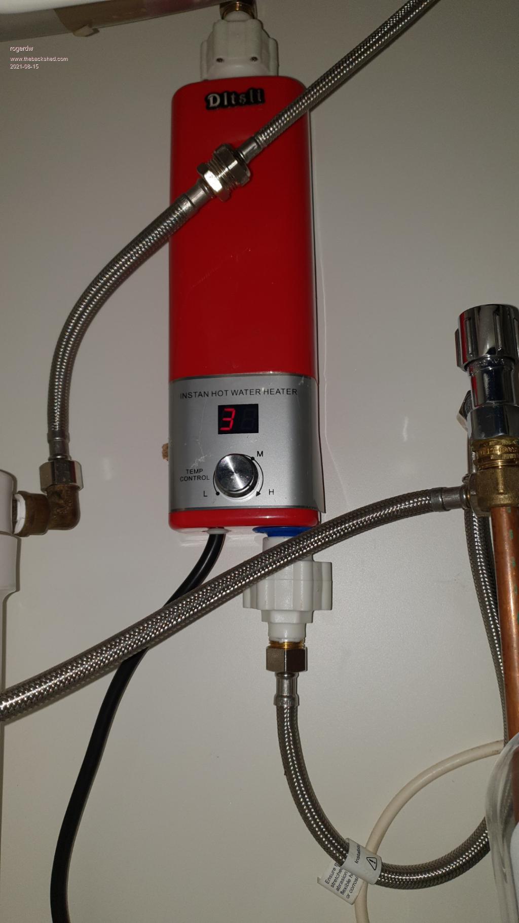

Good job danielkos  ...  always worth trying out an alternative if you get the chance.
I'm in the same boat as Dave, where the hot water in our kitchen takes a couple minutes to get to a reaonable temperature. So much for a modern home with an instantaneous gas HWS.
It is also painfully slow to deliver hot water in the bathrooms too  ...  but we've had to put up with that  ...  although being able to dial in a temperature on the control and not have to fiddle with the cold tap is very handy.
I got so sick of the situation in the kitchen that I bought a heater similar to yours and fitted it under the sink. It is dodgy in that you have to turn on the hot tap fast (I assume to trigger the thing to start heating)  ...  and then back off to a fairly slow rate so that it has time to get some heat in the water  ...  and it is sort of acceptable.
Certainly better that what we had before  ...  but still so inconsistant with the output temperature.
Sometimes, even with just a trickle it is barely luke warm  ...  and other times you can scald yourself. Mine has a knob on the front which I assumed was there to adjust the output  ...  but it really seems to do what it wants and pays no attention to where you set it.
I'd also like to put one in the ensuite  ...  but of course there are two basins in there  ...  so that'd mean two units  ...  and then the main vanity at the other bathroom has two basins and I just know I'd be expected to fit two there as well.
The one in the kitchen has been there maybe 3-4 years already  ...  and apart from the inconsistant output temperature has been very helpful.
It's amazing what we put up with really. Before we came here we were in a 70 y/o stone home with an old electric HWS. It took literally seconds to have hot water in either the kitchen or bathroom  ...  yet here we are with this nice posh joint and it's like we're living back in the 1920's.
Our house is on rainwater too  ...  so it goes against the grain to run the taps for 1-2 minutes everytime we want a bit of warm water.
I took half a dozen photos but the second digit still wouldn't show up  ...  it's supposed to show 34.
I had not thought of that. I assumed ( stupidly) that they would be like regular heaters and the blow off could be Piped to a drain. Even my outdoor heater had that when it could go to the ground with no trouble.
  Quote   that power draw would be quite a bit higher when the same system is run at 240V instead of 220V; maybe it would jump up nearer to 3500W.
Hmm, 240 is low here. Of course they blame it on solar but not a lot of that in the grid at midnight and 3am here when I have seen it at 250 and more than once.
I have a fan heater running now and the power meter on it tells me the voltage is still 232 with that running. Why am I not surprised?
  Quote   I'm also pretty sure my second one is producing more heat than the first one did, so they might not be sizing their heating elements too carefully in the factory anyway.
Yeah, that's the trouble, Chyneese quality is so hit and miss. I bought some of those  heaters like you put in a coffee cup last year for a project. Bought 3. 2 died in no time, the last one was fine even though I ran it half dry a couple of times and did other things I would have expected to make it fail.  Bought a couple of others and wasn't game to plug them in!  My god some of their standards even with mains power are atrocious.  Gave the seller a BIG serve, got a refund and reported them to fleabay and the electrical stds mob whom were a challenge to find and whom looked after that seller.   I would bet my house even though they were an Oz based seller they did absolute Jack about them.
  Quote   so parallel might work better.
Yes, 55 is plenty hot and if you got a decent flow rate at that, you wouldn't need anything else.
  Quote   When I turned up the flow rate too high I got 30 degrees coming out at the tap which barely felt warm to me, while adjusting it to give a rise to 40 degrees felt hot.
The shower in my first house was like that. I don't know what thread pitch the taps were but I think it was about 3" per turn! I tried replacing the washers and the shower head but to change the taps would require pulling the wall out then re tiling the whole bathroom to match and..... Ugh.
Made me want one of those fancy gad setups I have seen where you put in the exact temp you want and that's what you get.  That would be heaven!
  Quote   the low-flow showerhead does a good job with it though.
I replaced the shower head at my last place and it had a low flow restrictor in it.  I couldn't stand it. I was always cold through not enough water to the point I had it so hot I was burning myself... and still feeling cold.
I took the thing out and then it was fine. I think it must have been flowing about 1L / min. Was terrible!
The Big square one I put on here had the same thing which seemed Nuts.  Why have a huge shower head when the flow rate is not enough to go across all the holes?
Removed that then the flow of the hot water couldn't keep up which I traced back to the stupid straw diameter  pipe.  Did it properly in copper and no more worries.
I noticed the fact you insulated your Pipe. I'm amazed how many systems I see that don't have that or a useless green thin bit of plastic. having the pipe insulated can make a measurable difference to water temp.
Mine wasn't insulated when I came here. I got that thick foil backed foam they use in AC  and did mine including the Blow off valve which was always hot and leaching heat through over a meter of copper pipe.  Stupid! I replaced that with a short bit of plastic so the thing wasn't drawing heat all the time and radiating it to atmosphere.  Can undo a bit of the insulation I closed with Velcro over the valve to Burp the system if need be.

  rogerdw said  Good job danielkos  ...  always worth trying out an alternative if you get the chance.
Just use a 15mm BSP tee connector on the heater outlet and then hook up the hot water to both basin mixers from the same tee connector. Unless you're often planning to run both basins at the same time of course.
'Sort of acceptable' sounds about right, lol, also the luck of the draw (my second one senses the flow better than the first one did, and has a better temp rise despite coming out of the same factory).
But when I first hooked mine up with hoses rather than rigid pipes I think I noticed a bit of 'surge flow' when turning the water on anywhere in the house, due to the hoses being a bit elastic and getting the pressure released from the hose downstream from the heater before it started flowing from the heater itself. My theory was that the pressure in the hoses was producing a bit of "push-back" (how to describe this?) when I turned the tap on and this might have impeded the flow sensor from turning on. Seems like a bit of a black art.
It might be worth opening yours up to see if that knob is actually connected to anything or just a placebo? I can't imagine having an electrical thermostat on something as simple as a heating element.
Another possibility: maybe that temperature knob is really just a flow regulator designed to reduce the flow so that the water reaches a higher temp when it runs through??

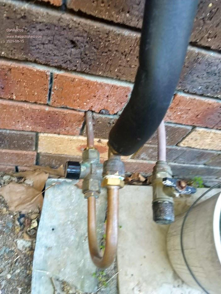

  Davo99 said
That's why I added a proper relief valve at the inlet, which is more like the type on a regular hot water tank (except an inline version, more cheaply made and from ebay), because the blow-off valve that comes fitted is the worst thing you can imagine. It's like they got a narrow plastic pipe end, plugged it with a rivet and slipped a loose sleeve over it. When it blows, it means the 'plug' has burst off, which pushes the sleeve out and gives you a visual indication that it's blown inside. And then that's it, it only spurts water everywhere from that point forth! It's a pressure relief valve that's good for one time only. The relief valve I added lets out a few drops of water at a lower pressure so hopefully will save that 'emergency' blow-off valve from ever blowing.
Part of what made me go this route was at the start when I was looking online for an installer to change over my hot water system to a regular replacement. The installer websites show you a big price tag or big phone number, have a stock picture of an attractive woman smiling at a male plumber like she's won the lottery, a promise that you can turn your brain off if you call this plumber and they'll make your troubles go away, and a picture of the finished product with NO INSULATION ON THE PIPES! So I wanted to find a quick-fix way to do it myself, not to save money, just out of sheer rage
I also found manufacturer pics of instant gas systems with thermal lagging on both the inlet and the outlet and I didn't understand at first why you'd want to insulate the cold supply line rather than just the hot. Turns out putting thermal lagging on the cold inlet is important too because these things only give a relative temp rise unlike a tank, so if your ambient cold supply is about 13 degrees (as mine usually is, it comes from underground of course) and it's only 5 degrees outside, that cold pipe is losing heat and reducing the final temp.
Like I have seen pics of Solar installers and Panel Cleaners STANDING on the panels.
I had a jibe at one installer on a forum who's advertising featured a couple of such pics as he was holding himself out to be a quality installer. When I pointed out the huge flaw in the pics He whom arced up and said it was only a stock Pic.  I said if he were stupid enough to use that pic to promote his company's services and couldn't take a better one on a real job, then they were just as slipshod as the Pic implied.
In reality I think they didn't see anything wro9ng with the pic and probably walked on the panels and I'm talking in the middle rather than on the frame edges because that's what they did in practice... like the Plumbers doing HWS.
  Quote   so if your ambient cold supply is about 13 degrees (as mine usually is, it comes from underground of course) and it's only 5 degrees outside, that cold pipe is losing heat and reducing the final temp.
Well you sure got me there!
That never occurred and here it's easy to get below zero.
That said, the pipe run into the heater from the valve is so short it would be hard to insulate and the area and volume it could loose heat is very limited.
The point is well taken though.
I actually thought of it from the heat radiating back out the tank but figured the losses would be minimal with the pipe so short.  Might have had something to do with the temps here and using that flexible braided runner hose.
