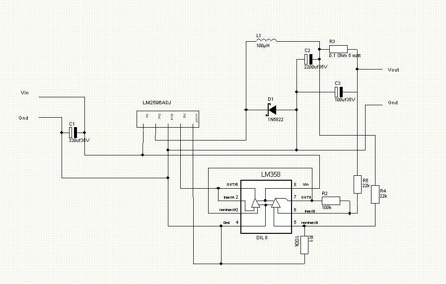

Hiya Guys,
Below is a schematic for a 3 amp constant current power supply for powering a stepper for cnc use. I've tested it on the cnc i'm making and using my nife bank as the power supply.
Input voltage 12.8 volts
Output voltage when the stepper is at rest 4.8 volts
The voltage ramps up as the stepper speed increases and using the above input voltage the running speed @ 8foot/minute was 11.8 volts.
Not many components and it does work perfect.
Have fun guys
Cheers Bryan

Nice work Bryan. A constant current source is a must have for fast reliable stepper operation.
I see the forum has resized the picture down a little to far. Its gone for the default 500pixels wide for JPG images. If you save the screen shot as a GIF file before uploading it, the forum will only resize down to 1000pixels wide, better for circuits and plans etc.

Interesting source. How you power the steppers? With or
without current limiting? 12V steppers?

Bryan
C1 is the wrong way round, what about for C2 and C3?

  woodchips said   Bryan
Bob
If you know electronics then you will know some schematic software will do things different. The concept of that schematic is to show a simple way to get a 3 amp CCS. To pick by the way a schematic is drawn is plain out there behind the out house and your in the sh*te pile before ya know it
To Vasi,
This CCS will only draw the current needed for the stepper and be limited to 3 amps so current limiting resistores aren''t needed.

Hey Bryan,
I am with U on this. Far better to present something. Those who know a bit will put the caps in the right way round anyway.
Gordon.

Bryan
Yes, I do know electronics, I was rather more concerned with the majority who don't, and want a correct, working circuit to follow.
I can also read data sheets, where the catch diode must have a current rating at least 1.3 times the output current, so the 3A 1N5822 isn't really up to it. Does it need the feedforward capacitor, if not then why not?
Someone without the detailed electronic knowledge, or suitable test equipment, could be in for a long session of headscratching.
When you only have limited experience you both need and want to know why? Why is this a good circuit? Why is it better than a variable three terminal regulator wired as a constant current source?
And Bryan, it takes no more time to do the job correctly than incorrectly, and those that don't know have an exploded capacitor in their face, rather on your consciences than mine.
