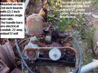

I'm putting a page together about portable chargers, you know, the good old car alternator bolted to a small petrol motor.
Mine is a 75Amp alternator bolted to a 5hp motor, mounted on a trolly. Its got me out of trouble a few times with flat car batteries.
In the article I talk about reversing the fan, adding a amp meter, and a few other small details.
What I would like help with is some photos of other builds. If you have a photo of your own portable charger, post you picture here and I'll add them to the page. I dont care how ugly or pretty it looks, its just to give others ideas on building their own.

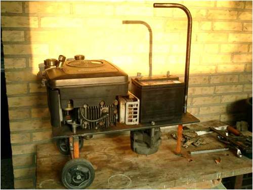

Only picture I have of it in its 'nearly-finished' state. This configuration was chosen to be able to run the alternator normally, with proper cooling (fan turning in the correct direction). Seemed the simplest solution to me to me to solve that problem this way. Wheels and a handlebar complete the portability.

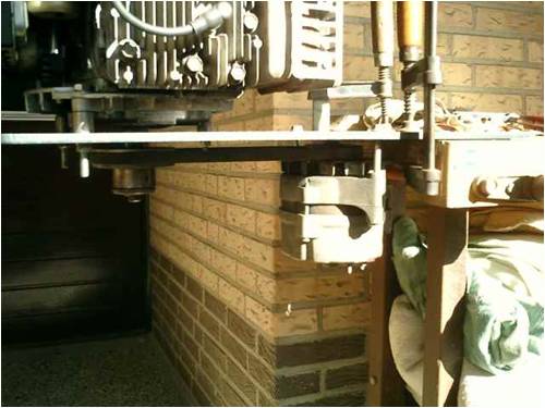

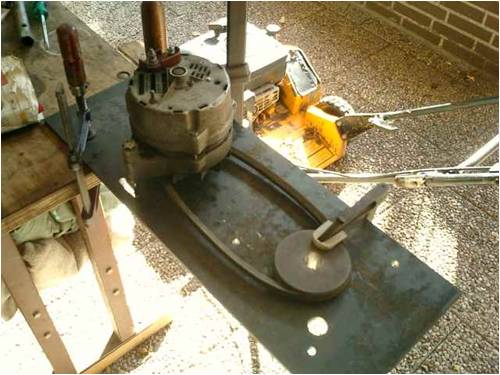

Images below shows test fitting the alternator and engine. There's a curved slot in the 8mm steel mounting plate to be able to tension the belt by varying place of the alternator.

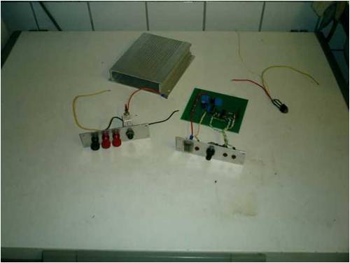

Used the mark-8 controller, as published in Homepower magazine. Useless controller. Didn't control properly and developed a lot of waste heat (in the transistor). Would use a few switched lightbulbs to control field if I were to do it again.
Next time I wouldn't bother to build such a genset anymore. Was a useless project for me and has been thrown away a few months ago in the most recent move. Was fun to build though and helped me out on one particular occasion with troubleshooting the instrument panel of a boat (they didn't install a diode in a crucial place in that panel. This stand-alone motor/alternator combo made troubleshooting that instrument panel a piece of cake. Much nicer to work at leisure at home in the workshop/patio than out in the field in a hot, humid and cramped engine room standing in bilge water).
But was noisy (engine running at ~3000 RPM). Ron was right - petrol engines suck, diesels rule. Alternator was a 55A Delco-Remy one, with internal electronics removed (apart from the rectifiers).
Now toying with the idea of taking a small car diesel motor and coupling it to one of the motor conversions. A few kW of 3-phase backup-power (230 Vac and 400 Vac) would be nice. Bit similar to what RossW has built. Of course one or two car alternators would be bolted on to it as well. Engine shouldn't even notice the extra load. But probably much easier/quicker/cheaper to buy a used diesel genset. Can't help but ponder a Lister/Petter/clone coupled to one of the conversions too. Quiet, slow and diesel.
Then again, those lawnmower engines and alternators are plentiful and can be found for free. What's wisdom....

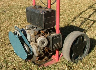

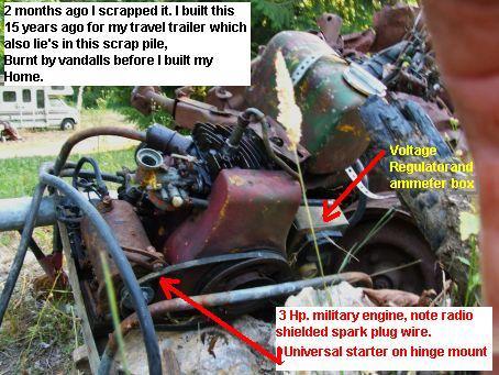

Posted: 06:33am 01 Aug 2009
Glen;
You mentioned Ugly. Might as well pin the blue ribbon on this.!!
Edited by Greenbelt 2009-08-02

Posted: 11:56am 04 Aug 2009
Good tip Robb, makes sense.
Thats a interesting photo Greenbelt, the starter is a good idea. Luckily my motor starts easily, first pull of the cord usually.
