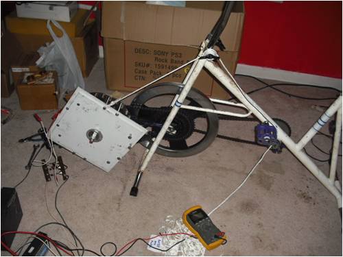

Hi Everyone,
This is my bike generator.

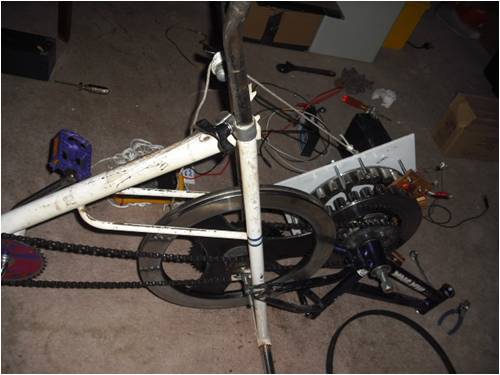

I used a flywheel from a different exercise bike and put it on this one. Then i took a small kids bike flipped it upside down and attached it to the stationary bike where the flywheel attaches.
Then i took two ball bearings and a threaded shaft and attached a axial flux PMG to the kids bike where the pedals used to go. I got real lucky because i didn't need a lathe or any special tools to complete the bike generator, i did have to file the shaft to fit the ID of the bearings .
Oh yeah, the alternator is made from a motorcycle front wheel hub , with two brake rotors holding 0.875 inch DIA Neo's by 1 inch long . There are 24 neo's per rotor ,and when it is finished ,will hold 18 coils.
I just reassembled it last night.I forgot how cool it was to be able to charge a battery just by pedaling, i have seven test coils on there at the moment , i had 9 on there but two were rubbing so i took them off.
One note i could add about the flywheel , before i added the PMG the flywheel will spin by itself for about 15 minutes on momentum alone when pedaled fast and let go. Another thing i got lucky about was the flywheel has a ratcheting thingy in the hub , what i mean is that you can stop pedaling at any time and the flywheel and alternator will continue on its way.

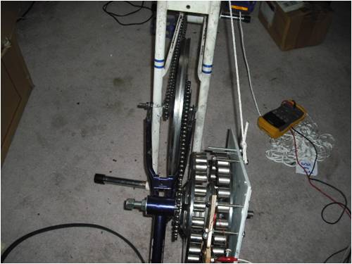

Hi Bryan
Yes i will do that. Thought y'all might like a different view.
Below is the other side
This shows both chains and sprockets and how it all attaches together.

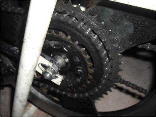

This is a close up of the right sprocket , where it attaches to the flywheel.

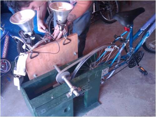

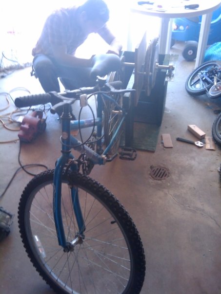

Posted: 05:30pm 15 Nov 2009
I like it! My brother and I did the same thing and presented it at earth day at a local school. We used a belt and a tension-er and attached it to the wheel to make use of the gears and freewheel easily. We had little slip after we put the tension-er on. I like your design seems much more solid and more practical for at home use. have you gotten any test marks yet?
